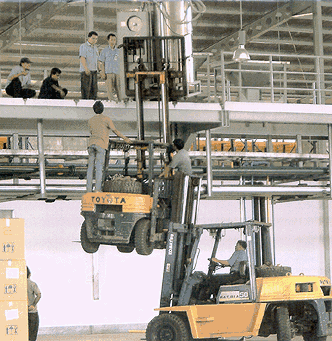

   / Using bucket as work platform. #2
A big difference between the FEL and things like scissor lifts, boom buckets, etc., is that they have a flat surface for good footing, they have high sides so it is difficult to fall out, and they don't have things that you can easily get caught in or on. The bottom lip on most tractor buckets I've seen also does not extend very far in front of the top, so there is no real safe area to stand on when the bucket is level.

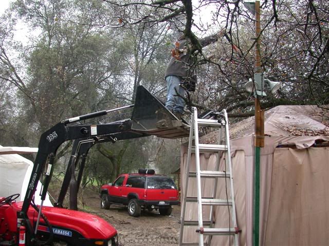

N80,
I'm guilty of it too. I sure don't recommend using the bucket as a platform but sometimes you gotta do what you gotta do. I used it recently to cut a branch threatening to crush one of my canopies. I used the ladder to get into the bucket and then work on the tree limb. I was able to move the bucket over the canopy to get a better shot at the limb, where I couldn't reach it with the ladder. Unfortunately, it was pouring rain ... very slippery and dangerous.
Here's a shot when I started.
