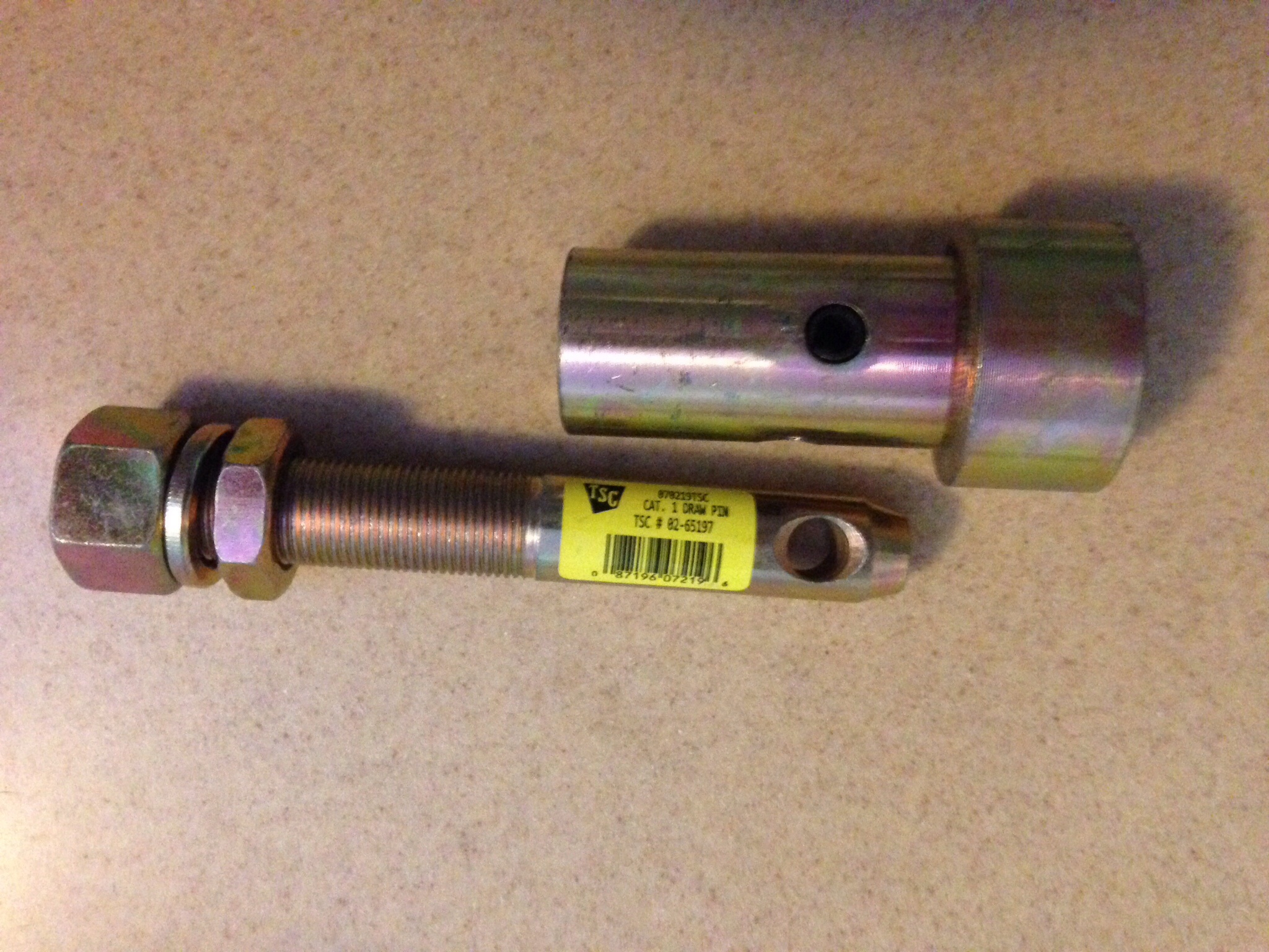

I have a Cat 2 QH and converted several implements to fit by getting extended Cat 1 pins and the Cat 1 to Cat 3 QH bushings. You need to use the bushing with raised end or the implement WILL fall off. Things like a spreader work out fine but I would imagine you could tear up a too light box blade on your bigger tractor. Be safe! Here is what I used:

I thought about that. What about the increased distance from the top hook of the quick hitch versus the top pin of the implement. Are the distances different or is the only difference the distance between the bottom pins?
   / Using Category 1 and 2 Equipment With the Same Quick Hitch #9
Only difference is the width of the bottom pins. I have several implements, such as a rake and box blade that are both cat 1 & 2 QH compatible.
