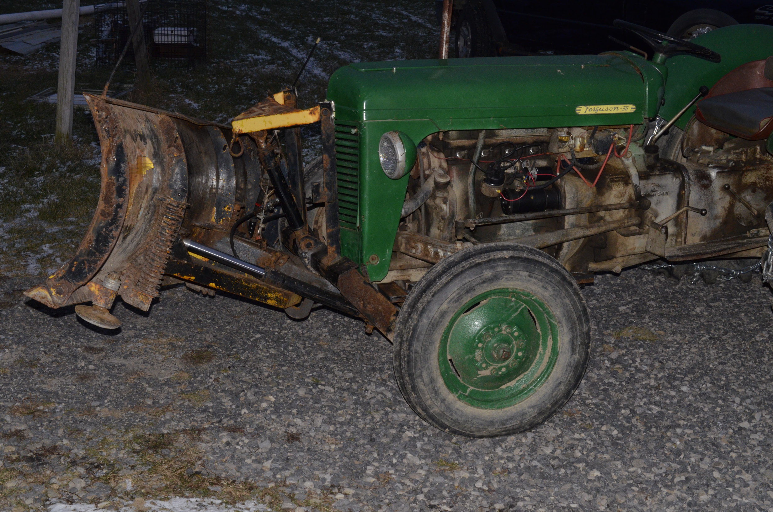

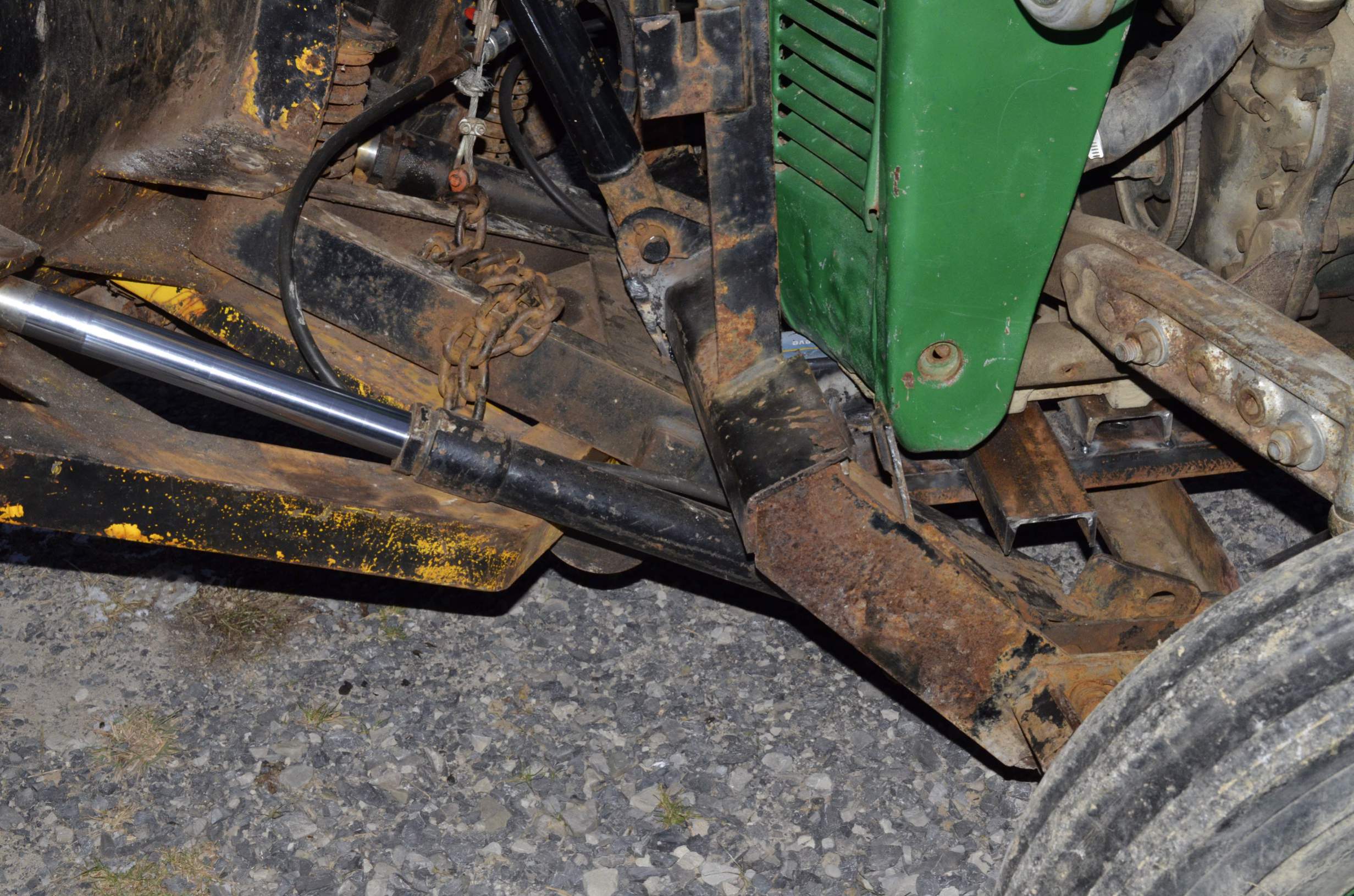

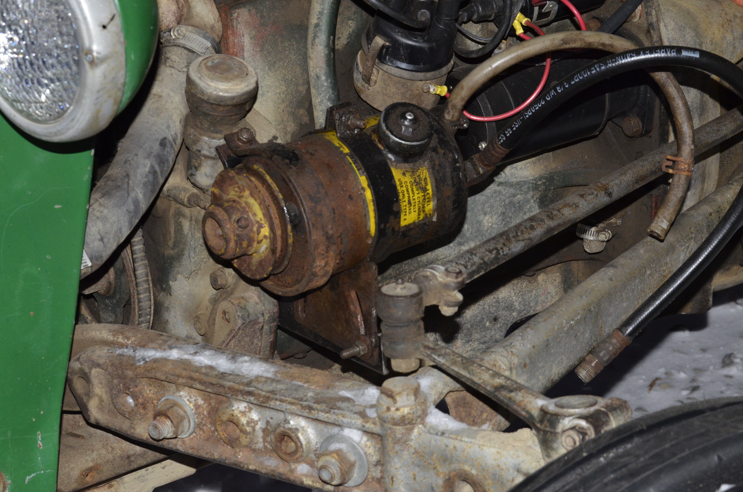

I went through the same thought process with my old Furguson then decided to mount the fisher pump to the tractor engine thereby eliminating all risk (water from old plow cylinders) to my existing hydraulics.
Also I tried mounting the plow to a front end loader trick but the torque of the plow way out front limited the side force the tractor was able to exert. The closer to the front wheels you are able to get the plow the better.
