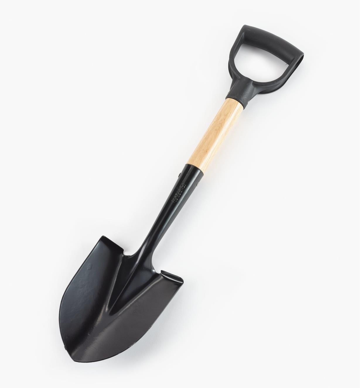

For the life of me, I have never been able to load the bucket from a pile of gravel, sand or manure pile. The other day I had a project done and one of the workers used my tractor (JD 870) to move some sand from my sand pile. He got the bucket full and the pile had a smooth "cut" into it, not all pushed around. What is the secret? I noticed at one point, he jiggled the lever, maybe that was to shake it back in the bucket.
Your problem is youmissed a step in your training. You need to start with one of these for a few years
