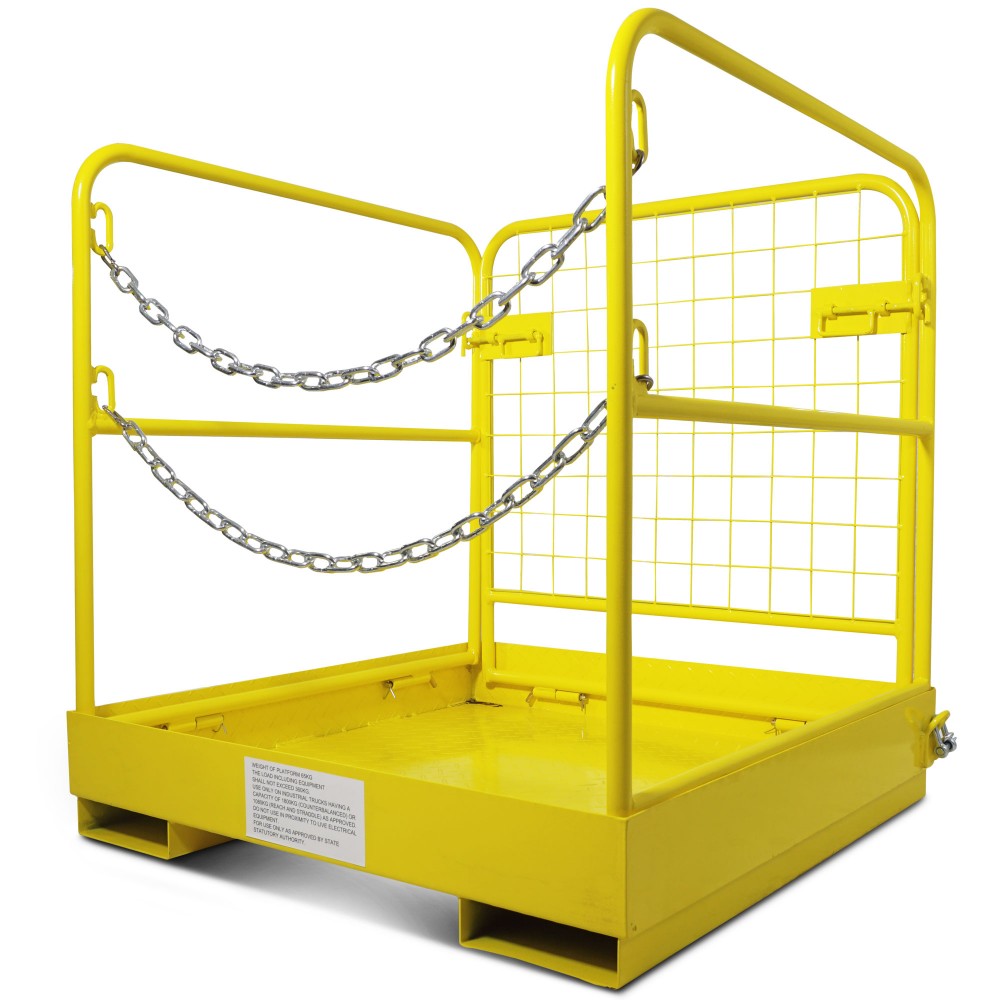

Here you go. You just need to have forks for your tractor. If you have a skid steer quick attach it's a piece of cake.
Forklift Safety Cage Work Platform Collapsible Lift Basket Aerial Rails 36"x36"
