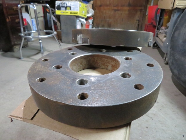

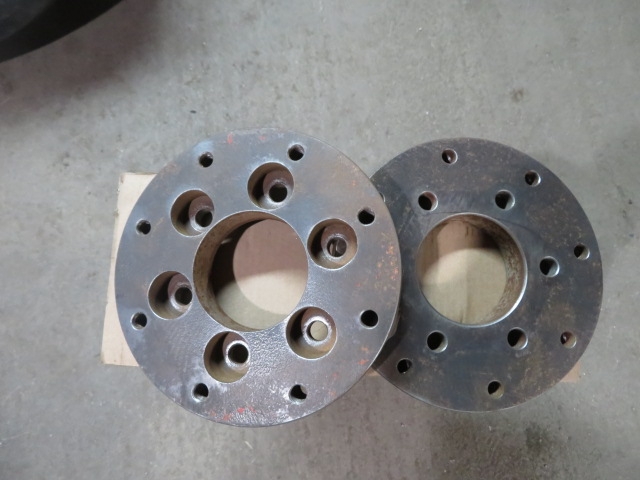

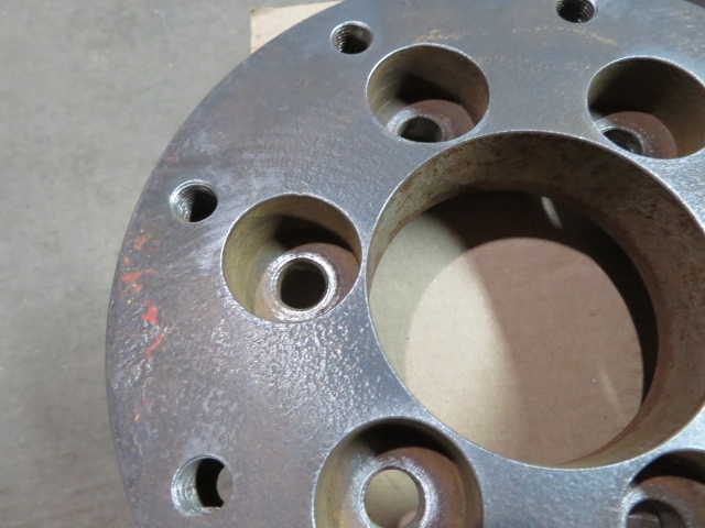

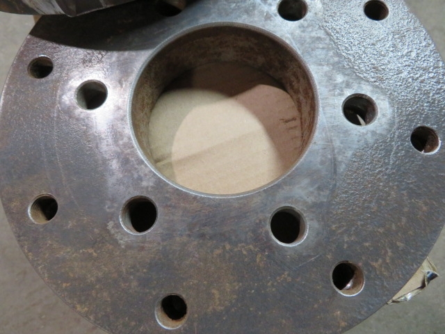

I do not know your location or what size tire/wheel you need. I have a set of Custom made steel adapters that bolted to the 6 bolt hubs of my Yanmar YM2000 ( thats who made your 750 ). Any standard AG Wheels with an 8 bolts on 8" circle will bolt to. They could be
1-piece wheels or the 2-piece style ( steel plate center and bare rim with 6 mounting loops. I had moved up to 11.2 x28 R1's from the 10-24 Rice Tires.

Pictures added to my previous post
