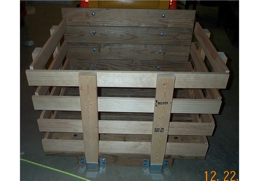

   / Utility Storage Box replacing Ballast Box #3
LGinIA... Here is a picture of one that I built. I bought the frame from TSC for $74. I made the bottom and back out of 2X6s and a 2X10. Sides and front are white pine slats on regular 2X4 posts. The 2X4s are held in place by stake pockets purchased at TSC.
It took one afternoon to build.
John

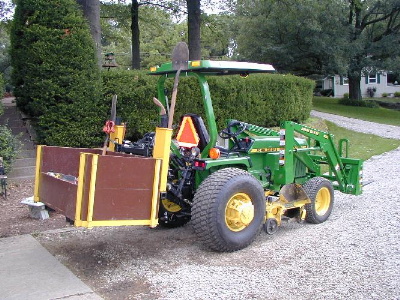

   / Utility Storage Box replacing Ballast Box #4
This is the utility box I made. It slips over the pallet forks attached on the 3 point hitch and also fits the pallet forks on my loader. Sides, front, and rear are removable. Couldn't get along without it. I only remove it when mowing.
JackIL

   / Utility Storage Box replacing Ballast Box #6
Jack,
I like your utility box also. Any more picture's or descriptions?
   / Utility Storage Box replacing Ballast Box #7
Thats a great piece of rig you got there.... That gave me Ideas....Thanks!! /forums/images/graemlins/tongue.gif
