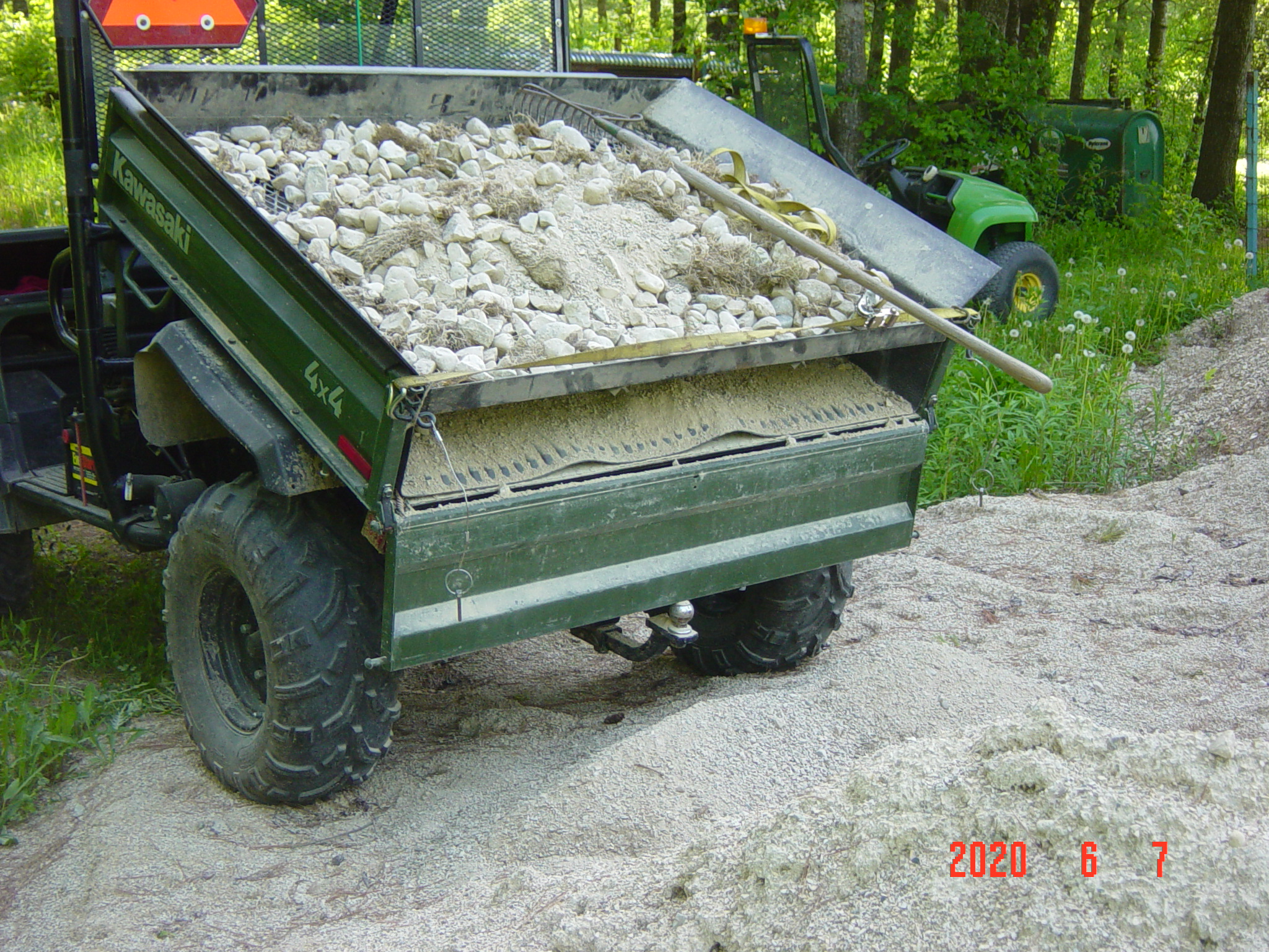

I was reading about people making little screens and thought I might share this.

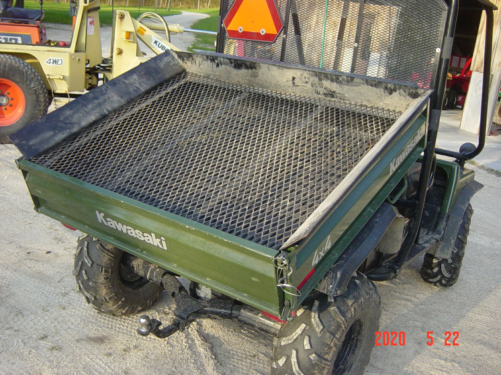

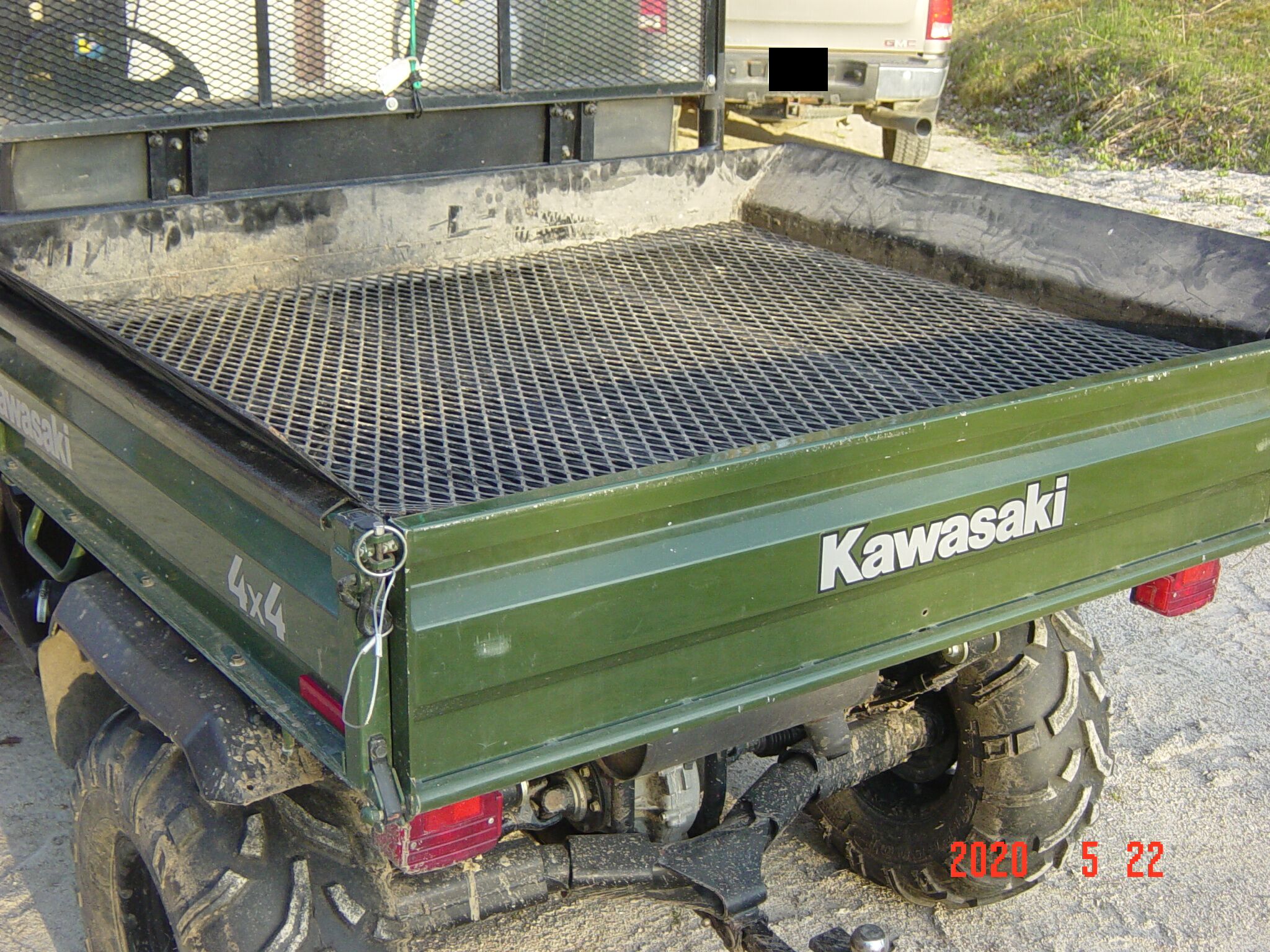

Good for making a little screened soil. Shown Here on my MULE 2510. Built mostly out of angle iron, some bent flat material for the top and expanded mesh.
Handy because it's mobile. Pick stuff up in one place, dump the debris in one spot and the fine material in another. Also, really handy if your bed is powered.
I haven't used it much. For one thing, it's easier if two people put it in place.
If I had to do it again, I might make the screen higher to clear the tailgate when closed.

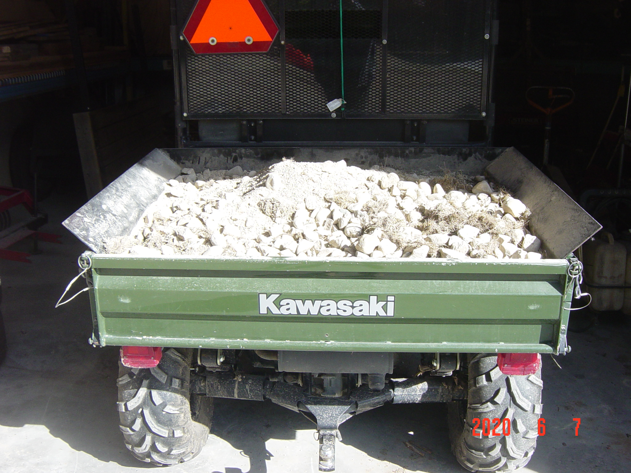

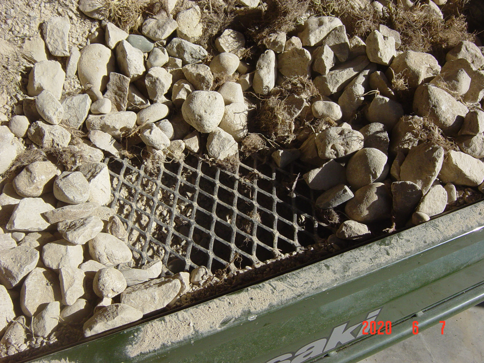

Used this to screen some 2" rocks that I once had put as a base in my driveway and the Harley Rake always rips them uip.
As I suspected, the OEM lift would not lift it. I had to help it along with arm power.
Strap is to keep bed sides from spreading out. I need to get a couple of square tubes to go in the stakepockets held together by a threaded rod.
Mickeymouse? Maybe. Kind of fun to play with though. Like a kid in the sandbox.
