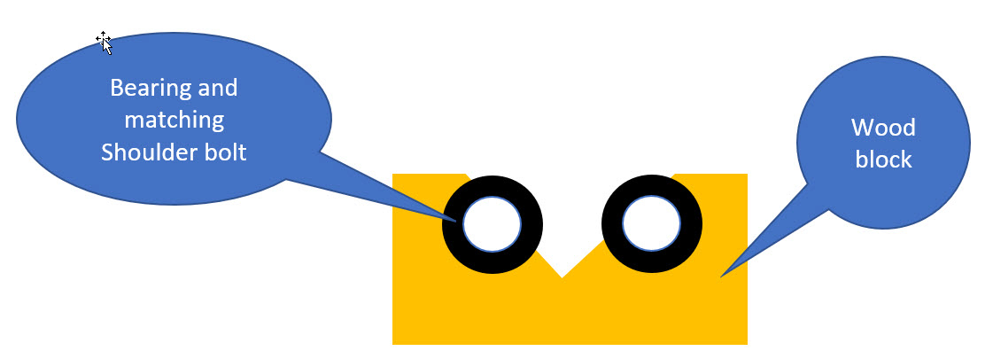

Just ignore me if you have this all thought out but without knowing more, I would ask how you will keep the V blocks and indicator in place while you hold and spin the pins. Your indicator tip doesn't have to be dead center but you will a false reading if it is moving. Same for the V blocks.
Honestly, if I were going to do this, I would make 2 V blocks out of wood and add 2 roller bearings on each one with a shoulder bolt to keep them in place.
Then screw the V blocks to a piece of 2 x 6 piece of wood however long you like. Now everything is clamped or screwed to a table and you have both hands free to spin the pin. Amazon has crazy cheap bearings and I think this would be cheaper and easier to use. Just my 2 cents. Good luck
