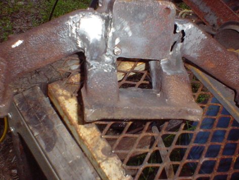

Anyone have a gooe source for older parts? I need a exhaust manifold for 1950 Case VAC. Thanks in advance.
   / VAC parts #2
I was gonna say ytmag but saw that you've been there and done that. Good luck.
   / VAC parts
Ken, You mite find it here parts
I bought 1/2 lb Amtec 3 cast iron rods $25 to see if I could repair this 55 yr old manifold.

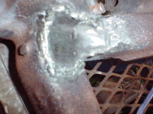

Here's the results.

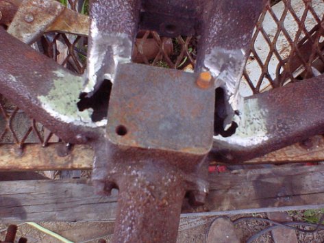

If this only holds up. another angle.

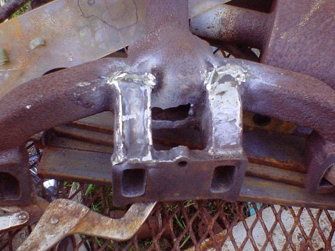

Here's two repairs on the other side. Now I only have two more holes to do.

What a difference, no holes and a 12' glasspack. It's quite!!!!
