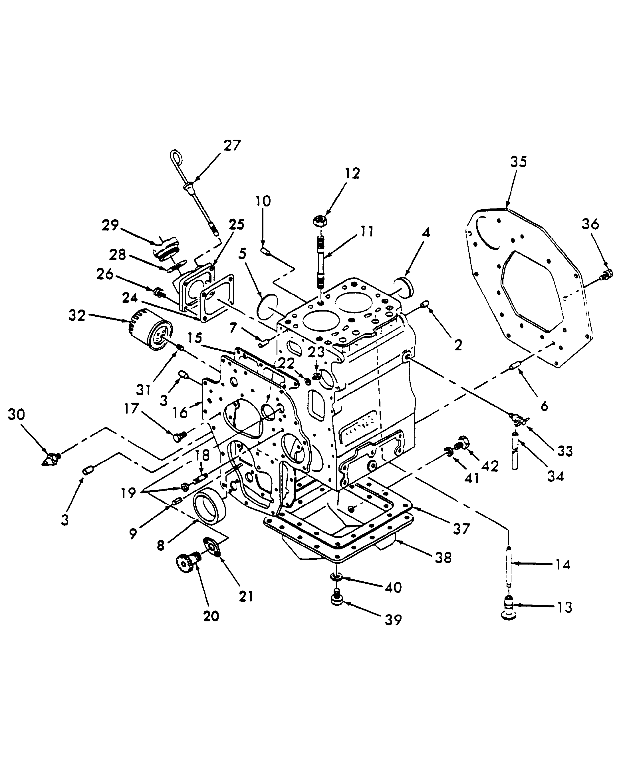

where is a good parts diagram for the ford F 1900 engine, I need to replace the valve gasket. Where do you recommend getting parts online? Thanks !

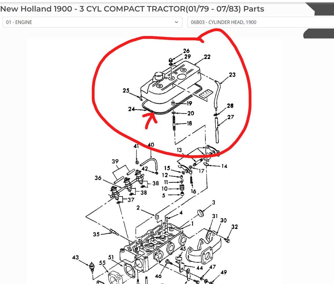

No how to as it is apparent when valve cover is removed...it is just a large oring in a groove in the cover

Head gasket vs valve cover 0ring/gasket are two entirely different things. Need to identify your needs in more details.

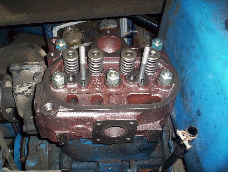

Replacing gasket if that leaks is very easy, You take nut #26 off and it comes right off. Might need to use a rubber mallet as enforcement tool. Breather tube # 23 need to be taken out too. now if the gasket was the head gasket (between block and the head) that would be completely different and much more involved undertaking. I have taken the valve cover on my 1700 just to check valve leash adjustment and it is really easy job and no special tool is needed.
Below is the picture of one the guys here that replaced the head gasket for his rig. Obviously valve cover goes over the head being the much easier job.

Your terminology was correct and the illustration was not necessary. While you are there though, you should adjust the valves. I don't have the clearances off hand, but maybe JC would volunteer those as it looks like he has them handy

why is gasket #25 175$ and the larger gasket is $34?
   / valve gasket for F 1900 #17
Because the part is not used on many models and this tractor is old. But #25 can be had aftermarket:

its not a complete circle. This may be a stupid question but, could I just get the same 30$ gasket and cut it to lenth?
   / valve gasket for F 1900 #19
What’s not a complete circle?
#20
there are two gaskets. one is a circle around and the other isnt
