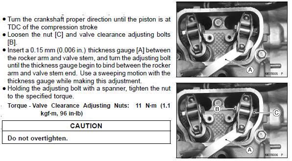

Does anyone have the procedure or knowledge on how to properly adjust the valve lash on a X540 John Deere? Im approaching the 200 hour service interval and would like to do it myself if possible. What tools will I need and procedure should I follow? The local sevice shop wants $200 for performing the tranny flush and valve service. I have no problem doing the tranny filter and flush but don't know what's involved with the valve lash adjustment. I assume i need a shim gage set, and a procedure for getting the crank in certain orientation depending on what valve is being adjusted. Im very mechanically inclined but have never performed this particular service. Thanks in advance for any help anyone can provide.

Your engine should be the Kawasaki FD731V type 26 HP Water cooled?
If so remove the valve covers and get a feeler gauge set - I like the stepped ones - they are $4-7 at any auto parts place.
This is not a hard adjustment, and I always check the clearance before loosening anything and the suggested clearances are .006" and if they are for example .007" I would not adjust unless you want to do it.
Here is a diagram below.

Carl_NH you da man! Thank you very much for the info. This seems pretty easy, and for the cost of a few valve cover gaskets I can be done! Also thanks for the diagram, pictures always help!

Remember, The piston has to be at TDC during the COMPRESSION stroke. If you adjust the valves during TDC overlap, (The exhaust valve is closing, and the intake is opening) the clearance will be way too loose after you adjust the valves. This can be easily observed while turning the engine slowly. At TDC overlap, both valves will be slightly open. At TDC compression, both valves will be closed with some play between the rockers and the valves. An easy way to be sure that you are on the correct stroke: Put your finger over the plug hole (to seal it) while turning the engine. If you feel pressure as the piston rises, You are on the compression stroke.
