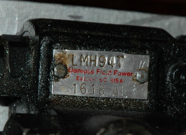

   / Valve question
kenyd,
The nameplate says 1618-AL. I've posted a picture of the nameplate. If I should look somewhere else for a part number let me know. There is also a number 4057 on the valve. Also options A and L refer to a detent positions. But as far as I can tell, there are none.
On pages 7 and 8 various features are listed for different valves. The 1618 can be configured with either the work ports open or closed to the tank. Since Option O is for open, I would think the default is closed. Since Option O is not listed in the nameplate the work ports should be closed be closed to the tank. Am I wrong?
To reiterate, when the valve is in neutral, the rod can either be extended or compressed but not both depending on how the hoses are connected to the work ports. For instance, if the rod is extended under load it can't be compressed past the original starting point. So it appears as if only one work port is open in the neutral position. I would assume that when the technical information says "work ports open to tank in neutral position" that refers to both ports. So I'm confused on that point.
One additional piece of information. I bought this used and it was connected to cylinder which was connected to the blade. When I was taking off the connectors a flow restrictor fell out of one on the ports on the end. (see related posts "what's this") At the time I didn't know what it was. I can't remember if it was in the work, in, or out port. I did not put it back in. Would that have any bearing on this problem?

   / Valve question #6
When I was taking off the connectors a flow restrictor fell out of one on the ports on the end. Would that have any bearing on this problem?
It would not stop your free movement, but it would slow it down substantially. I saw the pics and saw that others had already identified it. It still seems to me that this valve is behaving like a motor valve. But I will let Kenny, who is a lot more experienced than I in these matters, to make a diagnosis.

   / Valve question #7
What did this valve come off of? I ask because I think this may be a custom valve OEM'ed for someone else...If you look at page 61 of the catalog, you will see how to "build" the part numbers-and I cannot figure yours out at all.
It should read something like this:
1618-TS-305HS1 for a 4way, 3pos, spring-centered, standard ball relief, standard handle, 9/16 port size.
One other option I can think of is that the relief on the valve is set very low, and it's tripping due to the weight of the blade-but that is just a "guess" and can only be confirmed with a pressure gauge test.

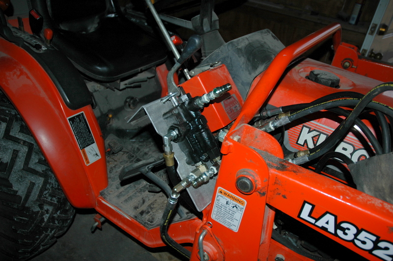

   / Valve question
#9
I'm not sure what it came off. The person I bought it from did not know because he bought it at a public auction from a local school district. I'm pretty sure it came off a piece of Kubota equipment. I'd guess a Kubota mower. It came with a kubota 2019 blade, cylinder, and mounting hardware. When I bought it I was ignorant and thought it had all the mounting equipment to mount to my B2400. Alas, it did not, so it sat in my barn for years. One day I was browsing tractorbynet and I saw how someone mounted a blade to their FEL and was inspired. I'll attach some pictures. Maybe someone will recognize it.
Your thoughts about the relief valve being set too low had crossed my mine but I didn't know how to check it or even adjust it. I'll think about it and maybe look into it some more.
As for the money I saved: The dealer said a new blade alone was $750 plus mounting hardware of $1100. I paid $350 for the blade, cylinder, valve, and mounting hardware plus another $300 or so, to get where I am today. If I end up buying a new valve I will get a 3 spool model costing about $300. That puts me about $800 ahead plus I'll have two spools to add more toys to my tractor. It's not only the money. I've learned a heck of a lot by doing this project. I learned about valves, cylinders, hydraulics, snow plows, and welding. I suppose I could have plopped down the two grand and gone around blissfully ignorant. What fun is that? Or I could just hire someone to do everything I do with my tractor. Again what fun is that?
Finally I think I've figured out how to use the valve in it present configuration. I'll use it to control the pitch of the loader and use a loader spool to control the angle. Because the valve allows movement in one direction under load the configuration will not allow a downward change in the pitch and limited upward movement. Almost like a quasi float. Am I wrong?

   / Valve question #10
Tom, I did not mean to sound like a ButtHead, I have been in your shoes to many times to count!
You did get a good deal on the package, but that valve is just a mystery...and without knowing how the valve is equipped this may be a futile effort. I would have done everything you have done already, including buying the PB sleeve...but you may just want to get a new valve to save your sanity.
