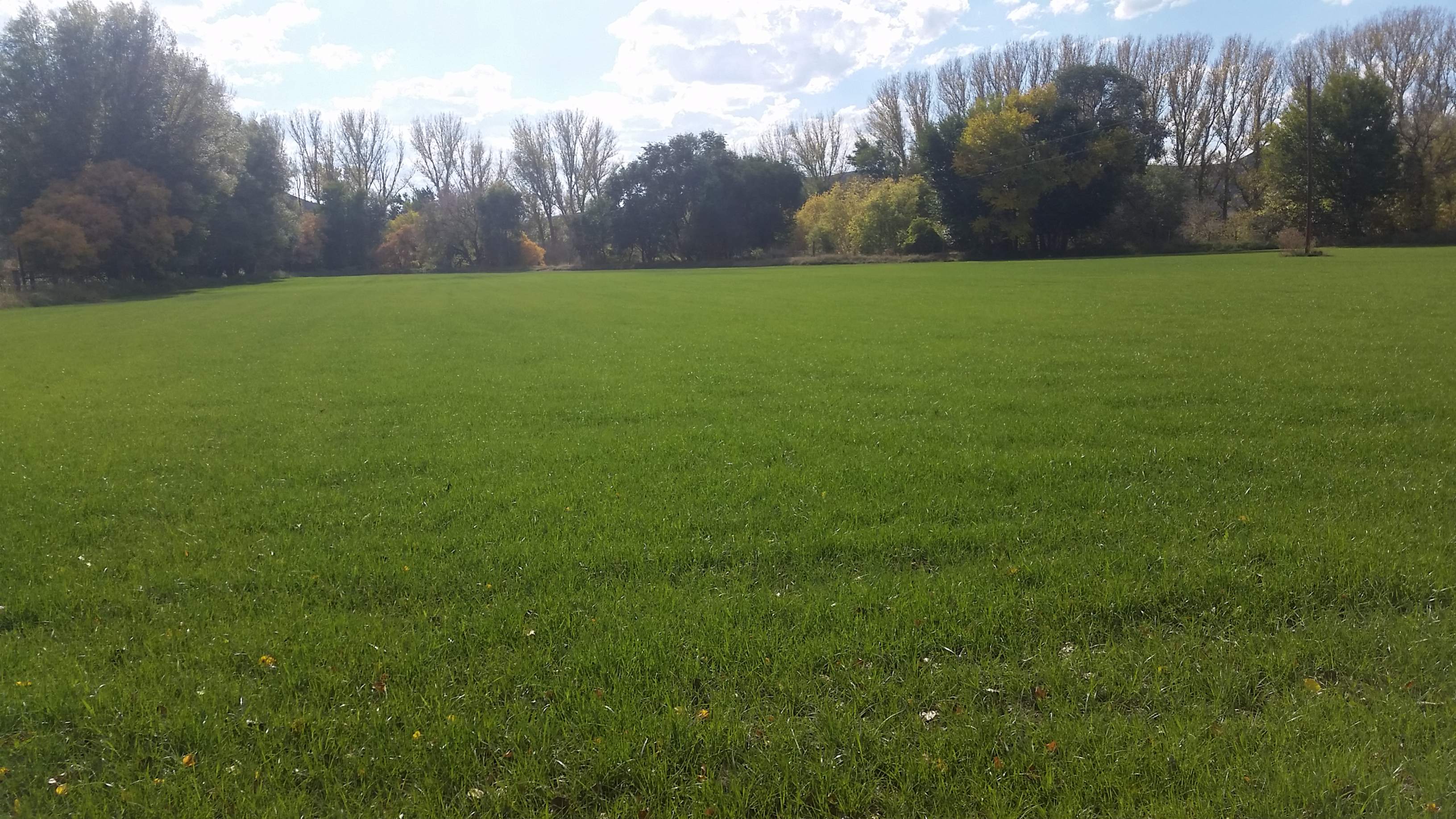

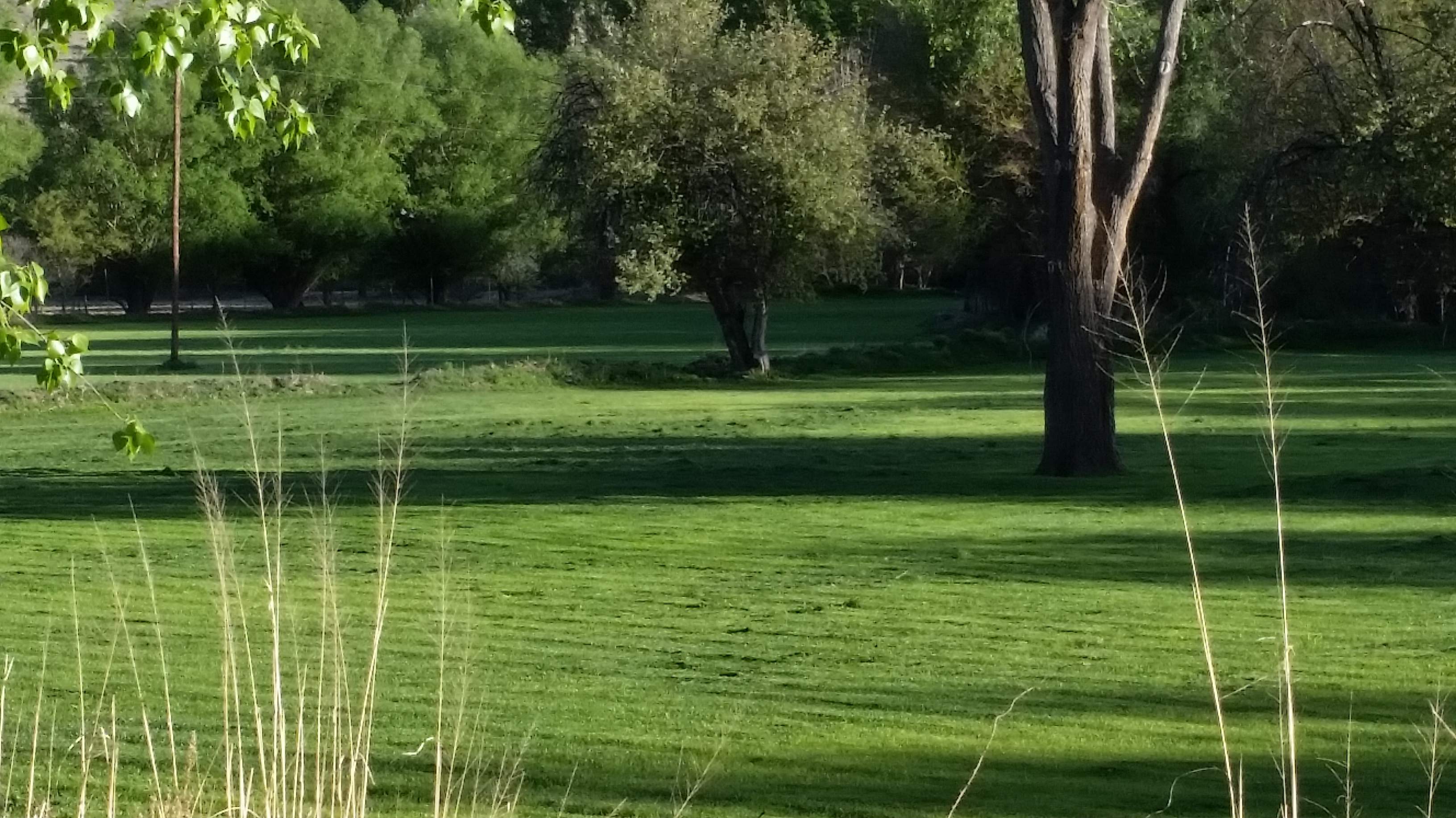

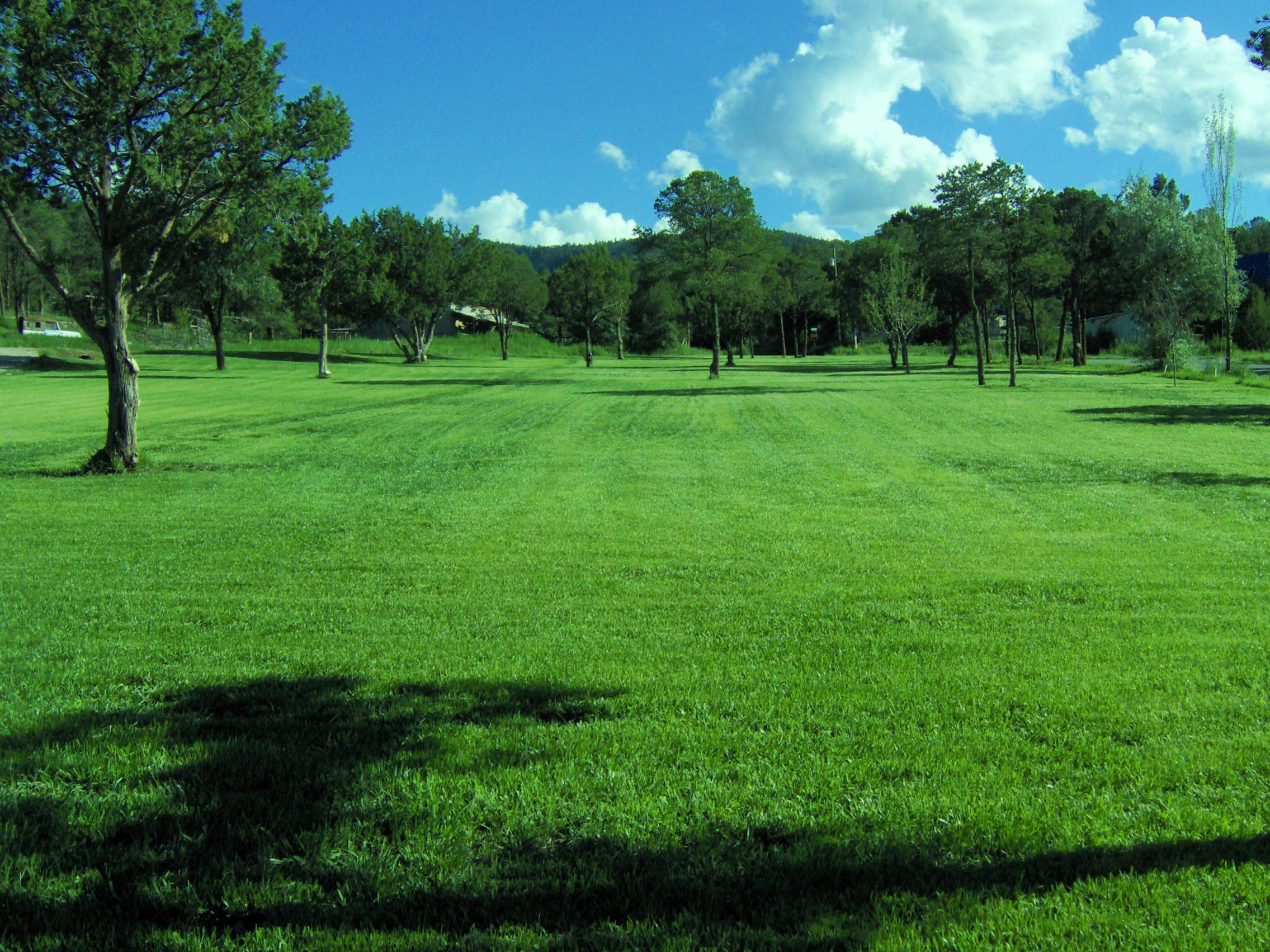

The Brillion seeder is a great tool but there are other ways to do this too.
What I have done is till the entire area in one direction then wait a week. Then till again perpendicular to the first pass. If any smoothing is needed I use a land plane grader scraper to flatten out any bumps then use a spiked tooth harrow for the next pass. I will then broadcast the seed for the lawn at a very high rate (200 lbs.+/acre) and use either the spiked tooth harrow or pine straw rake to cover seed. Last pass is with a water filled roller to insure good seed to soil contact. I also use Scotts or Pennington starter fertilizer and broadcast it right after seeding and before covering the seeds.
This should be a good time to start this project, till up the area in the next week or so for the first pass. I prefer to plant about the first of September for best results if you have rain for germination. Most weed seeds won't germinate this late in the year but the grass will. Two months later I would apply a root stimulator fertilizer and with enough moisture you should grow roots all winter long even if the grass browns out. By early spring next year the grass roots will have long and thick roots that will block out most of the weeds. Keep up with the proper amendments with soil samples and allow the grass to grow tall enough to grow strong roots. I find that with Fescue that allowing it to grow to about 6 or 7 inch height and mowing at 4 inches works well.
Here is a picture of my lawn and a few customer pastures using the above method.

Thanks for the additional suggestions. Jenkinsph - wow looks great! Those photos are inspiring. What part of the country?
   / Vast lawn with wire grass - spray and slit seed vs. ??? #9
Thanks. HONDO VALLEY. NEW MEXICO
