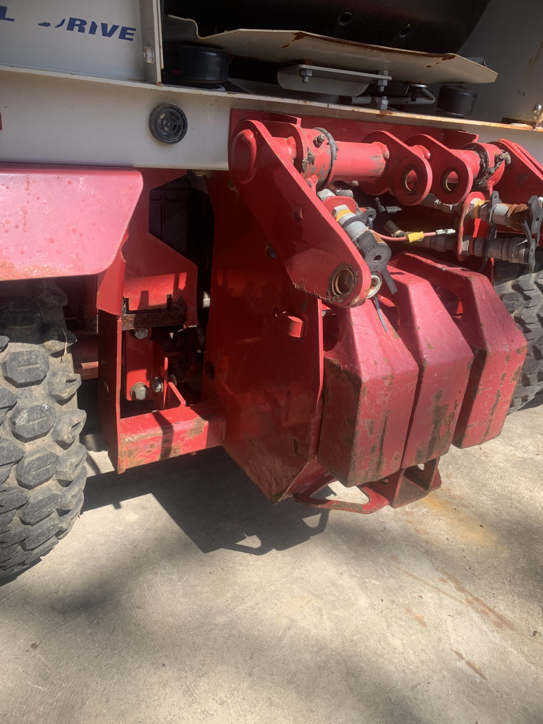

Hello to one and all,
I recently purchased a Ventrac 4231. I want to get the 3 point hitch working, however the dealer could not find the parts. Does anyone know if there are parts from other tractor manufacturers that are compatible or can I get universal 3 point hitch parts from my local farm store?
If the farm store route is possible what sizes of the parts should I get?
Let me know when you can.
Thanks and Regards

I'm a little confused, was this unit built with the 3 point but some of the parts are missing now or it never had a 3 point hitch and you are trying to install one now?
If the unit never had a 3 point hitch, it will be challenging to install even with the genuine Ventrac parts.
But if you just need a top link or draw bar, then the farm store should be fine.

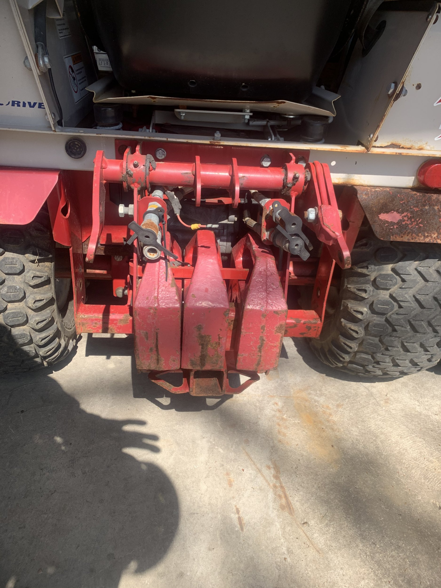

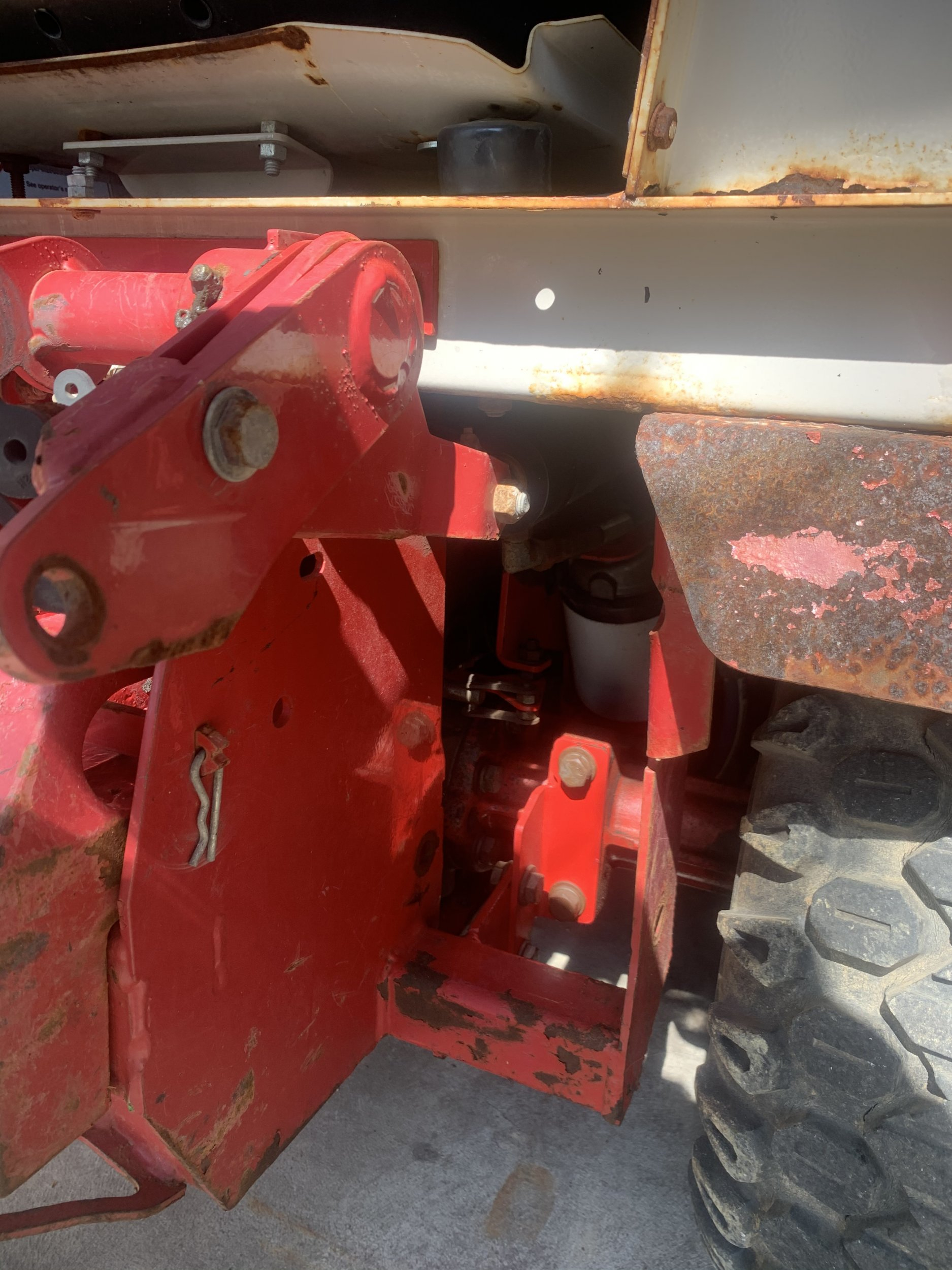

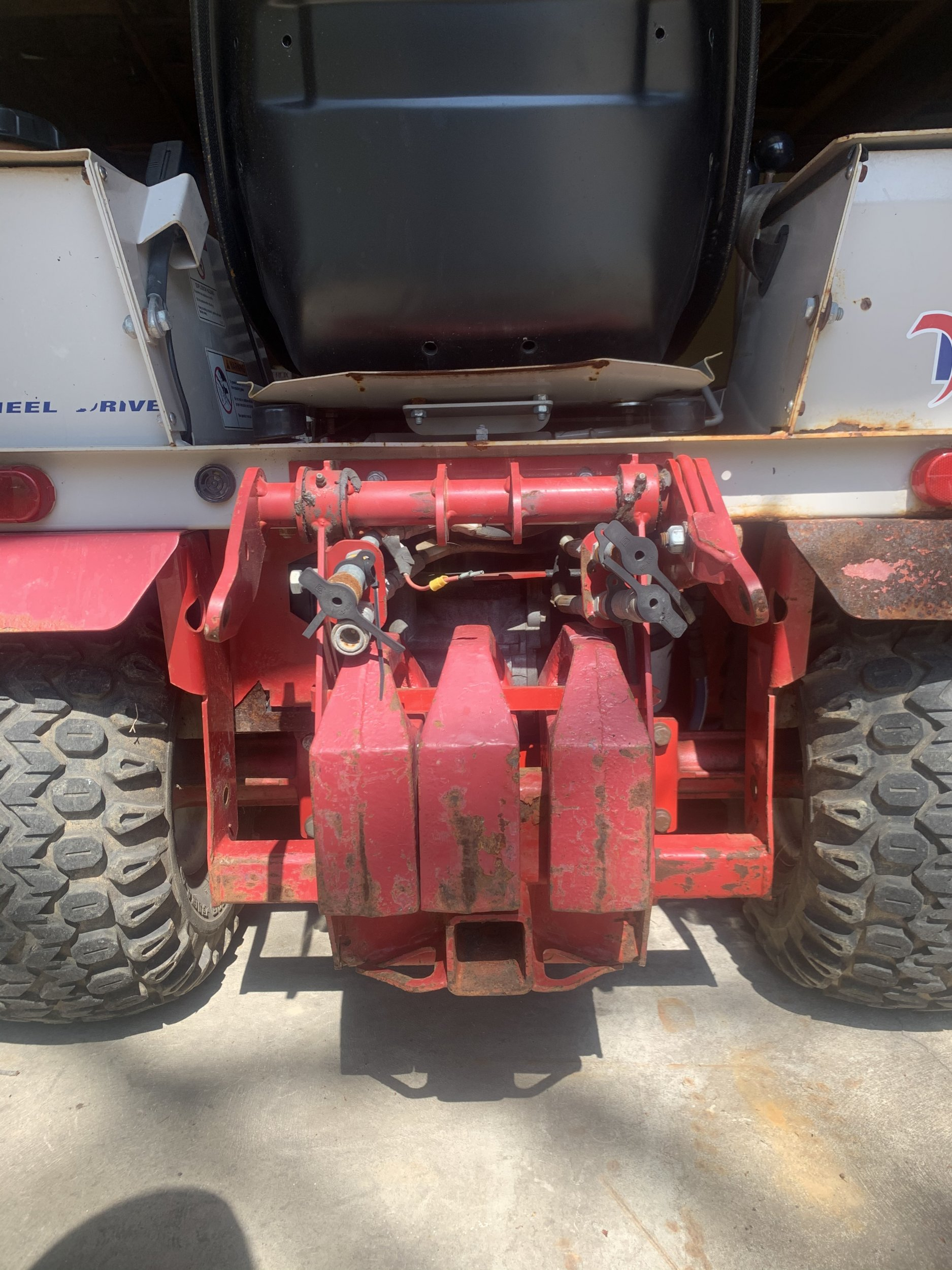

Thanks for your prompt reply. The 3-point hitch mechanism is there just the parts are not. I will try and send pictures.
Regards.

Your pictures help!
I have the 4500p but it looks like they are very similar.

Hello Guys,
Thank you for your replies so far.
Do you think the 3 point hitch kit for a JD1020 series or Kubota B series would work?
   / Ventrac 3 Point Hitch Parts #7

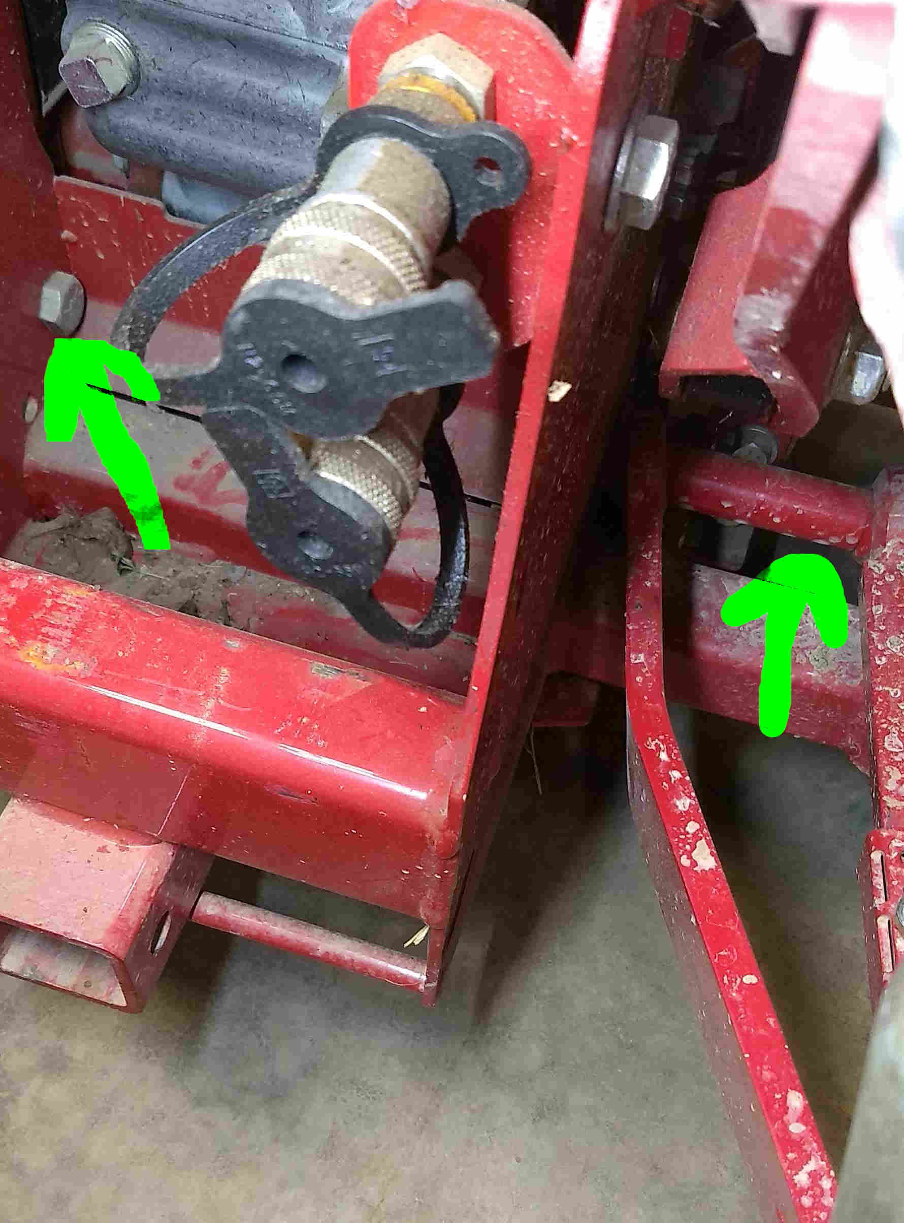

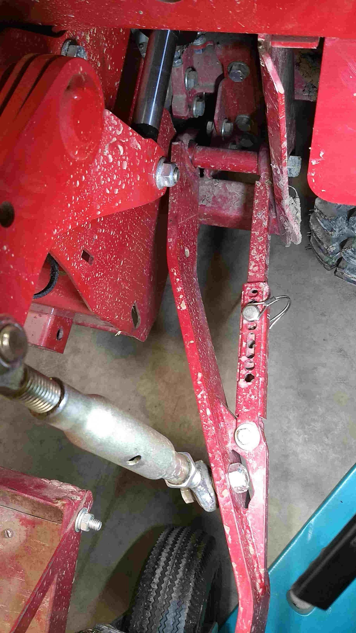

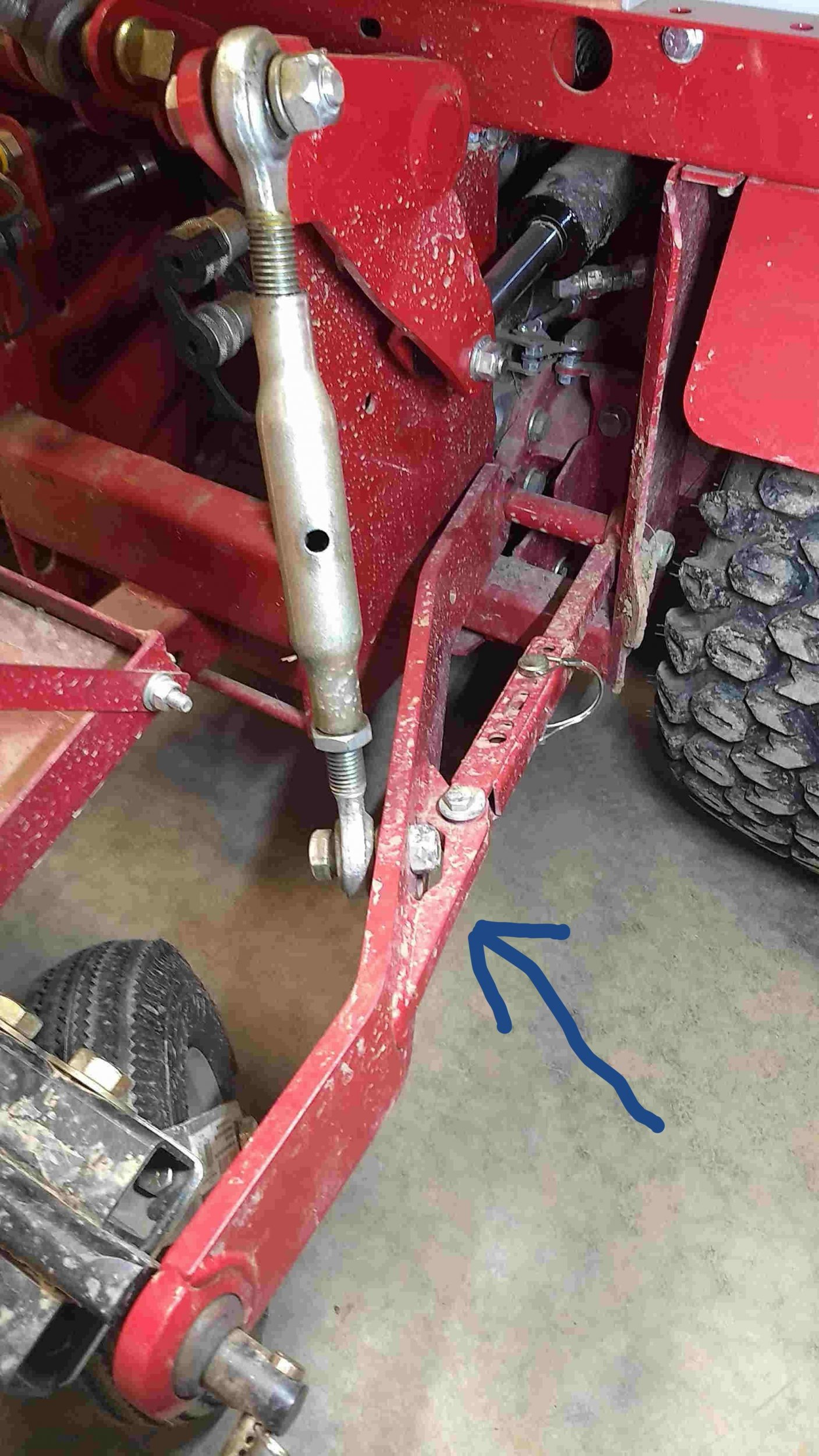

I looked on Amazon to see these parts and as they ship - no I don't think they will fit.
Can you make them fit - I don't know. Seems like you would definitely additional hardware.
I see a couple problems and there may be more but this is what I see:
In the picture I've attached, you can see how the Ventrac lower arm stabilizer attaches directly to the bolt that holds the lower arm to the tractor. The Kubota B series connects to a different place - a plate is pinned to this bolt. It is also on the inside of the arms and the Ventrac is on the outside. I think the stabilizers are a different hole size as well.
On the Ventrac, two bolts hold on the two lower arms and the Kubota just has one pin.
I don't see any specs on the length of the arms either.
Have you tried calling your Ventrac rep to see if you can purchase these missing pieces? I would recommend exploring this before buying any 3rd party kit.

I do have the manual top link, I use the hydraulic. one... I would check with Ventrac on the other four parts you need ... The arms and links are made for the Ventrac.... jim
