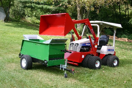

Larger Ventracs ( 4100 and 4200) can be equipped with a "standard" loader in addition to slip scoops. The attached photo shows my 31 hp 4200 with a "standard" loader along with an Earth and Turf Top-Dresser Spreader. The loader bucket has a 9 cubic foot capacity, and the lift height at the bucket pins is 77 inches. The Top-Dresser holds about 20 cubic feet. I will be using this set-up to spread a compost produced by the Davenport, IA, Recycling Facility.
I also purchased a set of pallet forks for the loader. (See next post.) In addition a hydraulically driven auger attachement is available for the loader with auger diameters ranging from 6" to 30."
A very wide range of Ventrac attachments is available to make them very versatile units. In contrast to PT where the primary focus is on the loader, the Ventrac focus is primarily on mowing and turf applications with a secondary, but non-trivial, focus on loader work. Their capability to operate on slopes of up to 30 degrees with duals is the primary factor that meets my requirements.
Venture Products refers to these as Turf Tractors. I think the term "garden tractor" is not applicable to Ventrac 4100 and 4200 power units--they are much more versatile and capable than the term "garden tractor" implies.

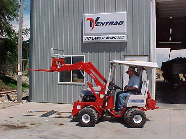

Pallet Forks on Ventrac Loader

There you go! That setup looks great. How hard is it to take off the loader and put the mower back on?

MR,
The loader mounts or dismounts in 2 minutes or less. The same is true with all other attachments. The loader also has a quick-tach system for the working tools and buckets.
