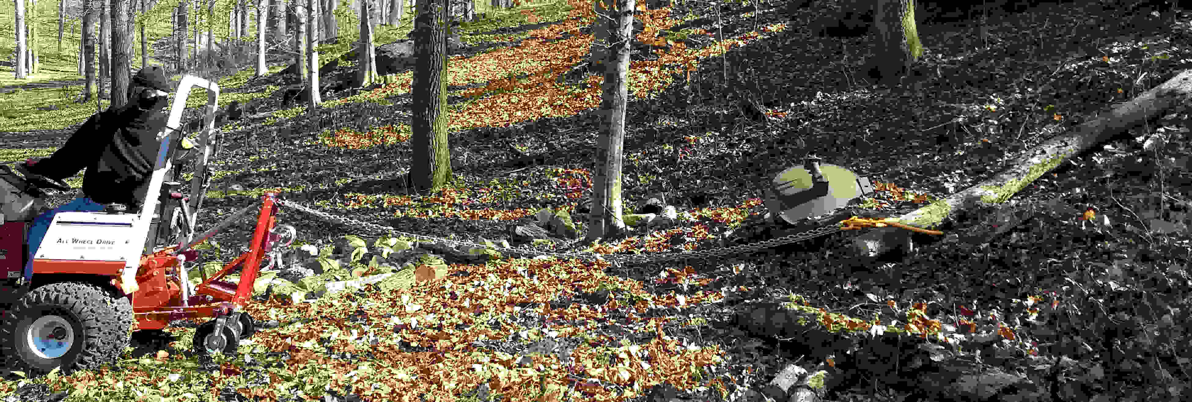

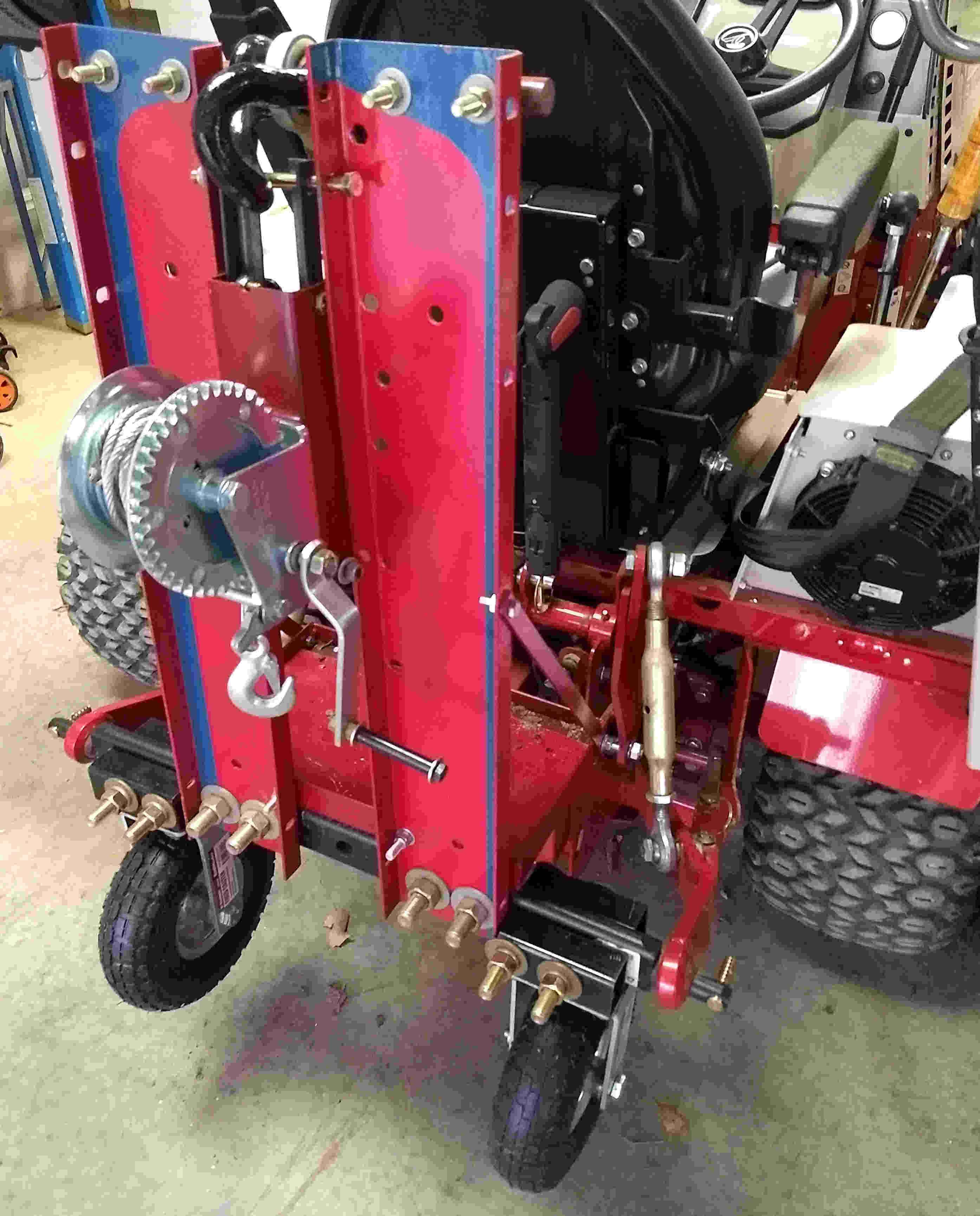

I've been working on this idea for a while.
I bought a draw bar to put in the 3 pt and sort of expanded on that from there.
My idea here was since the arms are so low to the ground anyway, I would bolt wheels on it so that when in "float" the tractor would not need to "hold" the arms up.
Tried it out on this dead tree I was having trouble getting at so pulled it out on the flat land. Seemed to work effortlessly!
I did bolt on a winch but didn't use it this time.
