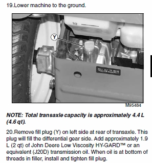

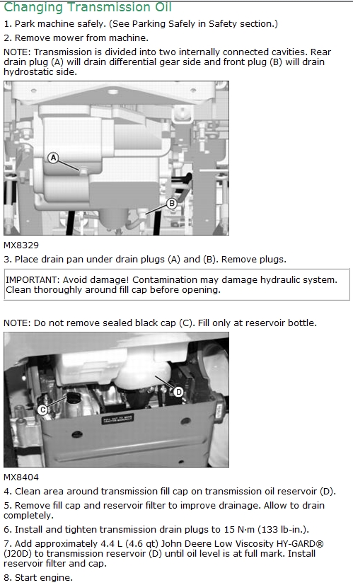

OK, so I just bought a used GT245, and I decided to replace the hydro tranny fluid. I've been having a heck of a time getting the full 4.5 liters of fluid back into the tranny. I easily got the first 2 liters in, but over the past 5 days have only been able to add maybe 20 oz at a time by running the machine in forward/reverse, then waiting hours for the fluid level in the reservoir tank to drop below the FULL line. I've been repeating this process several times a day since I initially drained the tranny.
I noticed in the owner's manual that they specifically say NOT to remove a plastic cap on the top-left side of the tranny. See the "owner's_manual.jpg" attachment to see where they clearly say not to disturb this cap.
On the same day that I started this process I ordered the GT245 Technical Manual, which just arrived today. Well, what do you know? In the Tech Manual, they tell you to remove this same cap so that you can get fluid into
the differential gear side of the tranny! See the "tech_manual.jpg" attachment to see this.
I spent days trying to load the tranny with fluid as described in the owner's manual, only to find that there's a sure-fire way of doing this process in the tech manual that contradicts the owner's manual! Not only am I angry about the time I've wasted, but I'm also wondering if I could have damaged the tranny by running it with 2+ liters of fluid missing from it while I tried over and over again to get the fluid in as described in the owner's manual!
Why the **** would they provide a procedure in the owner's manual that doesn't work and might cause damage, but put a good procedure in the tech manual? Why can't owner's get the proper procedure? :confused:

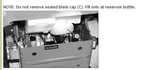

Nope. Changing the fluid is an authorized procedure in the owner's manual. The owner's manual very clearly states NOT to unscrew that cap, but rather to add all of the fluid through the reservoir tank. See the attachment below.
Pisses me off.

Where did you notice that? My owner's manual says very clearly to NEVER remove that plug (see the first attachment in my original post).
It wasn't until I received the Tech Manual (which isn't a document that comes with the tractor; must be bought separately) that I learned I could remove the left plug and pour fluid into it.

Deere must be tailoring the directions to the likely audience. The first is for a idiot homeowner, and the second for a skilled technician. Looks like Deere dosen't want inexperienced people adding too much fliud.
In all likelyhood the owners manual was written before the technical manual and the techs found out exactly what you found. Then Deere corrected the directions in later publications.

Yes, I had to top off the differential side of the tranny by adding almost 2 liters of fluid through the plug that the owner's manual says not to remove.
Were you able to get the full 4.4 liters of fluid into the tranny by only adding fluid through the reservoir tank? Or did your tranny take less than 4.4 liters?
