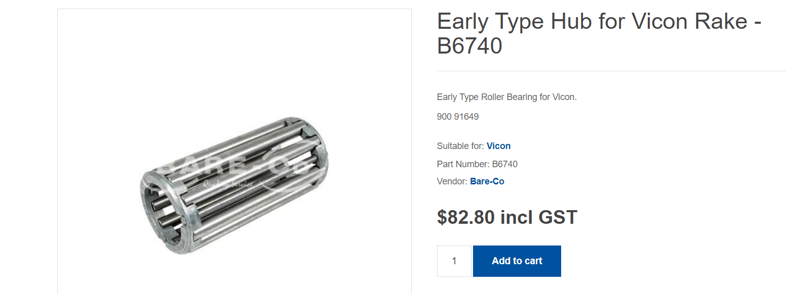

I bought a vicon 4 wheel rake and I need the replace the bearing on the wheels but I did not have any luck finding them. I found the vicon part number 900 91649 but nothing comes up if I cross it over. Thanks for any help
   / Vicon wheel rake #2
Rip it apart and get the part number off the existing bearing. Bearings are one of the few things that are usually identifiable and a place that sells bearings can work with almost any number you give them. NOT OEM part numbers. Those are for bearings with jacked up prices of often many hundred percent.
   / Vicon wheel rake #3
Here's what I see utilizing Google search.
