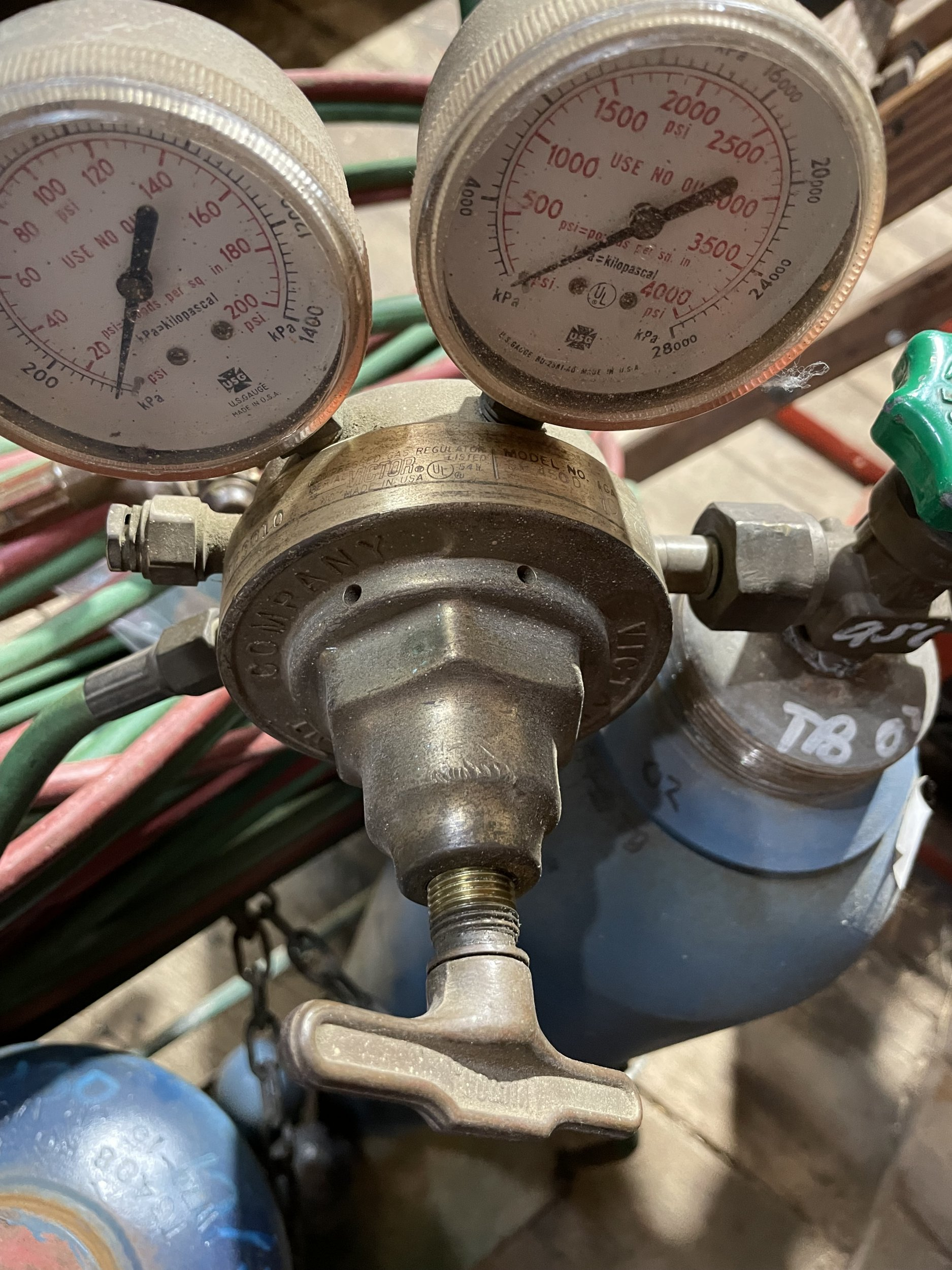

The safety valve on the oxygen regulator started to blow. Wondering if it is a faulty regulator or faulty safety valve? Anyone with experience on this? IMG_0647.jpeg

Would indicate to me it may have blown diaphragm....
You can send it in to be repaired or maybe though local welding supply.... Or get kit and do it DIY...

For my experience back in 2021 go to this link Oxy regulator repair.
I found DIY both cheaper and faster than the local welding supply, but you must be confident of your own abilities.

Agreed and on the "your own abilities"statement,if you aren't 100% confident just send it in to the pros. It isn't difficult but small mistakes can blind,cripple or kill you.
