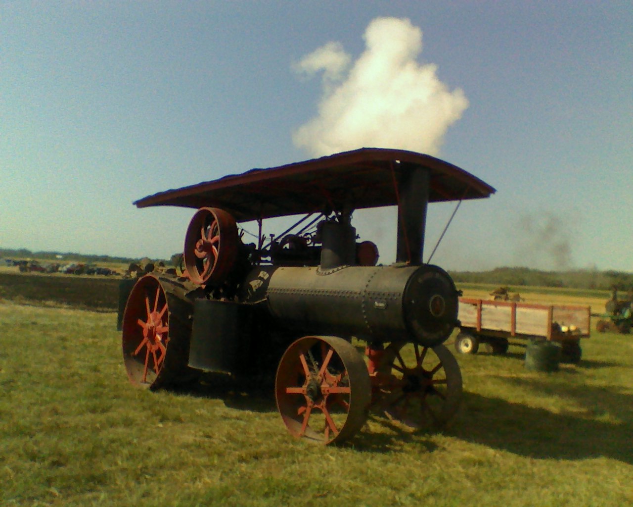

Here's his "hobby" his 1912 Steam engine. I have to apologize for not knowing the brand, I thought I had a picture of the front, but failed. He said that this steam engine was located at the Living History Farms in Urbandale, Iowa, and for what ever reason the family that owned it at the time was wanting to sell it. My Uncle, and the Boone and Scenic Railway in Boone Iowa were the only two parties interested in purchasing the engine. The family talked to my Uncle asking his intention of the engine, which he replies was to be used and displayed and kept in working condition. That was enough that the family sold it to him. He used to haul it to the Power Show, but then was offered "free room and board" if he would crank it up annually at the show. He agreed. He fabricated the oval water tanks on each side, the fuel box (for coal and wood) on the right rear, replaced all the heat tubes, and many other miscellaneous and not so trivial fix and repairs.
He attached the engine to a "baker fan." According to Uncle Bob, it has no function other than to provide load for belt driven power sources, working on centrifugal force moving a boat load of air. With a full head of steam, his tractor could run at full power for 20 to 30 minutes. I believe he said it was 18 - 20 belt H.P. and 60 drawbar. During the night show, they'll attach a steam engine to the fan with a full head of steam pulling against the fan, they will toss a shovel full of saw dust in the firebox and watch the sparks fly out the exhaust. It's said to be quite a show. Previous shows he's ran the rock crusher, or saw mill, they just rotate around to different stations.

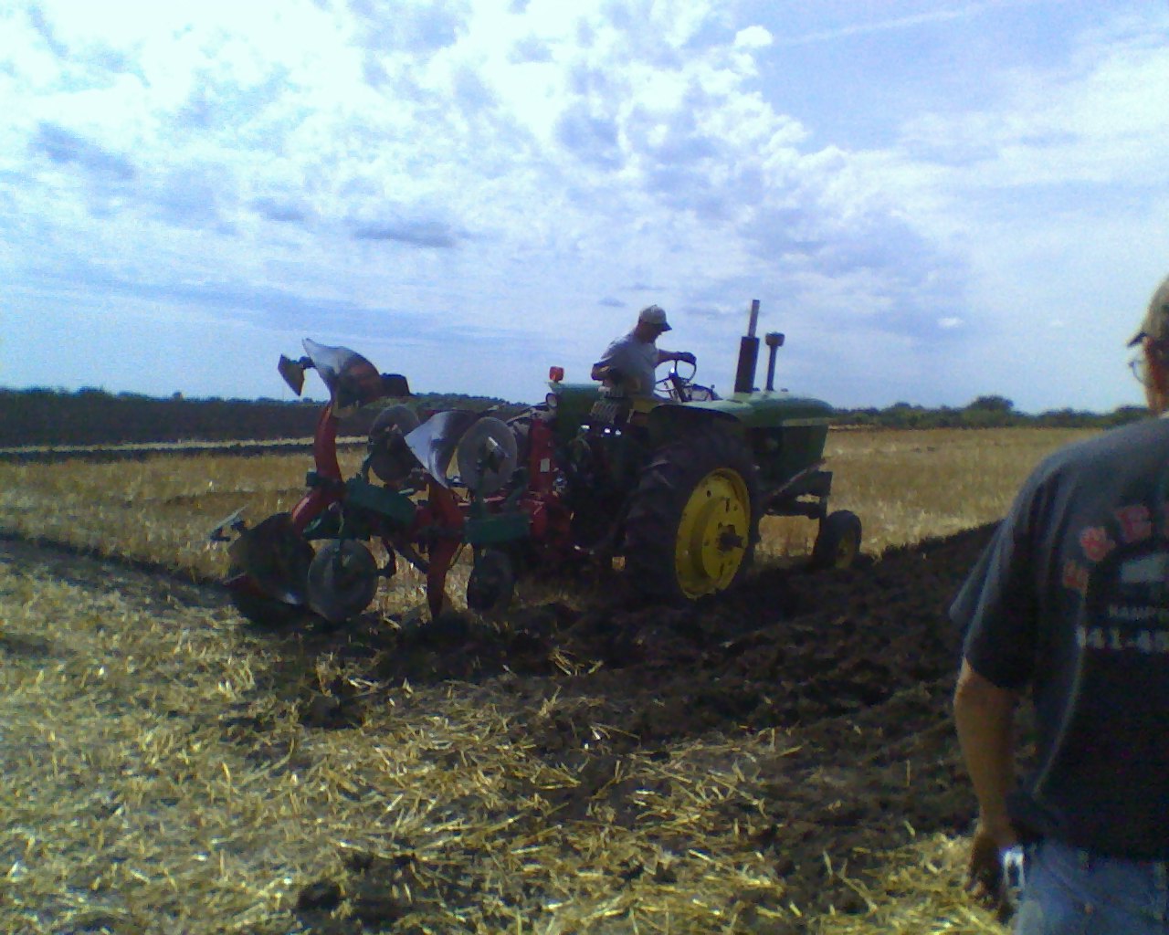

At the show this year, they also had the National Plowing Championships. I was only able to get one picture of a participant, but it had the craziest plow I've ever seen. It looks like it must be made for competition plowing.
If you click the image, look where the operators right hand is behing the seat. He has hydraulic control of nearly EVERY element of the plow. Notice the back bottom is at a different angle than the first. He adjust the pitch of each bottom, the roll of the plow beam, depth of the coulter, and gauge wheel. He can adjust the left and right draft, I mean it's a work of engineering for him to get it in the ground. Notice the extended moldboard, it really helps lay the soil over and covers the trash well.
