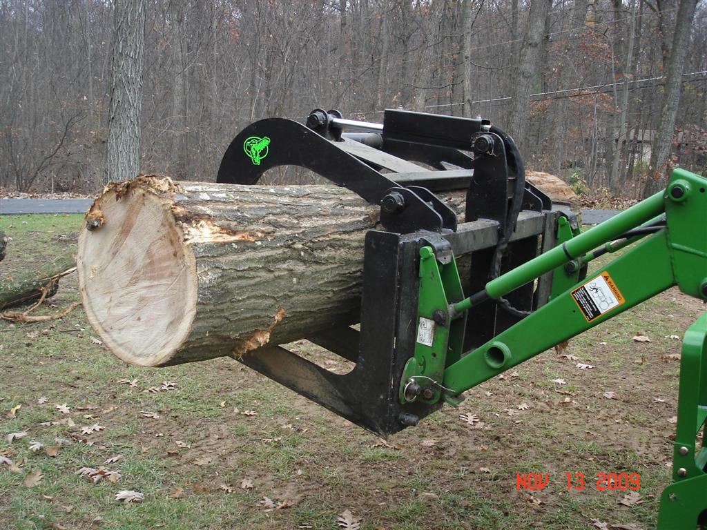

I installed a diverter on my tractor...pretty easy to do. There are several threads on adding aftermarket remote valves and diverters to machines similar to yours. I have read of no one who has the JD 3rd SCV kit-but lots who have the PB kit.
Here is a picture of what my grapple can do:
   / W.R. Long Grapple on 2520
#9
Thanks for the pic. That's an awesome grapple. Just what I need (want).
