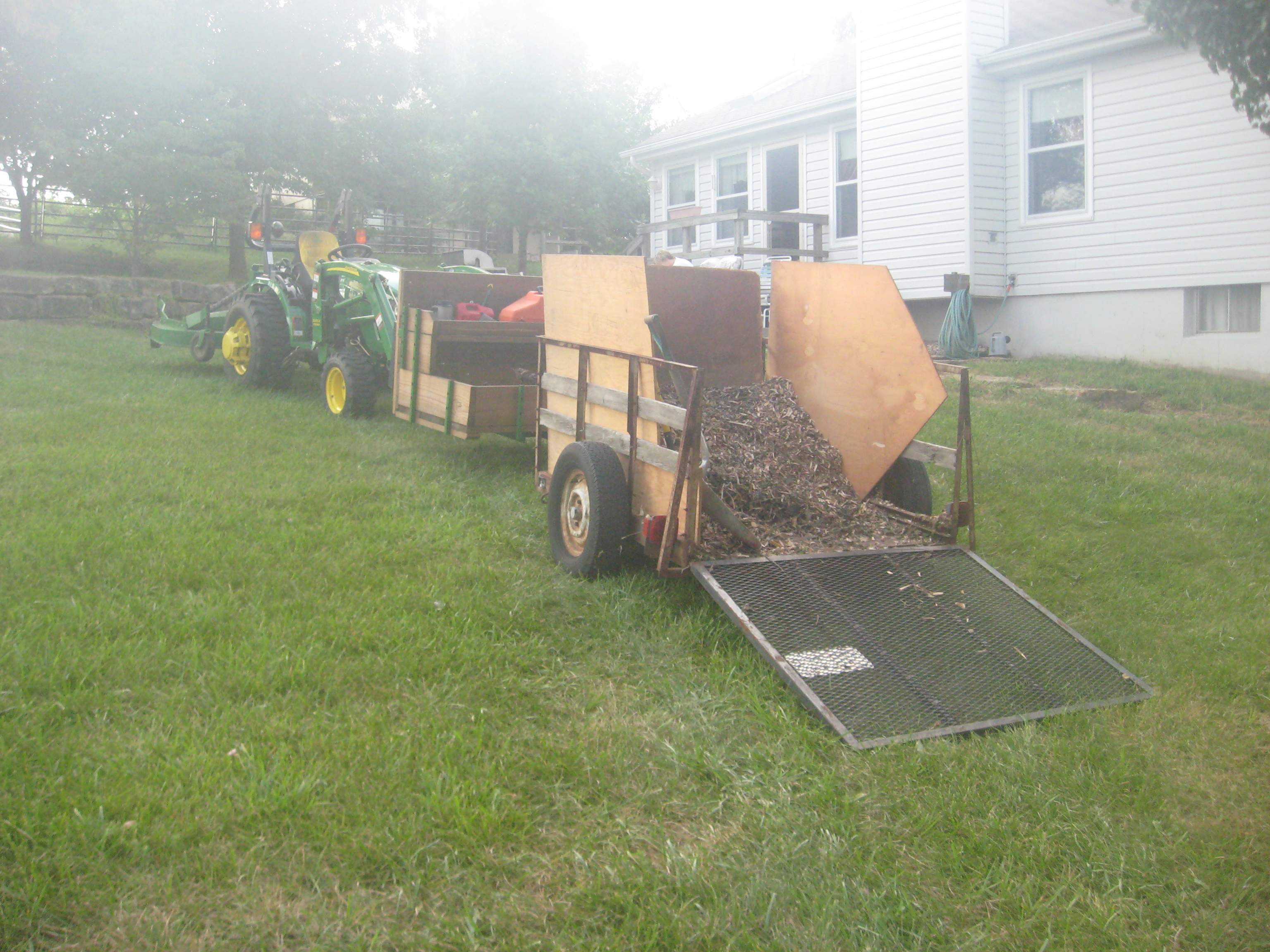

I do. Then, haul the chips directly to the trees to apply the mulch. My trailer has open sides, so I just throw some old plywood in there.
