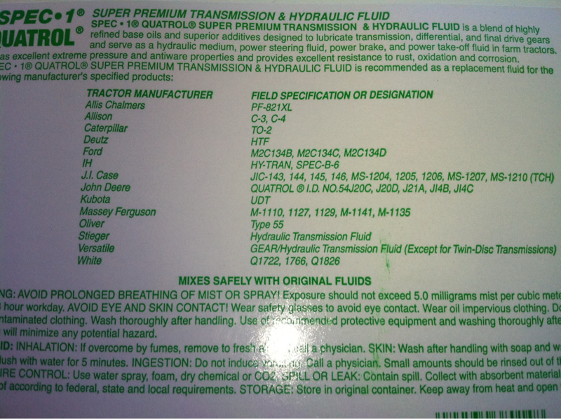

I have an unopened pail of walmart hydrolic fluid that i used to dump in my old 79 ford's loader..Is it OK to use with my new LS Tractor? I need to change the hydrolic filter for the 50 hour break-in change and was thinking about using it to top off any fluid i might lose..

Here is a picture of the hydrolic oil in question.
There are different types of hydraulic oil and each has a rating. If it's just for your loader, and not wet brakes or a transmission, then you are probably fine. With brakes and transmissions, you really need to make sure you use the correct oil. The picture doesn't show the list of types of machines that it's good for.
I not sure what model you have. I have a U5030 gear this is the fluid I use and got from my dealer it what shown in the manual this is the list of compatible oils.
