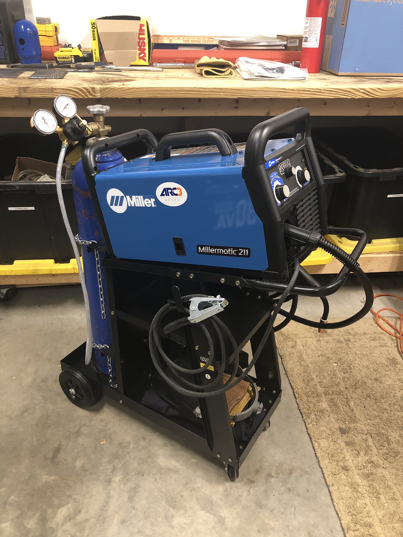

My Millermatic 211 is the older 2013 model, I assume the new ones still have the auto set, I've welded lot of years with high end Miller pulse inverters at a shipyard but when I do my home jobs I use auto set everytime and find it on-par with right wire speed and heat.
I always found it better to have the the right length welding cable for said job, so I have Tweco Quick Connects if longer lead is needed. I dont know if theres difference between longer weld lead or longer extension cord, I know good ground matters....

It took a minute but I found post 197, evidently the 3 year old Millernatic 211 is still working good.......
"Thanks; yeah, probably a teensy bit over the top - but every "feature" has a purpose (for ME, anyway) - I needed max portability in a reasonably small footprint, since at times I'll be either trying to lift the whole thing onto a trailer or truck bed, towing it around the property with a tractor or lawn mower, tilting it back onto the big tires for moving over gravel (relatively short distances)... I'm not sure how well it'd work with the older MM211 - I had one, and it's almost TWICE as heavy WITHOUT a spool of wire as the NEW one is, WITH a 12# spool...
Only thing I DON'T like (about EITHER version) is that autoset is too hot (a common complaint) - I just recently learned that (reportedly) the autoset "assumes" you'll be doing FILLET welds, which would explain the "too hot"...
The newer one lets me use a 15' gun - has the down-firing feed and a stronger drive; autoset has a LOT more options including all THREE wire sizes, + flux core, stainless, mild with C25, mild with CO2, and spool gun/aluminum. IOW, nearly everything I DIDN'T like about the OLD mm211, got fixed on the NEW digital one -
They both spec the same (24.5 amp/240 volt) draw at rated output, BUT - the transformer version is NOT recommended for 50 hZ, while the digital version is rated at 50-60 hZ - and I spoke to a Miller tech about generator THD, he claimed the digital version "didn't care" - I hope he's right, 'cause ONE of the "eventual" projects is over 3000 feet of new fencing with welded-in-place H braces every 20-rod roll (330 feet) and my genny is 7kw continuous but NO spec on THD - that project will probably be the ONLY time it sees flux core wire (if I LIVE that long ) but it's possible it'll hafta run on the genny for other indoor projects (my son's garage doesn't even HAVE a 240 outlet so if he ever needs something welded I would probably put both the welder AND the genny on my small trailer to do that)...
"Might need to go 'balls out' on a stand like you did." - Well, ya got a LOT of pics and "features" to pick and choose from - but given the weight of the transformer 211, I think I'd be tempted to do a lower slung, "over-under" setup - the 211 low, but angled up like I did - then the PM45+ above that on a second set of angle "rails" -
Things I watched VERY carefully for, was ZERO interference with side door WITHOUT having to take the welder off the cart, zero interference with air flow, gas connection, power cord, etc - and no metal-to-metal connection between welder and support angles (found some EPDM self-stick weatherstrip at Lowes, goes on BOTH surfaces of ALL the angles) - NO reason ELECTRICALLY, just didn't want scratched up paint on either Miller's creation or MINE
IF you do one, you probably DON't need EVERYTHING I did - like a trailer hitch, maybe not even an adjustable balance picking eye - but the larger wheels and "hand-truckability" is nice, in that it also provides a "roll cage" to protect gauges AND a way to support a dust cover - also, the locking casters are something Miller shoulda thought of on their carts...
Man, now I'm startin' to sound like a freakin' SALESMAN, and there's NO WAY I wanna build MORE of these ...
