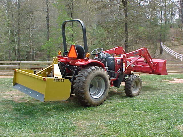

Thanks folks. I'm ordering a BushHog 65" box blade for $475. I like the 3pt welded construction, heavy duty double strap hitch (seen several bent pins on used single straps), good weight 510# and easy pin adjustment on scarifier teeth. It would be nice if it had a swinging tail gate but I would have to spend another $150 for a 5' model . The 5' won't quite cover the width of the tires and the 6' is an extra 130#s. I'll let you know how my decision works out.
   / want to add rear blade
Well, I finally picked up the new Bush Hog SBX65 boxblade and had a chance to try it out. It works great! My 3215 has no problem working with it. Even up some grades. Just put tractor in M gear, set rpm at 2200. Slices through dirt like butter and I was able to make quick work out of my washed out areas. Leveled and smoothed out the area in a few passes. Then ran over the area with a harrow, seeded and now just waiting for some rain tonight. It really saved me a lot of time over using the FEL. Highly recommend!:) Check out pics.
