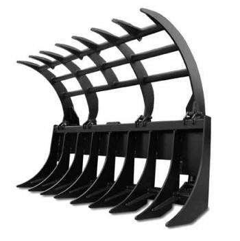

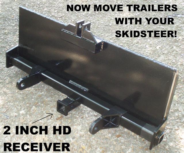

Why not put the landscape rake on the front of your tractor using one of these.
If you have a loader, the root/grapple rake should work fine.

thanks guys, I don't have a fel or rear remotes so those are kinda out . May add rear remotes if not too $$$, I understand about backing into a pile of brush and being attatcked. I've used a roll over blade with some success but was wanting someting more like a 3 pt root rake I guess,
