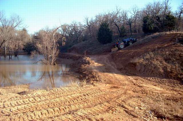

I want to get a tractor/backhoe/front loader that I can safely use on 80 acres or hilly, mostly wooded land in eastern Indiana. I need to re-dig some wildlife ponds, make creek crossings and road culverts, rework some drainages and make new tractor routes for hauling out firewood.
What kind of equipment should I look for to give me the most stability on steep hills? Should I get 4WD? Hydrostatic transmission? Dual rear wheels? Are there any models that are more stable than others?

Ron, you will probably get a whole range of answers to your question and many will ask for additional information like how much you intend to spend. If you plan on buying a tractor in the $35,000 plus range, there are many choices in the 50 to 75 horsepower range, but they are really above the compact utility tractor range. I don't know of any of these tractors that have a hydrostatic transmission, but they all can be 4WD and can be fitted with very nice backhoes. Below 50 horsepower in the $35,000 and below range, you can find tractors with hydrostatic transmissions, 4WD, FELs, and the choices are unlimited for accessories. With 80 acres and your experience with the 9N, I'm guessing you would not be satisfied with anything below 35 horsepower. The base 35 hp tractor will be $16,000 to $19,000 and then you can start adding attachments to easily reach the $35,000 region. I wouldn't want anything less for the work you describe. I'm not sure any of these tractors are suitable for cleaning out stock ponds. I consider that dozer or excavator work. You can do it with a tractor, but you will use a lot of time doing it. All the other clearing jobs, laying culverts, and creek crossings will be handled well with a utility or farm tractor. All the major brands will have a full line of tractors and implements. Many will have attractive financing plans too. Good luck in your search. /forums/images/graemlins/smile.gif

To give you an idea of what you can do with 4WD and a compact tractor with hydro tranny, I've attached a photo of a path/trail I built with my tractor. The small hills you see on the right side of the photo are no problem for my 45 hp tractor. I'm sure John Deeres, Kubotas, Massey Fergusons, and all the other tractors in that hp range would perform similarly. I don't think you need rear duals for the jobs you described.

UPDATE--- Just got “back home again in Indiana”. Thanks to all who replied for their good advice. “jinman” that photo was worth a thousand words! I measured that slope you were on at 22 degrees, by the way. That’s about what I want to do.
