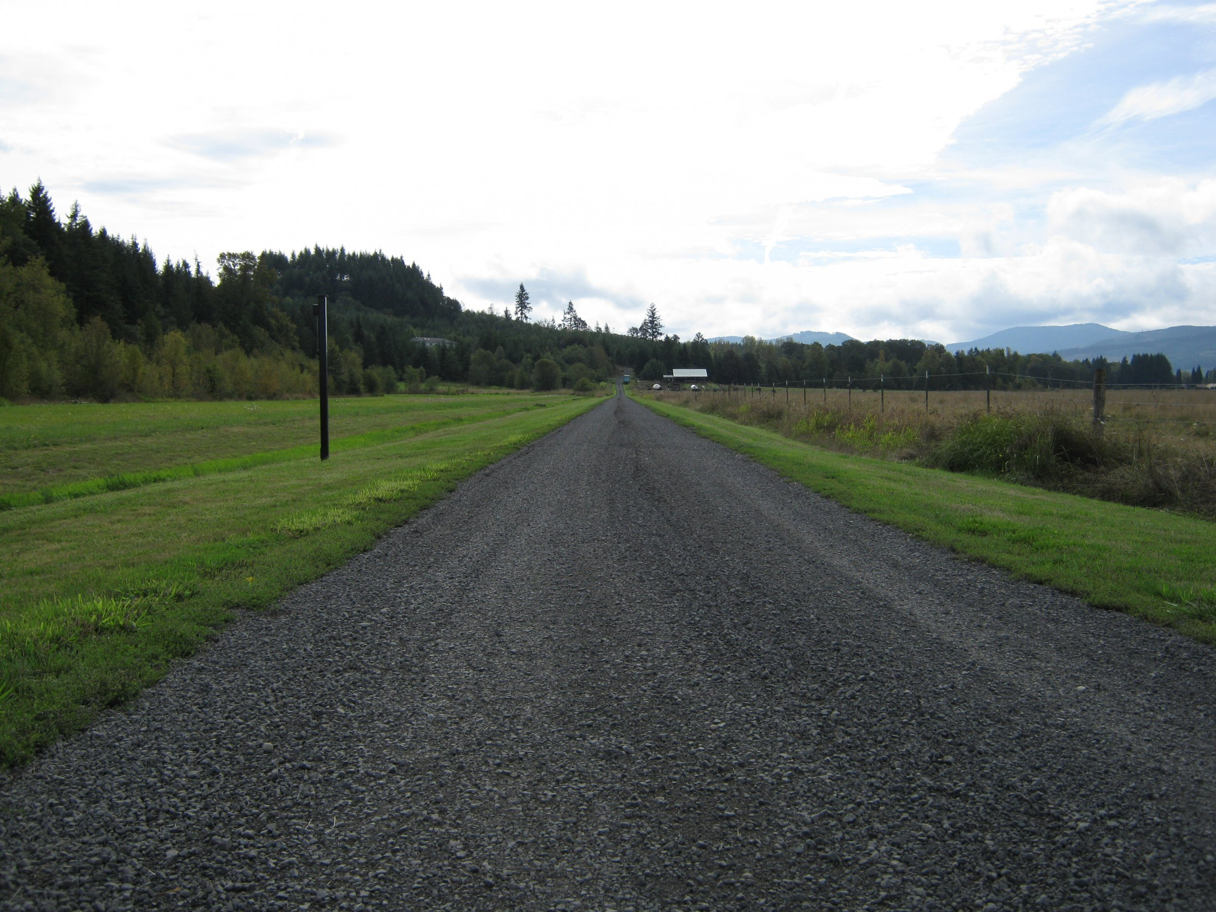

   / want to get attachment for a case IH 245 for ditching driveway...what to use ? #5
Pictures of the driveway he is intending to ditch. I gave up on ditches because they fill with weeds and stuff and finally just crowned to road and made mowable ditches on either side.
   / want to get attachment for a case IH 245 for ditching driveway...what to use ? #6
After seeing the road I would suggest a rear blade. Looks like he already has ditches. He just needs to reshape them a bit. I would pull all the gravel to the center and the work the sides down to the ditch for good runoff. Then level the gravel back out.
that's not the driveway I speak of , I bet they WISH it was, lol.
Their driveway is long with many winding curves through the woods & up a steep hill for about 1/4 of the way. ( think back country mountain driveway )
Ditches are somewhat deep in some areas... maybe 6 -10 inches, one area in particular is closer to 14-16 inches deep at least.
The ditching / gravel had been previously done by a grading company, he just needs to maintain it to prevent the ditches filling up and rutting out the road again .
They fill up with dirt badly .
