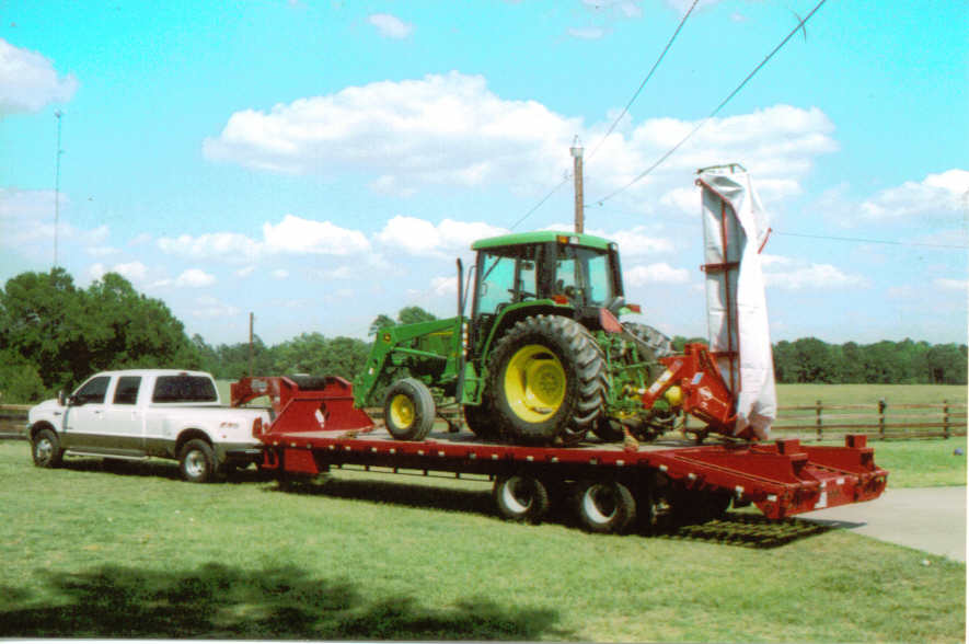

Here's a picture of my new disc mower- a Kuhn GMD 700 GenII. It's the second Kuhn mower I've had. This one is a 7 disc that cuts a 9' swath. It's mounted on a John Deere 6400 85 hp tractor. I also bought a Kuhn SR110 ten wheel rake. I cut my hay last week and they perform very well.

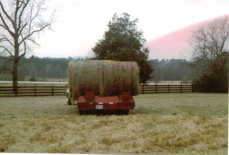

Here's a picture of what Indydirtfarmer is talking about regarding large round bales. I had to buy extra hay last January. These were a 5x6 bale that probably weighed 1800#'s each. I use a John Deere 535 baler that rolls the same size bale but I use all the hay I bale. If I was selling it I'd probably use a smaller size round baler.

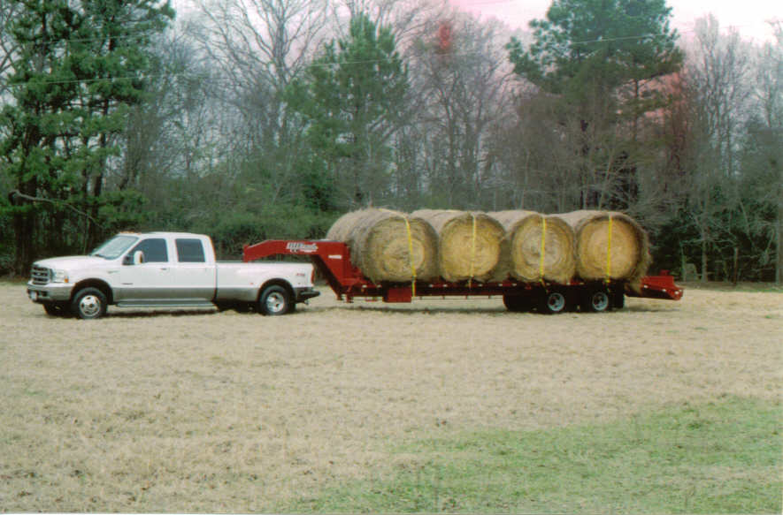

I could only load 8 rolls per load.
