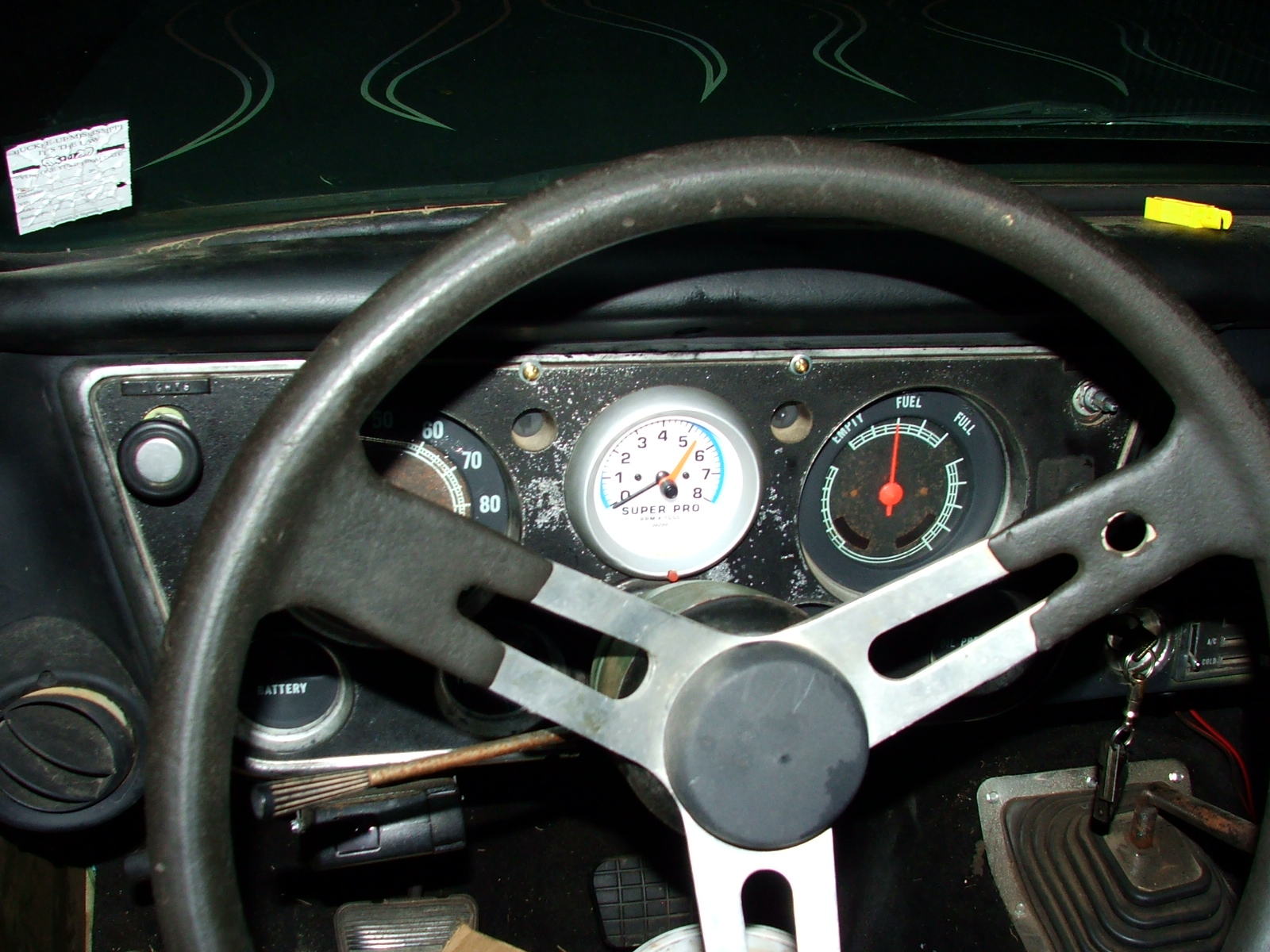

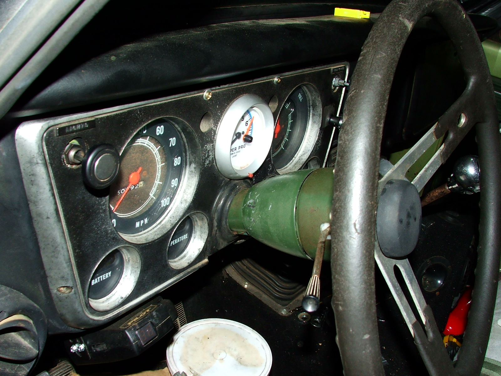

I am currently adding a after market tach Into ( same spot ) a 72 Chevy C20 with the deluxe instrument cluster.
I can buy a cluster w tack for 500-1000.00 but the higher ones has the vac gauge too.
The Main cluster is the same,
The plastic over the gauges is different, the main metal housing inside is different. the rear metal cover is different, the printed circuit is different.
Some of these differences can be modified to make work, some cant and you need the right part.
Of course you can hang a bracket and use aftermarket, or even a gauge pod like some of the 60's muscle cars that had gauges mounted on the hood or cowl.
