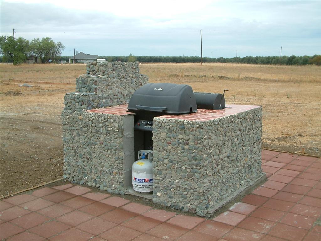

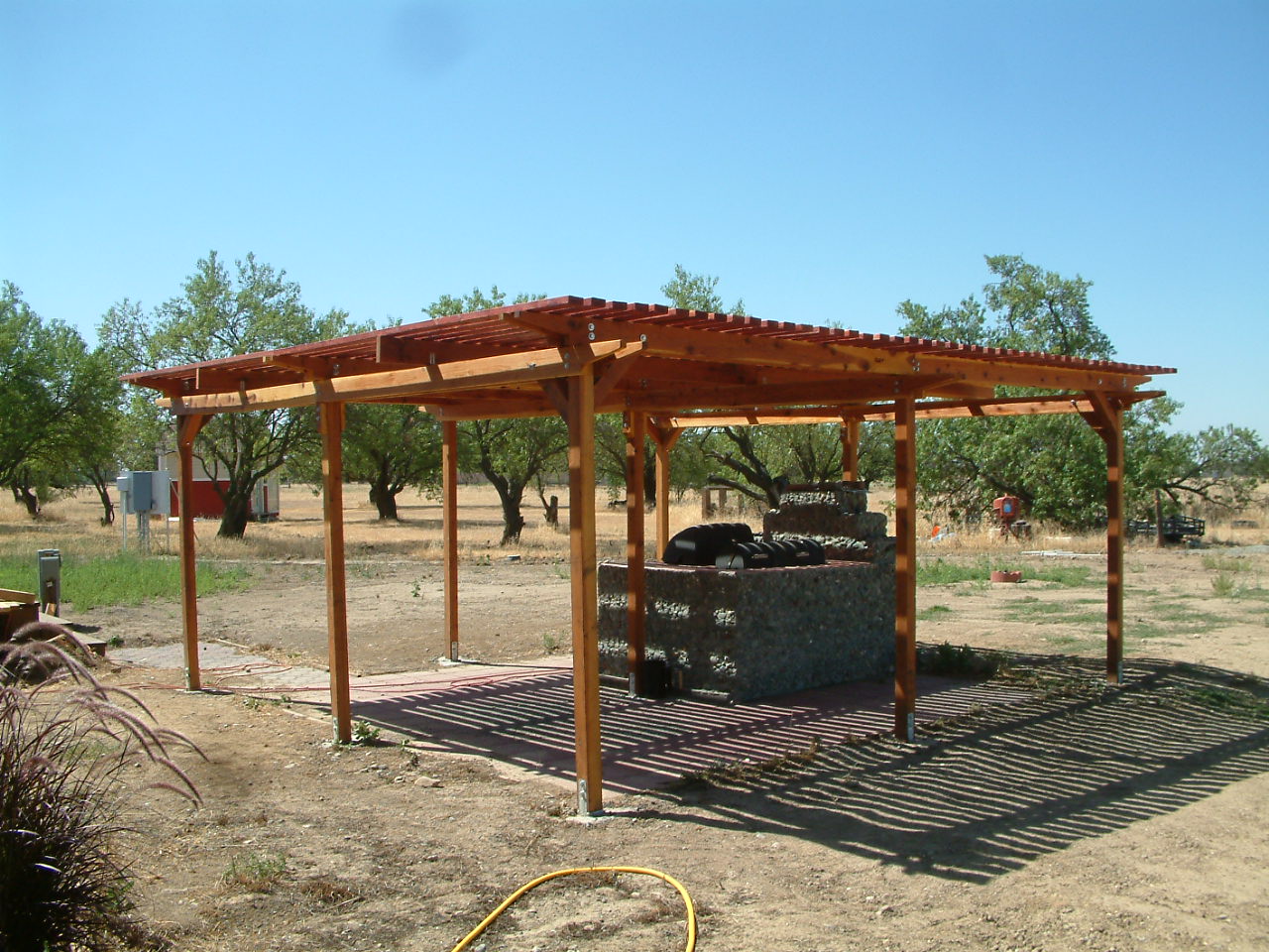

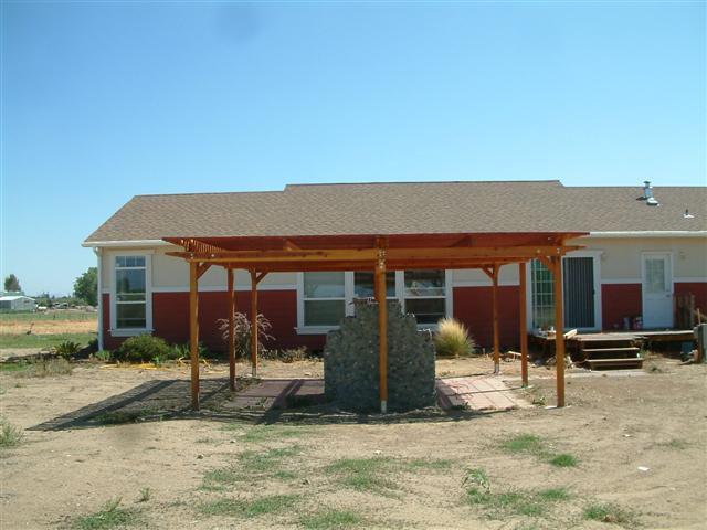

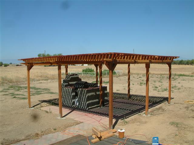

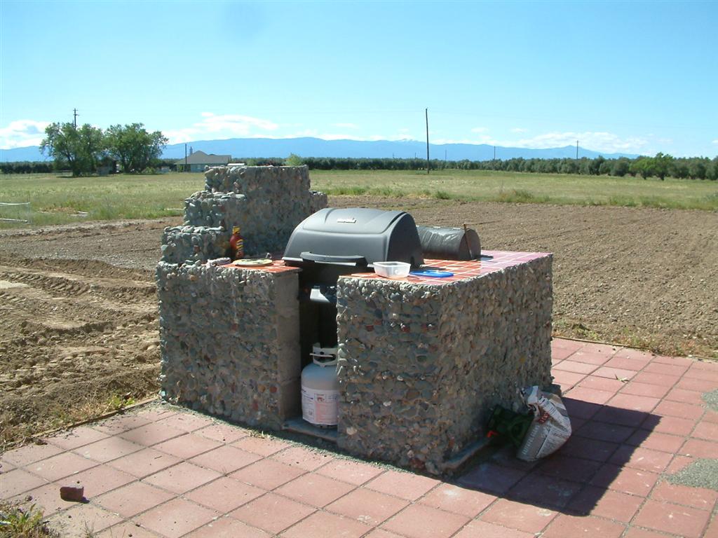

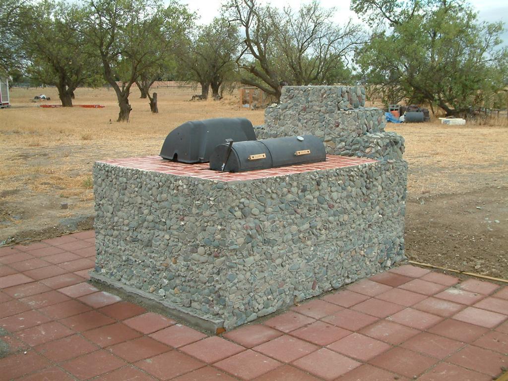

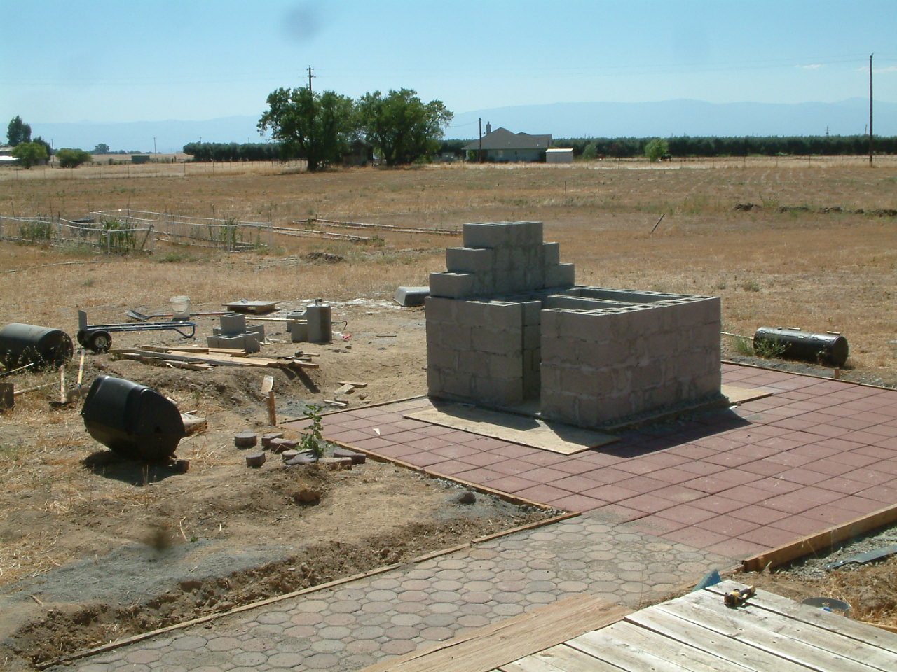

   / Want to make a small smoker into an outdoor fireplace #7
We want to incorporate a smoker into our outdoor fireplace and need some advice as to just how to do it. Any suggestions would be great.
I built this one a few years ago.
BBQ pit-4.JPGBBQ Pit-5.JPGBBQ Pit-6.JPGBBQ Pit-7.JPGPatio BBQ-1.JPGPatio BBQ-2.JPGPatio BBQ-3.JPG
Cinderblocks, tiled top work surface, river rock facing, propane grill + smoker. Chimney works.
Good luck.
