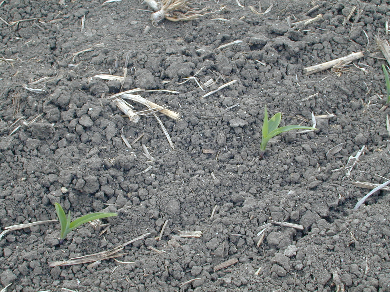

I am thinking along those lines as well.
Went out this weekend to work on the fence and get the soil sample. The fields are dry on top and are very moist from 2" on down.
The farmer who leases my large field this year and the fields behind me has planted and sprouts are coming up.
