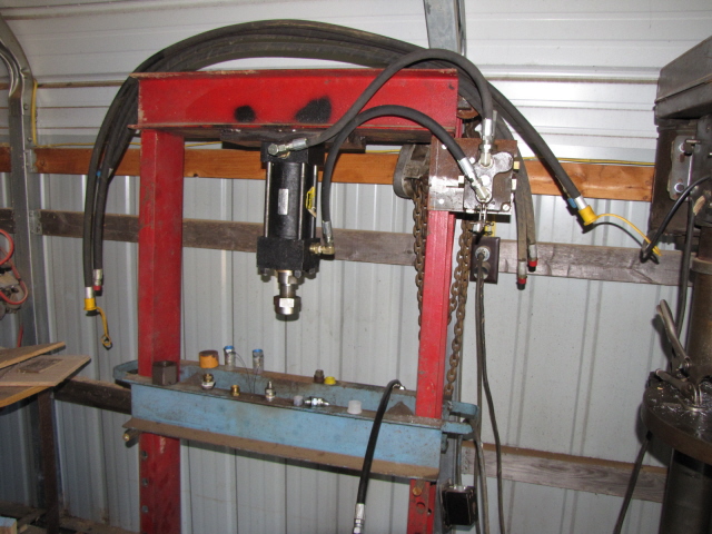

   / Wanted - Good design for home made hydraulic shop press. #6
Here is just one of the things I got going on right now. 2 many hands in the fire right now. But anyways I took the jack off and put this cyl and valve on mine. I'm going to use my tractor right now and see how that works out.
