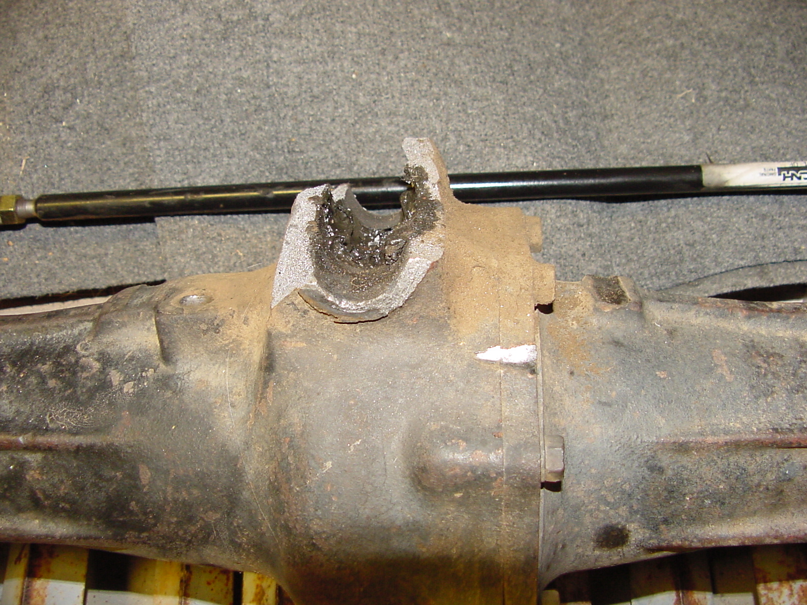

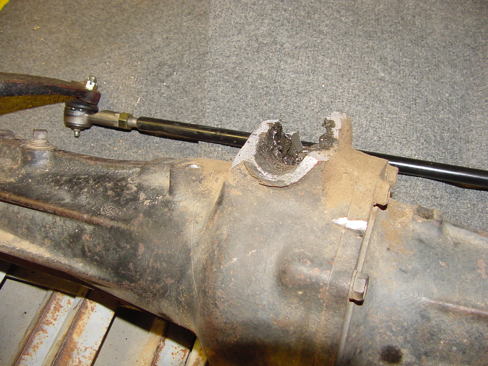

I'm looking for a Front AXLE (Center Part) Housing ASSY, RH, Case IH part #1273219C91. Same as International 244 & 255, May be interchangable with Mitsubishi MTE2000D & MTE1800 tractors. Without it my tractor is worthless...I really need this part! If you have this part or complete front axle, please email me! Thanks! davidrlittle@yahoo.com

I did the same to my 244. Took everything apart, cut out the break, heated up the housing, welded on a tube I machined and then covered everything in a welding blanket for a slowwww cool down. Turned out great! Traded for a Deere 3320 some time later. Loved that little 244.

My RH side front 4WD axle housing on my IH 254 broke in the same way as your previous IH 244. Can I ask what type of welding method you used? Was the tube you added made out of cast iron--same as the housing cast iron? I have exhausted all options, this part is not available anywhere. Many thanks!!!!!!!
