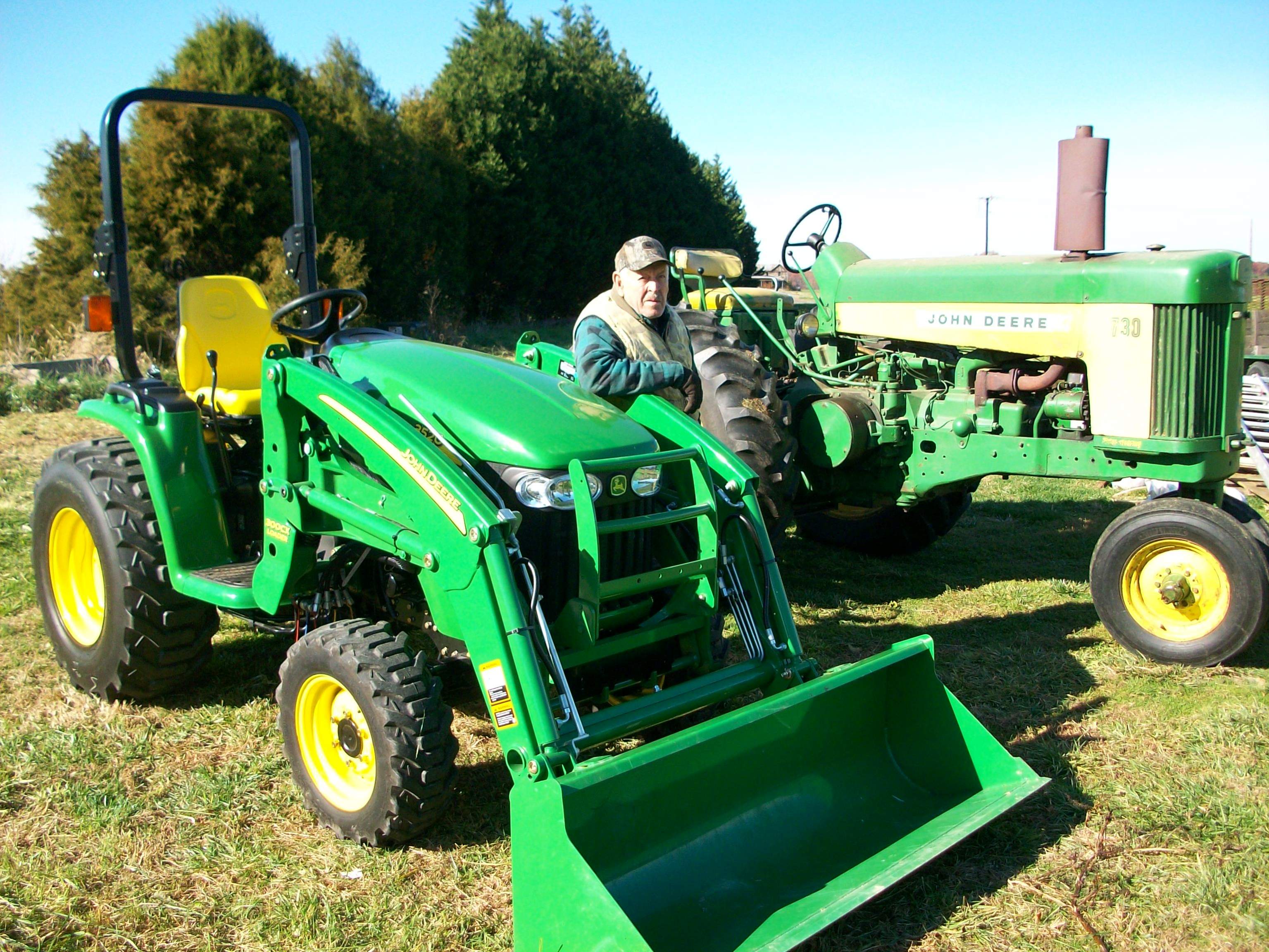

What brand of aerator do you have? I got a great deal on a 2010 Frontier 2060E. Some guy bought it new and didn't even put it in the ground, traded it back in and I bought it used. It has six spoons per hub as compared to eight on the more expensive models. I would prefer the eight but I couldn't turn down this deal and it did a good job when I tried it out. It also has a heavy duty frame which is a plus. Before I bought my own JD 3520 w/R4's I rented a 3520 with the R4's many times to overseed on different soils and didn't have a problem with tire tracking the lawn. You just have to pick the right conditions to not leave any tracks. Pick the wrong time and you can have problems with turf tires too. My tread pattern is a little different than yours, I don't think it's enough to cause a problem but maybe it is. There is ground disturbance with an overseeder or core aerator so what little the tires do as far as scuffing should be taken care of with the attachment you're using IMHO. Check out the tread pattern in my pic.

I have a Landpride CA2560 with the dual 30 gal water tanks. 8 spoons per gang, 96 total. It works fairly well but on soft turf when lifted the tread pattern will be left. You are compacting at the same time as you are aerating to relieve compaction!!!
I'm fixin to give up on finding a trade. I found a guy south of Lexington who wants to buy my wheels and tires. I guess I'll buy new and take the hit.

You'll have to treat the area where you lift up as a turn row like a farmer does and aerate it last as you leave the area.
Let us know how the turfs perform.
