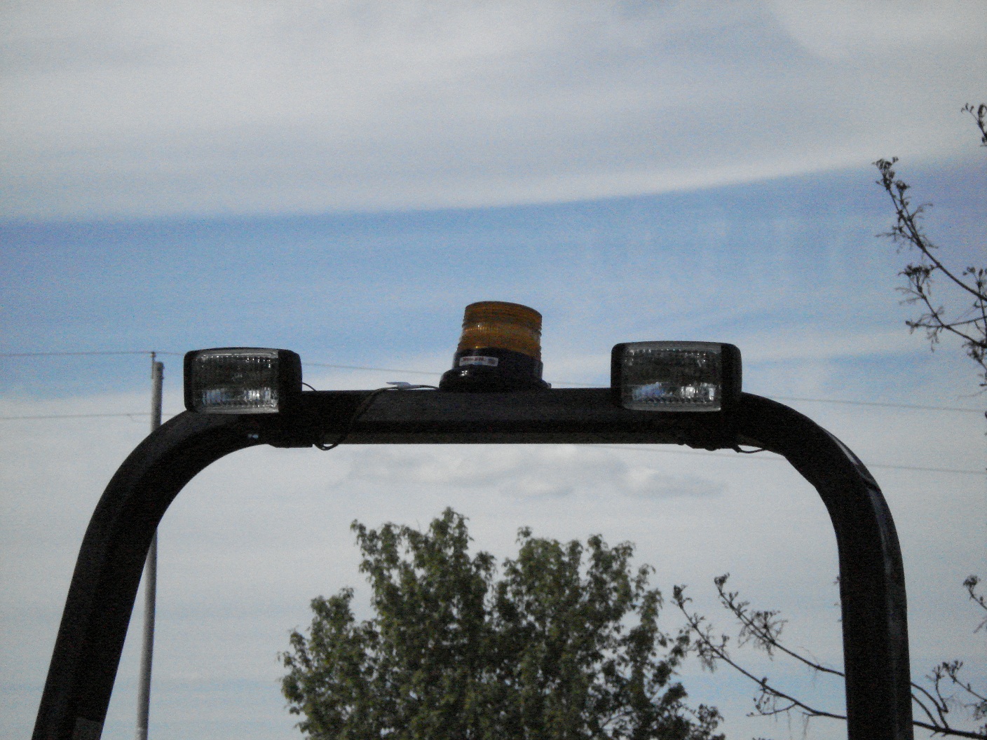

Will you be using your tractor on or near any public roads? If so check your local DOT regulations. some areas require the use of amber lights, or beacons on tractors.
Just a thought.
myself I use an LED strobe.

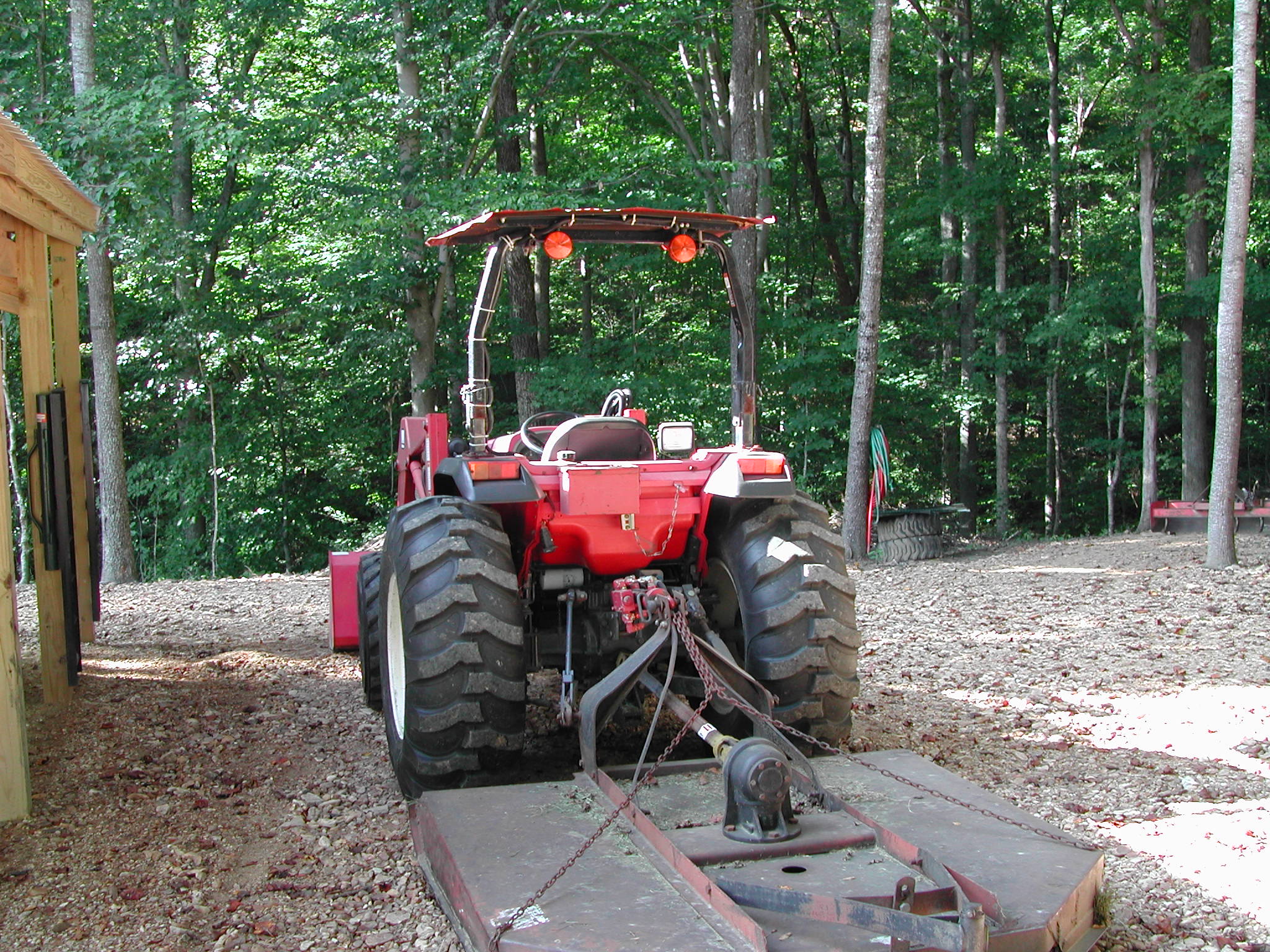

I added these to my ROPS years ago since my toolbox covers my warning sign bracket. They are attached to the angle iron frame of my canopy, not the ROPS itself. They have great visibility from front or rear and an oncoming vehicle can see these before they can see the tractor when coming over a hill. They are hooked to my 4-way flashers - my fender lights are yellow too and all 4 flashing at the rear is pretty eye-catching. The wires going up the ROPS frame on the left are in poly wire looming and then just cable ties holding that. Will have black ties the next time I have to replace them and you won't even see it all then. The original fender mounted warning lights were on the fenders just in front of the ROPS uprights - you couldn't see them at all from the rear and not very well from the front - I keep my FEL on at all times. Knock on wood, I've never damaged one of the lights and do alot in the woods etc. My canopy kinda keeps branches angled downward more often than not and they don't seem to hit the lights much at all.

Is that a magnetic base on your lamp?
