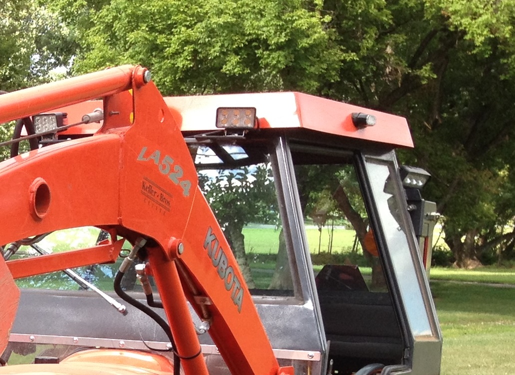

I'm getting addicted to LED's. There's a smile on the guy's face when I walk into The Trailer Shoppe. Here's a picture of the way the side flashers are mounted. The sides of the cab roof are angled and I wanted to make sure the flashers were mounted plumb for maximum effect. I had some Azek(?) plastic 1x4 left over from a project that became tapered mounting blocks for the lights. People in cars need to see them - squirrels in trees don't pose a hazard. Travelling on the road the side flashers light up the fronts of houses, garage doors, etc. when the tractor passes by.
The "Bugeye" front lights from a donor plow truck that are in my avatar were replaced with LED floods and you can see one of them in the picture as well. There are 2 front, 2 rear and one smaller LED on each side. Works pretty well like that for night mowing or plowing. On Tuesday I picked up some of the little flashing LED singles as shown in the link below. I played around with them last night using a DeWalt 18V battery and a bunch of jumper wires. Not sure which tractor they'll be mounted on. I need to get something on the Ford before next Winter.
