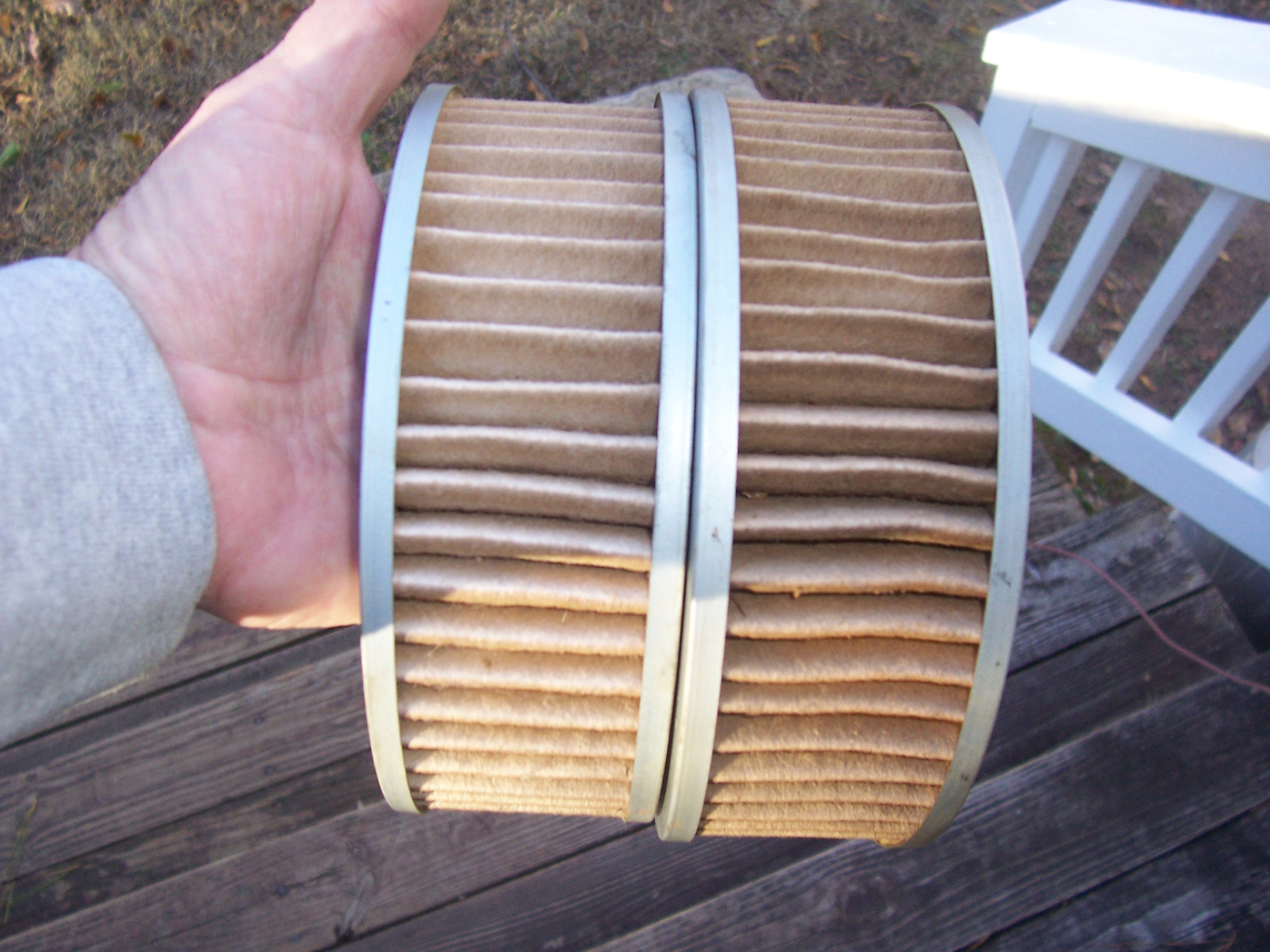

Had a minute while I had my Tractor Maint. supplies out. I decided to give the dirtier Filter a bath and see what happens. I'm going with Neat 1500 and use warm water and soap. It doesn't have any oil just mostly dirt on it. I may use a hair dryer to dry it. Honestly I don't think that the cleaner one was used much more than a Yr.. I've owned it 9yrs. and put over 550hrs. on it. The dirty one of the filters looks really good for a tractor that looked like it just rolled off a boat when I bought it. My bet it will look as good if not better of the two. Will see..............
   / Washing Air Filter #9
Finished cleaning the dirty one! Was actually shocked how dirty the water was. Only a few inches above the filter and a few dips and drains and you couldn't see the bottom of the sink!!! I put it back in the Tractor and the cleaner one is drying now. I'm glad this came about so it will help remind me to wash out my filter's and not just blow them out. Which I see no damage in washing them...

DItto. on the stove. I let mine sit on end over the Sinks Drain and when it quit dripping I blew it lightly out with a Hair dryer and then Put it in the Oven @ around 200Deg. and got it warm. Then I let it sit and dry. Still It took a few days to get dry. The actual color of either mine hasn't changed much but OMG! you should have seen the water of the dirtier one. The clean one was clear with only a little dust and dirt. No doubt now when the oil gets changed the filter gets changed out and cleaned for the next Filter change. Trust me I knew it was in my best interest to hurry and get the sink cleaned up!!! Which the dirtier one I actually had to drain the water and rinse out twice.....
