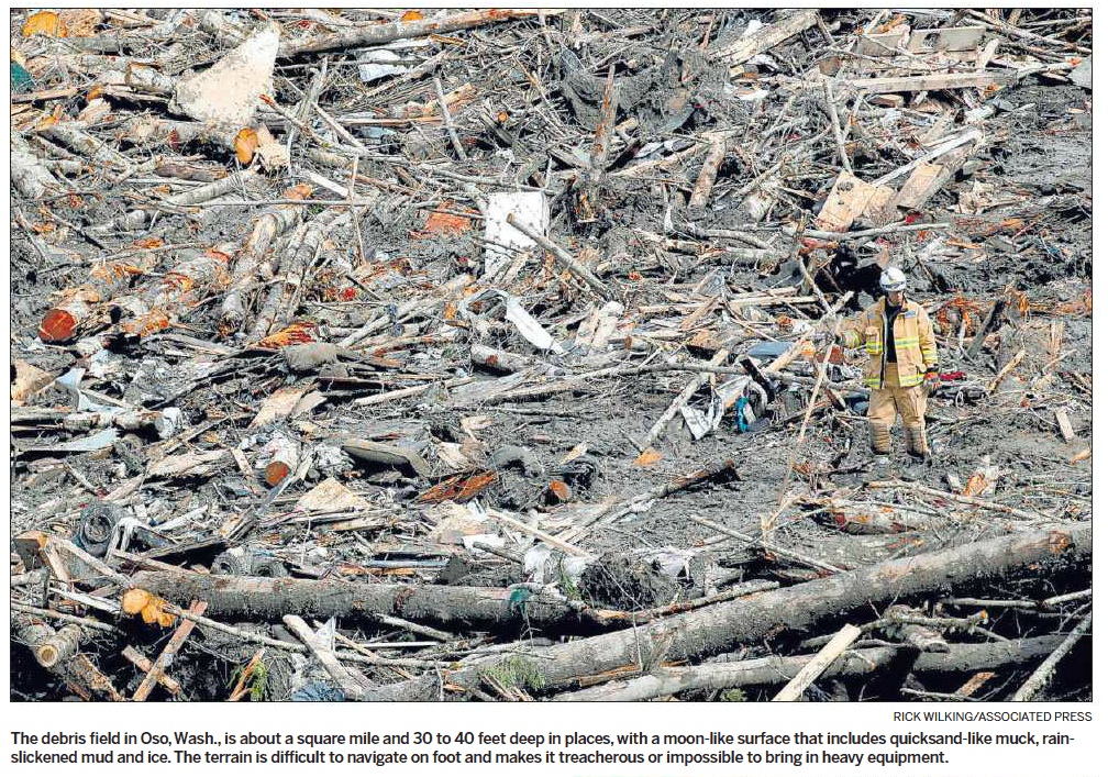

#11
Very tough weekend. Our S&R team worked the slide for two days. Terrible mess......mud and debris everywhere. Still can't get big equipment into many areas. Met some wonderful people.......a real community up there. We found lots of personal belongings......everything was bagged and sent for cleaning. Hopefully....it will find it's way to the owners. Tragically.....we found remains as well.....both human and animal. Our fellow searchers are some of the most respectful folks I have ever encountered. When remains were found or a helicopter flew out........everyone stopped searching......paid their respects and helped each other. Been through many rescue operations......this one was really tough. Thoughts to all the families and folks affected by this event. Thanks to all the folks up there working the recovery. We may go back next week-end.

I saw one photo taken at street level. In the background an excavator was sitting on the road, and behind that a wall of dirt and debris that the excavator apparently was working its way into. Seen from that perspective, I could get a real understanding of how much that area was buried.
