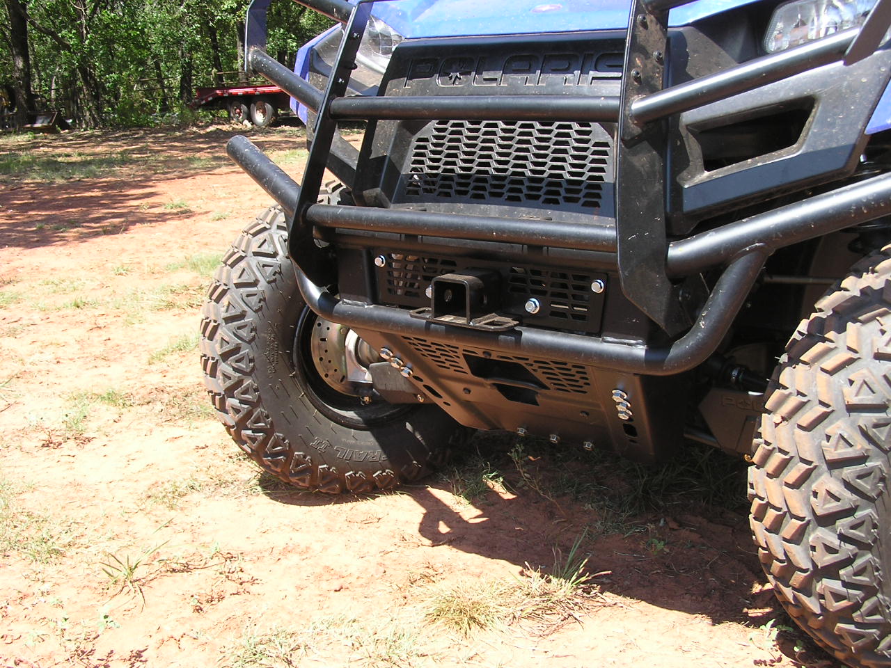

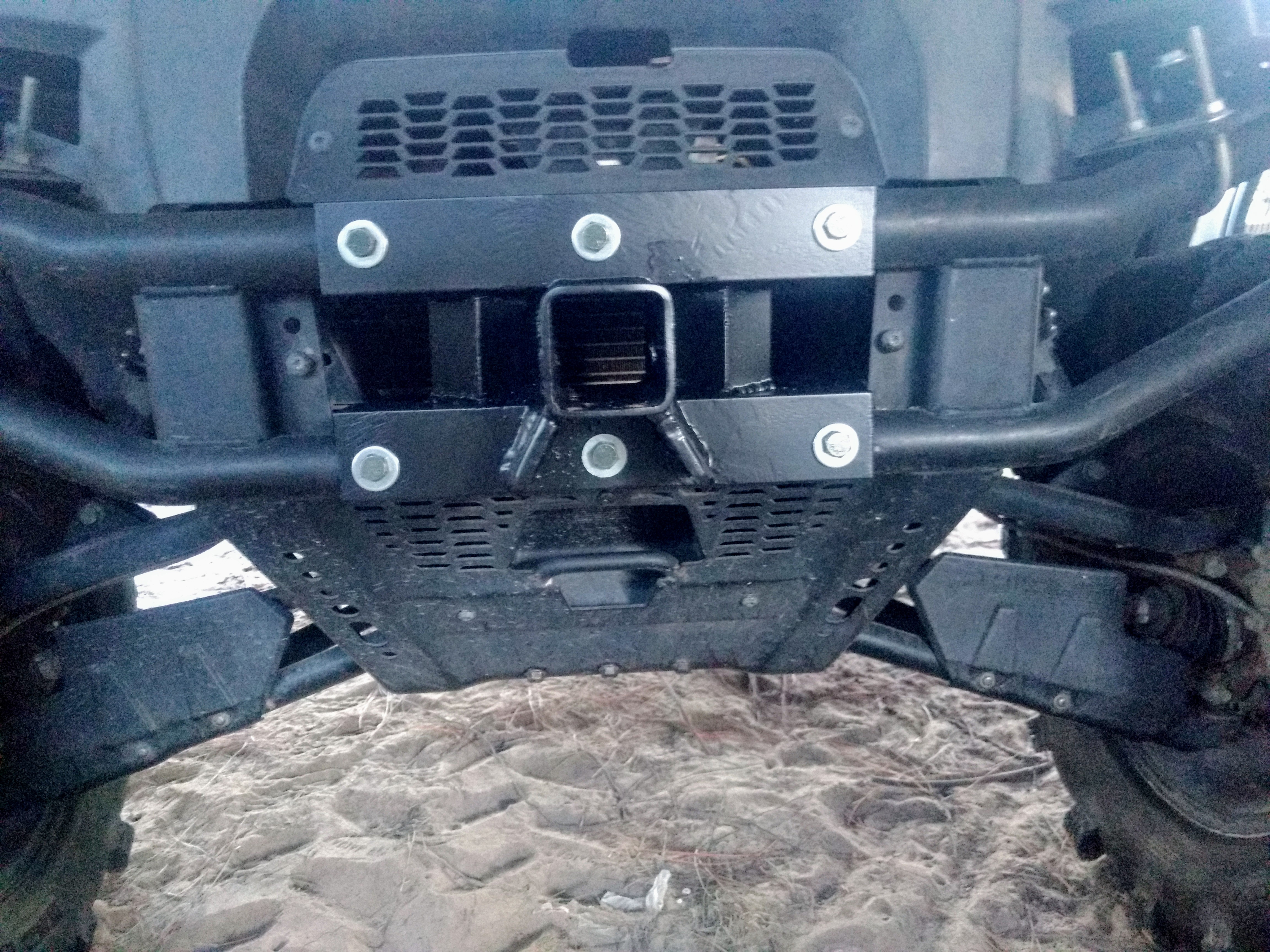

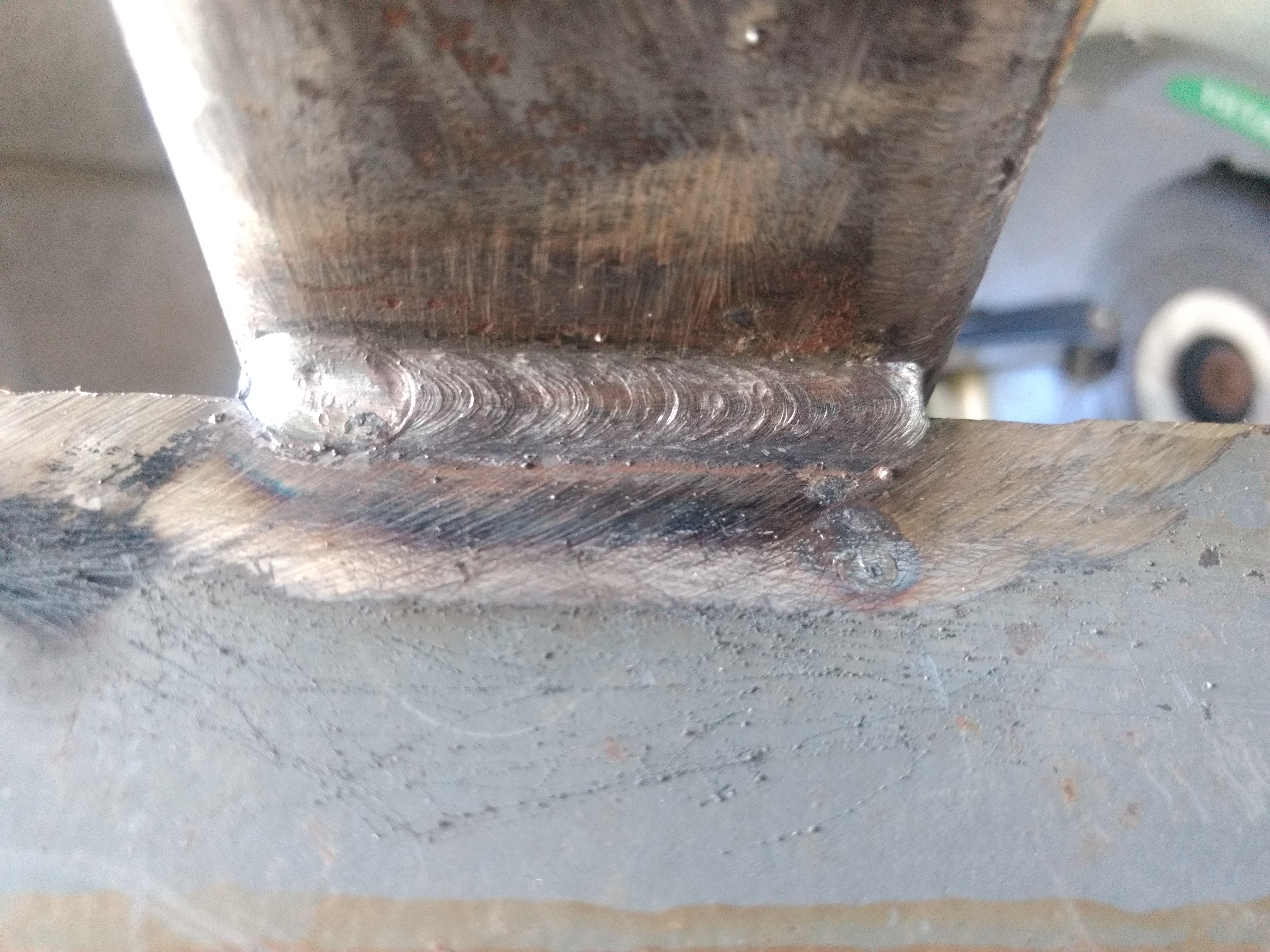

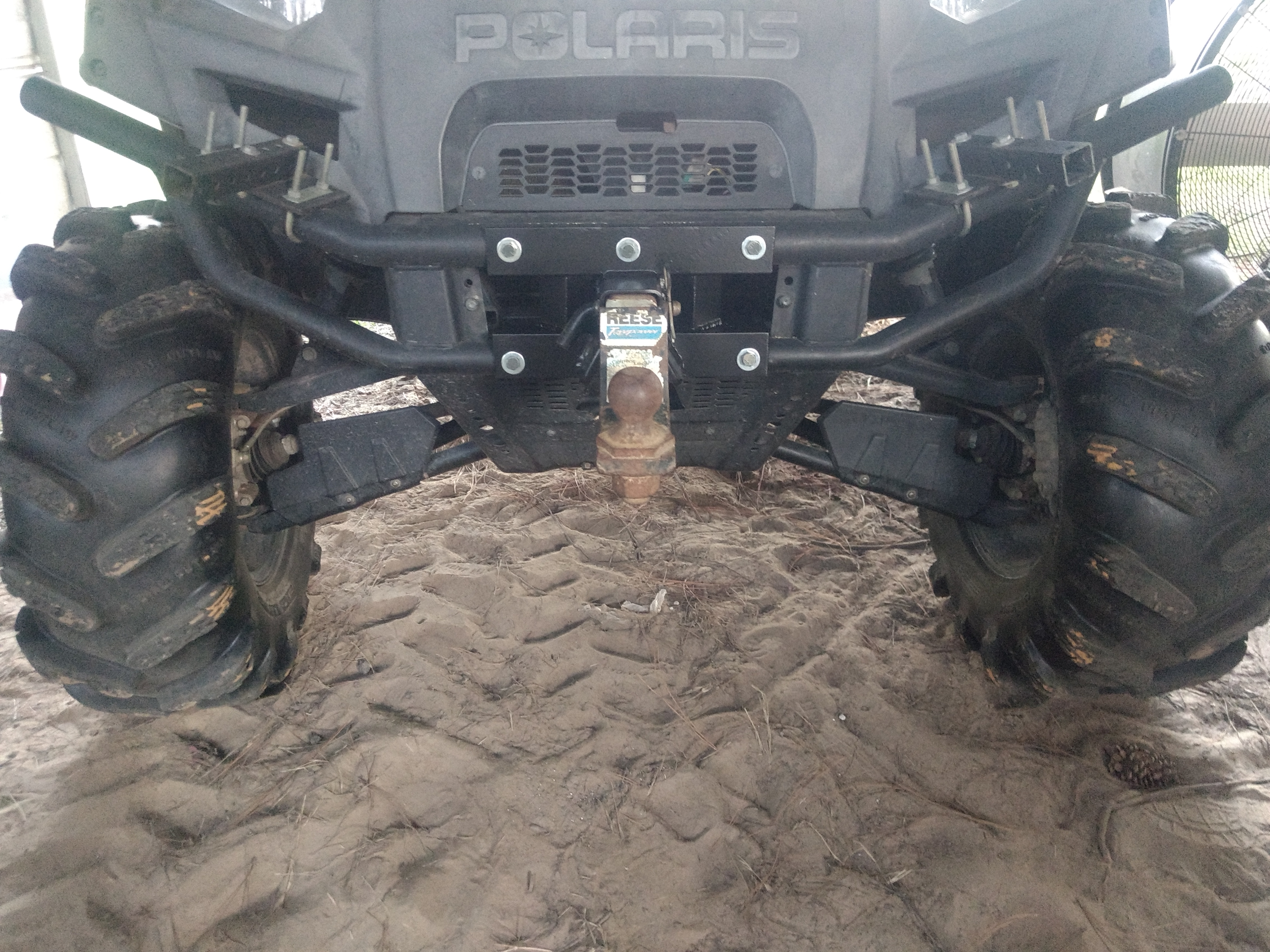

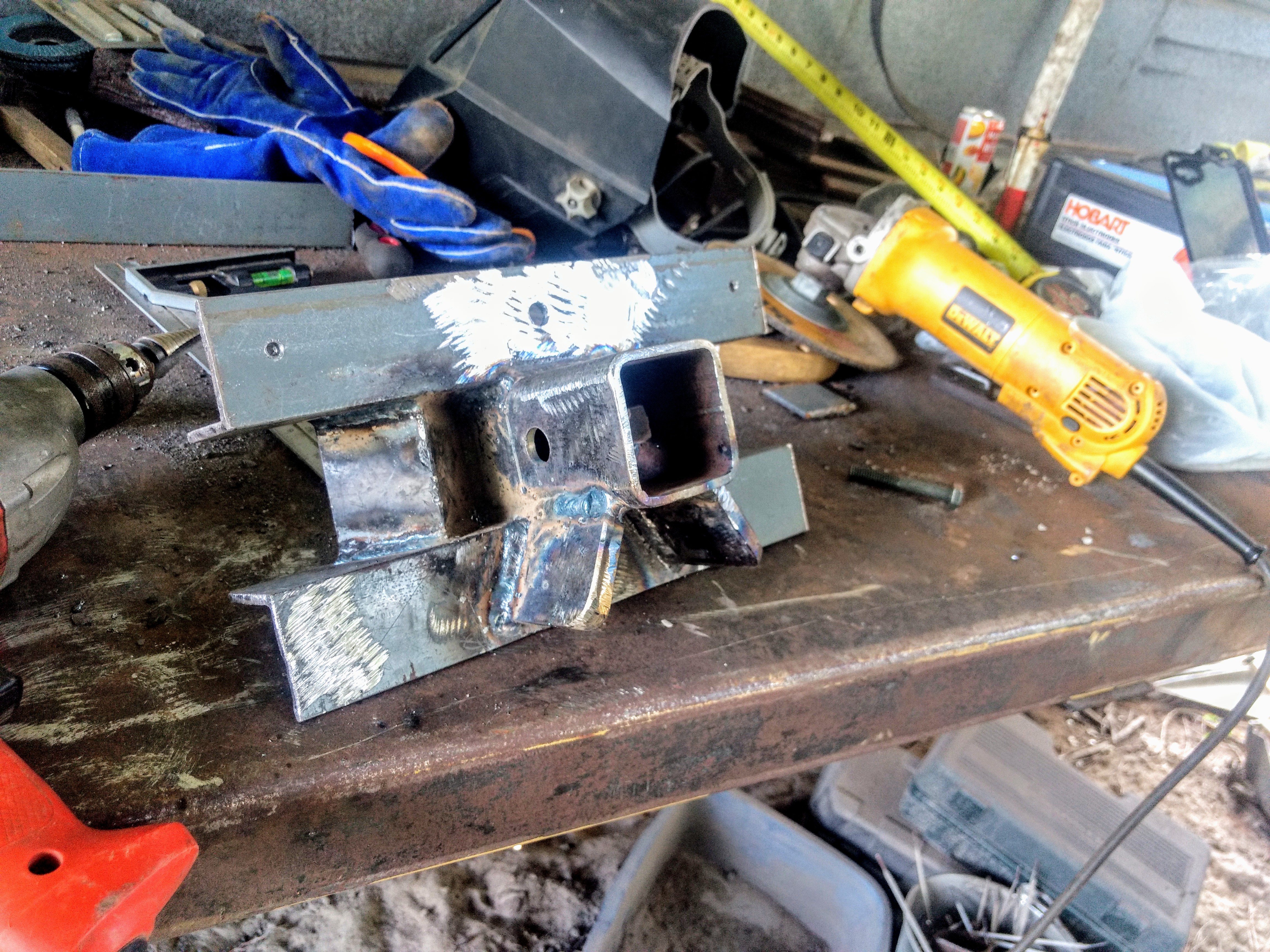

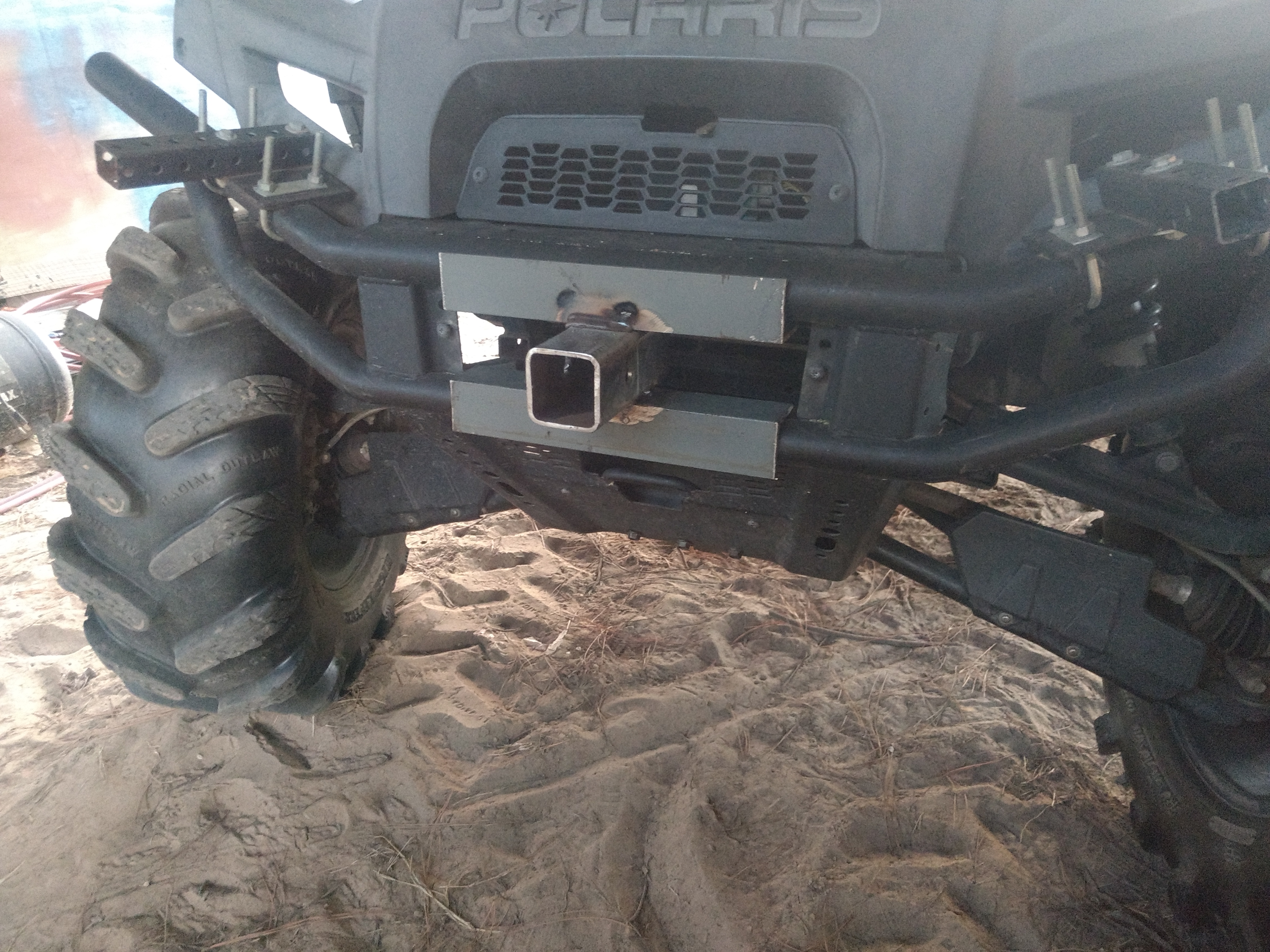

I built my own! Needed a front receiver hitch on my Polaris Ranger for a harness I'm building to run my dogs (next project). I looked at the hitches for sale, and all of them I found had mixed reviews. Biggest complaint was them bending, not good after you pay $100+ one. Wasn't the biggest project but I like it. I bolted it straight to the front bumper, this will be good for my portable cratle winch also.

Looks good like a front hitch should. :thumbsup:

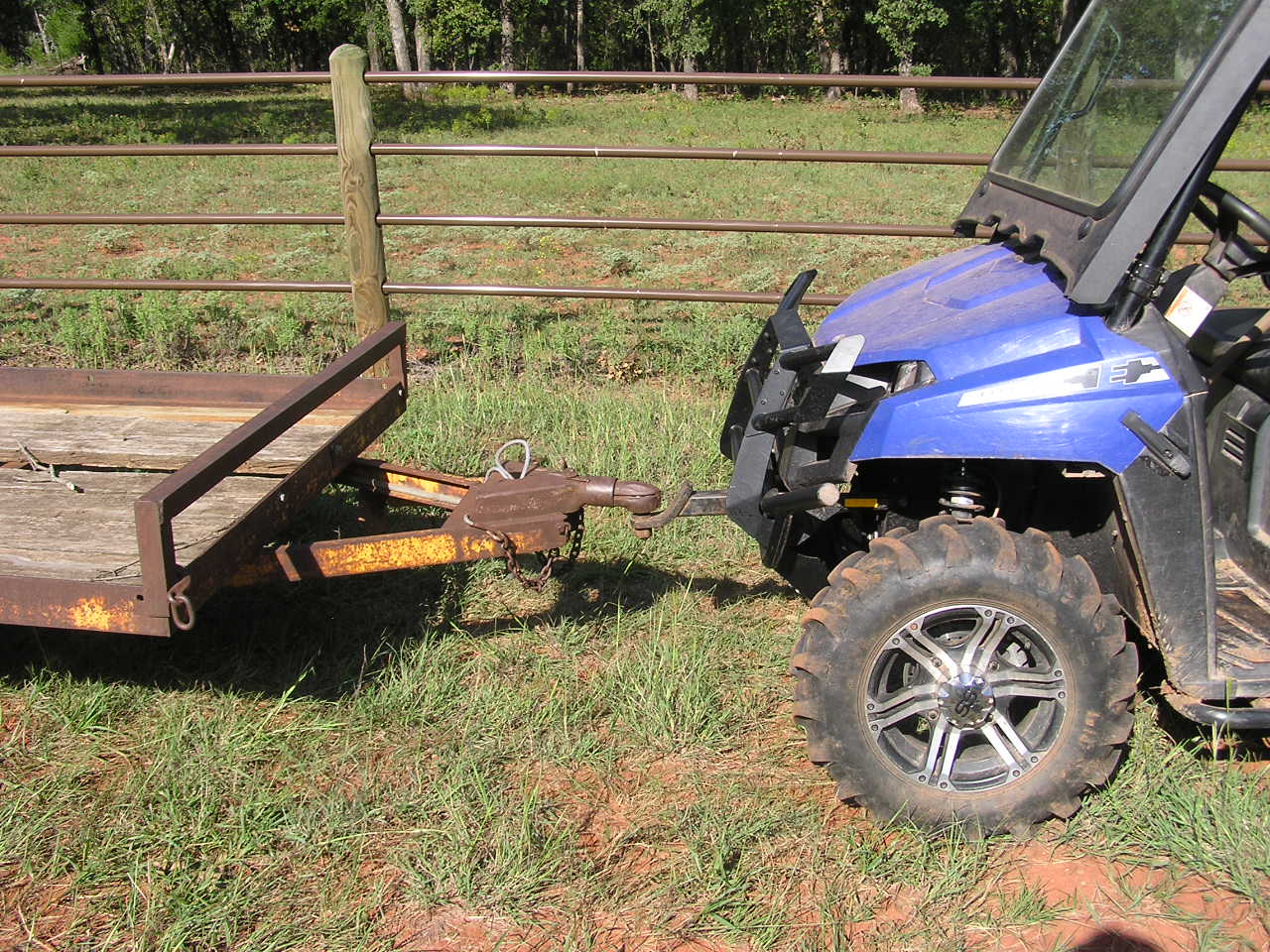

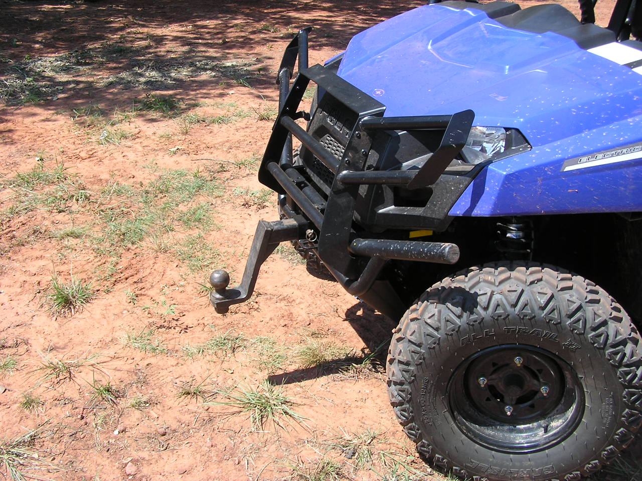

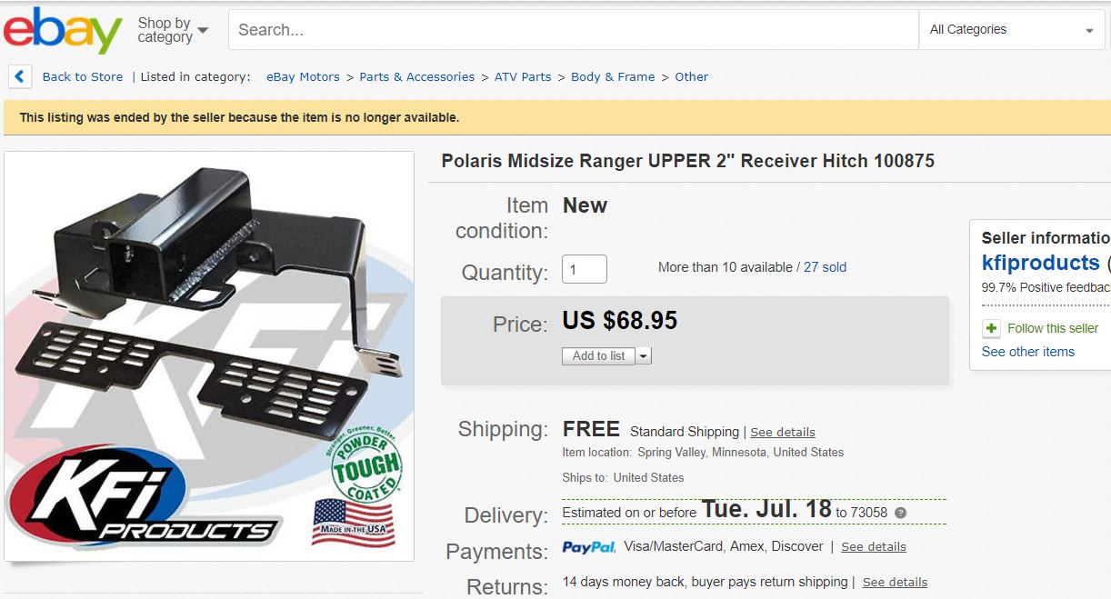

I got mine on eBay back in 2013. Very handy. It has been used a lot and is holding up well:

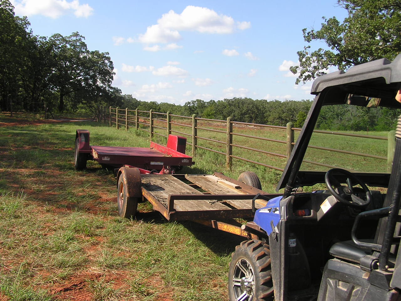

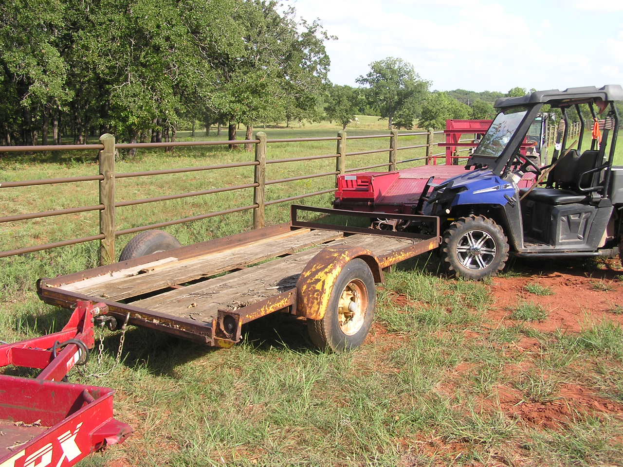

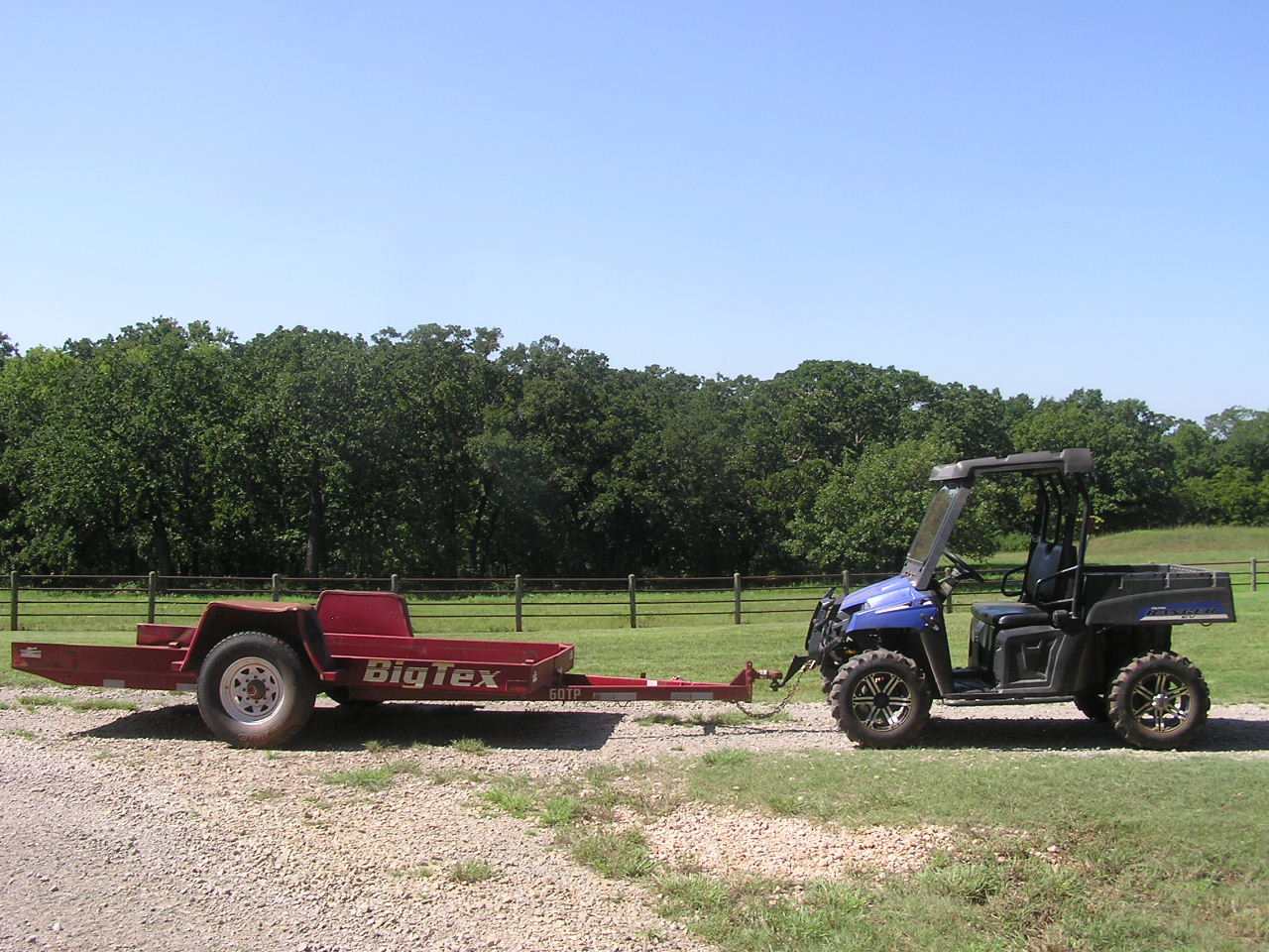

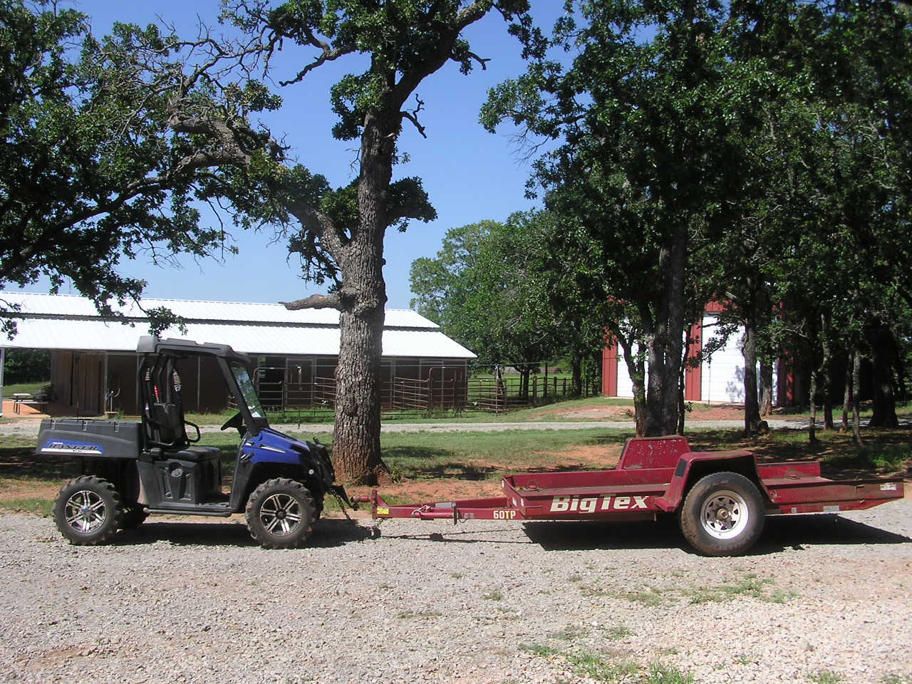

Mine has had heavy use, this 6K tilt trailer weighs 1786 pounds, with 96 pounds of tongue weight:
This one weighs 793 pounds, with 120 pounds of tongue weight:

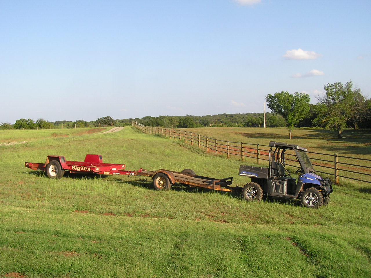

Pushing both:

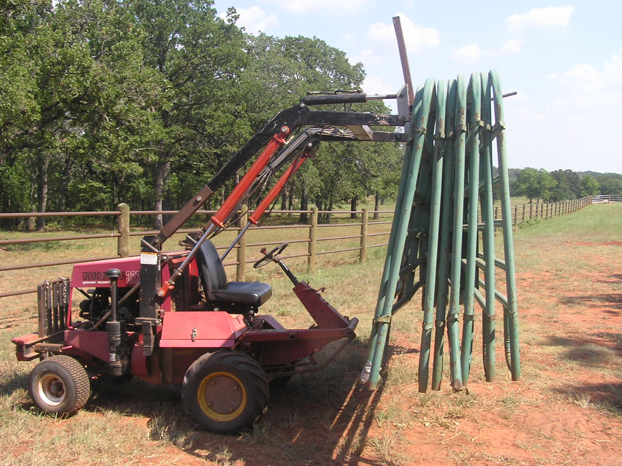

You're welcome. I wish that I had taken pictures of the tilt trailer when I was pushing it loaded with 700 pounds of these 16' long panels:

I can't imagine pushing two trailers. My head is hurting trying to understand how to steer! :stirthepot:
   / Wasn't happy with the hitches for sale, soo.... #8
It is easier than I thought it would be. :eek:
Easier than backing up a hay wagon with a tractor.
But they follow well on the back, going forward:
