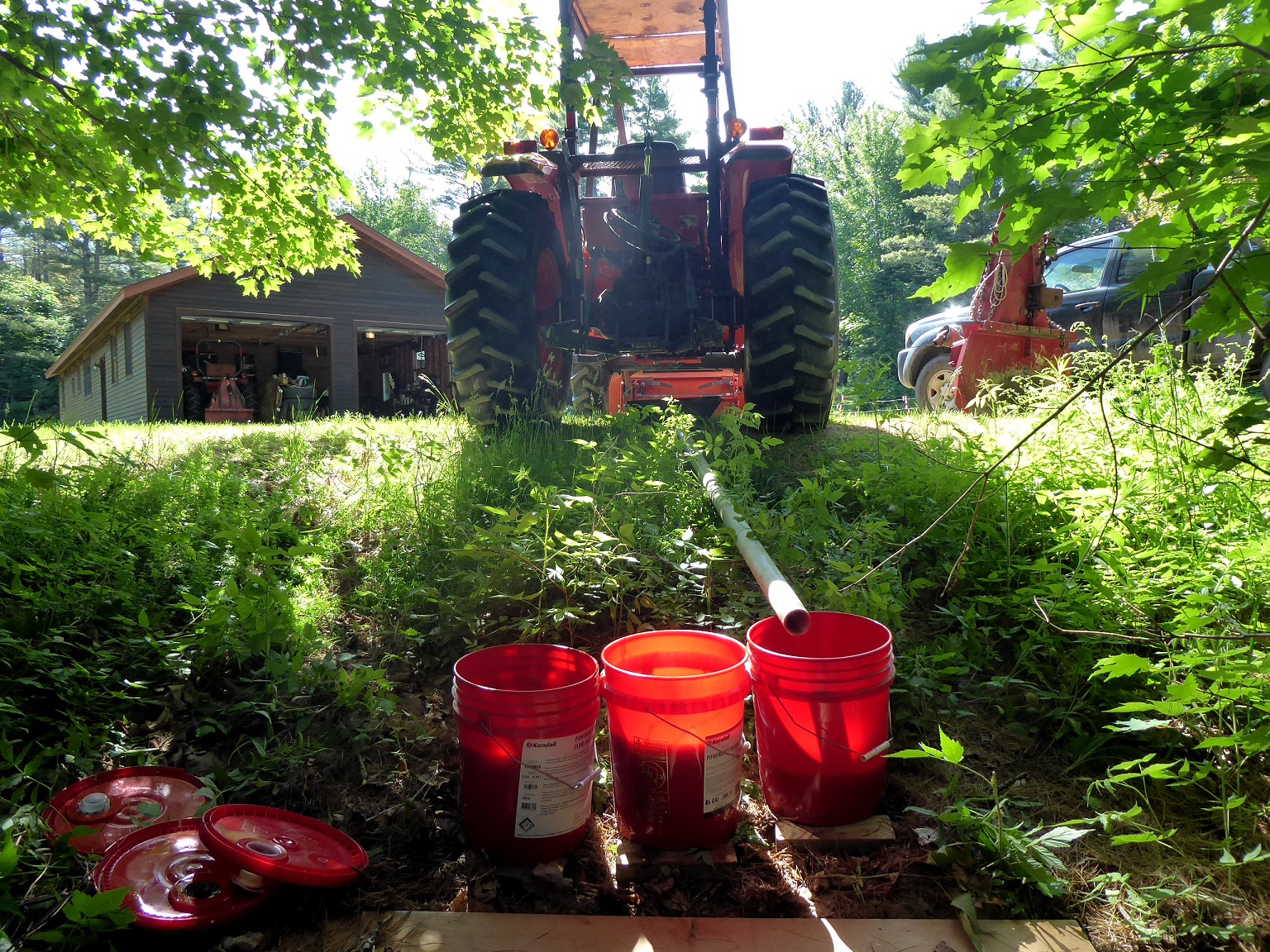

Have been on hold, before draining the 12 gallons of hydraulic fluid, thinking, how do we transfer it to the 5 gal buckets?
What does it get drained into? Thinking a plastic tote but not comfortable with 12 gallons in one flimsy tank.
Ideas?

27qt plastic tote, put the front end up on ramps so it slid under the tranny center drain plugs.
For the wheel hub plugs used a large green malwart spouted oil drain pan (about 2 gal because it holds the Cummins 12v draining's). Dropped and drained the 2 hydraulic filters into the same pan.
Used 2each empty 5 gallon oil buckets for the drained fluids, used the spouted drain pan to transfer waste oil into the 5 gal buckets.
Used the recommended amount of tranny fluid to the halfway point of the watch glass, so pretty sure I got all the old fluid out.
My flavorite local auto repair garage burns waste oil for heat, they supply empty buckets and take the filled buckets.
Bonus, the two empty buckets are clean and pretty for any more waste oil. The 2.5 gallon jug has quite a bit in it for topping off the tranny if a hose springs a leak.

I put three 5 gallon buckets or a drum down over the bank and have a drain pan I put a shower drain in. I run a piece of 2" pvc to the buckets or drum.
