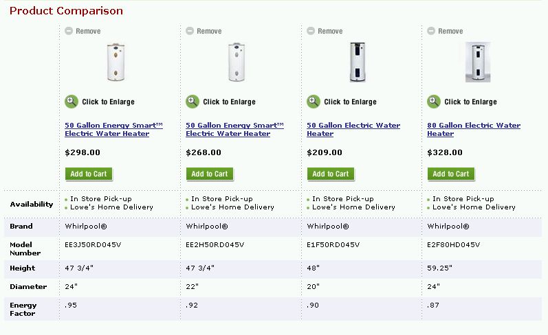

Eddie,
I've been looking at replacing my water heater and I like the models and prices at Lowe's. I attached a sample of their 50 gallon units as well as an 80. The main differences in the more expensive units are: <ul type="square"> [*]Longer warranty [*]More insulation [*]Better components (e.g. stainless steel vs. copper heating elements) [*] Fancy control box (this actually may be a good feature for your application) [/list] The more expensive units are more efficient mainly because of more insulation. Note the energy factors range from .87 to .95, and the higher the factor, the larger the diameter due to more insulation. By the way, I'm not sure any multi-year warranties would apply in a commercial setting.
