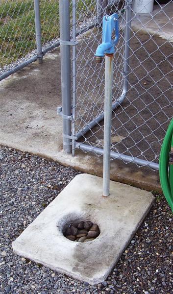

Installed 2 at my place, the bottom of both are surrounded by 6" by pea gravel with the base of the faucet sitting on a small flat block.
The one out next to the kennel I poured a above ground concrete pad to hold it. Simple 2X4 frame w/ some corner fill-ins. Used a small plastic bucket for the hole.
Used a similar concrete frame for the one next to the house, but it's 3" below grade covered by 1/2 round rock (large pea gravel).
