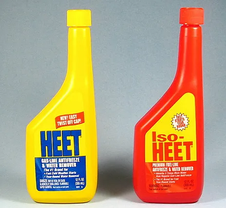

Lawn tractor, probably no fuel separator.
Water is heavier than gasoline, so it will settle to the bottom of the tank if left to sit overnight. If you're able to disconnect the fuel line from the bottom of the tank, you can drain the water out of the tank, blow the lines and carb clean, and it should be resolved. Change your fuel filter, and dump a little dry gas in the tank ($3/bottle), while you're at it.
