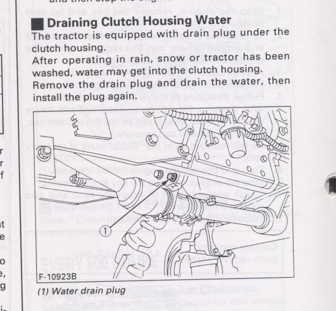

Does anyone have a picture of exactly where this bolt is? I have a B2410 w/ a FEL. I was looking today and think I may have found the bolt but am unsure. The bolt that I think it may be was brighter? (not the dull gray) color and was 12 mm. If anyone has a picture, please post it. I will try to post a picture of the bolt that I am talking about too.
Thanks,
Steve
   / Water in the clutch housing ? ....B7500hst #4
Steve-
Here's a scan from the operator's manual for my B7800.
   / Water in the clutch housing ? ....B7500hst #5
The scan said it all. " Cut and dry." No Pun intended..
   / Water in the clutch housing ? ....B7500hst #6
herringchoker,
Thanks for the scanned image. My operators manual has the same photo. My problem was, it didn't seem to obvious to me when I was laying on the ground looking around for the drain bolt as to which one it was. Like I mentioned previously, I saw one bolt that looked different from the others, almost as to say "Hey look at me you idiot!!". :)
Thank you,
Steve
   / Water in the clutch housing ? ....B7500hst #7
For what it's worth, I took the bolt out that I saw looked different but nothing came out (more importantly, nothing fell apart).
