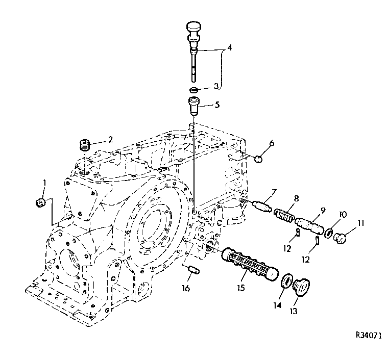

Check/clean sump screen(parts key 15) while you have hyd drained
