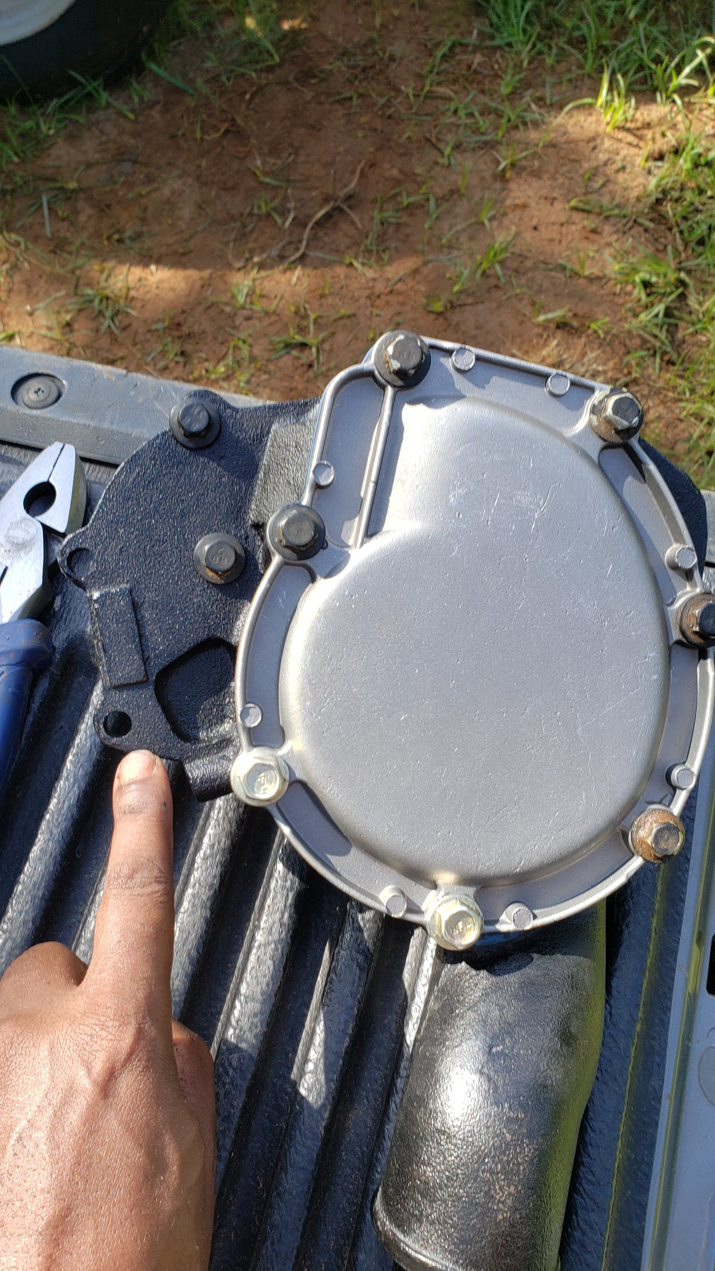

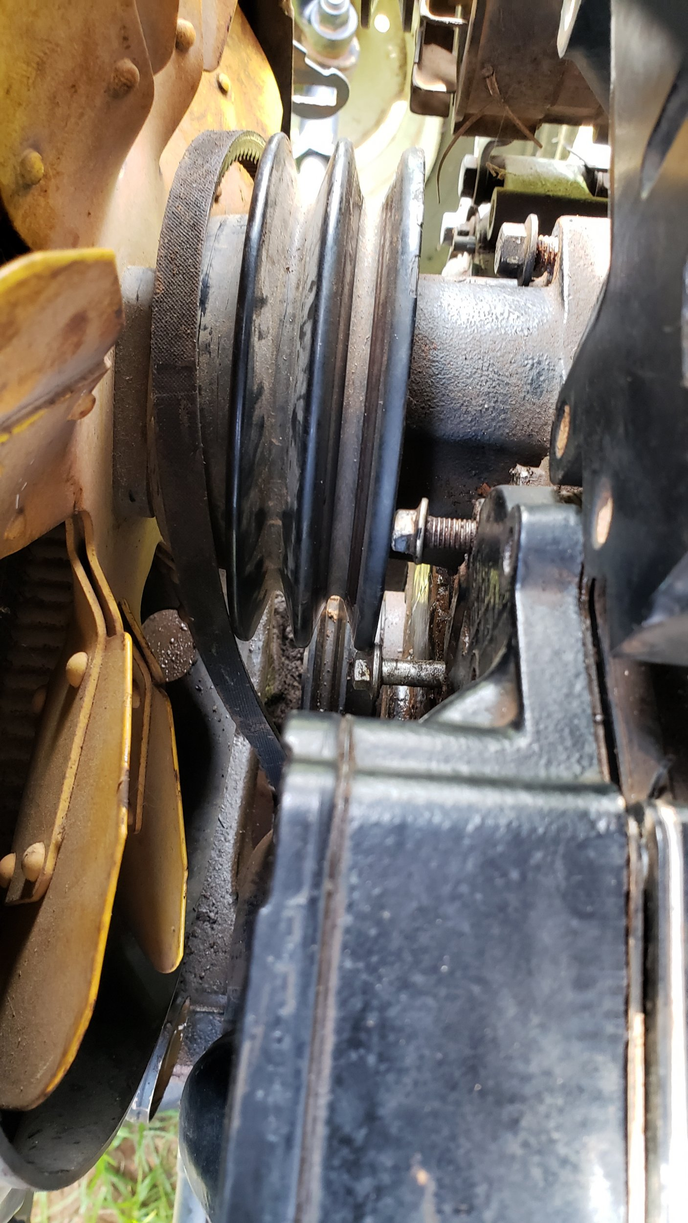

Did pretty much that but one bolt does not have enough clearance to clear the fan pulley. It was going so simple till ran into that problem. Help anyone?
   / Water pump removal and installation for massey furguson 431 #4
Does the new pump have the bolts already installed behind the pulley?
No it does not. There are like three bolts that sit aft of fan base...got the top one out no problem. The other is still inside the water but it shod slide right ou when everything is loose. The third bolt is the butt. Sits lower and just barely hitting the fan pulley but will not clear.
Would have been a 30 minute job if there were notches in the pulley so bolt could clear
Gear drive
Gear driven pump also...easy access except for that one bolt want clear. Its just catching. Tried to persuade it a little but no luck

Here is photo

You need to remove the fan first. The pulley may come off with the fan so you can get the bolts out.
Thanks everyone. I did remove the fan. I was able to remove the fan with the help of my uncle and tap the pulleys up just enough for the bolts to clear. Didnt have to remove the radiator doing it that way. Got it all button up and now have the dreaded gear whine. Does anyone have any suggestions on the gear whine of the pump. Possible bad pump or gears just don't. mesh well together?
