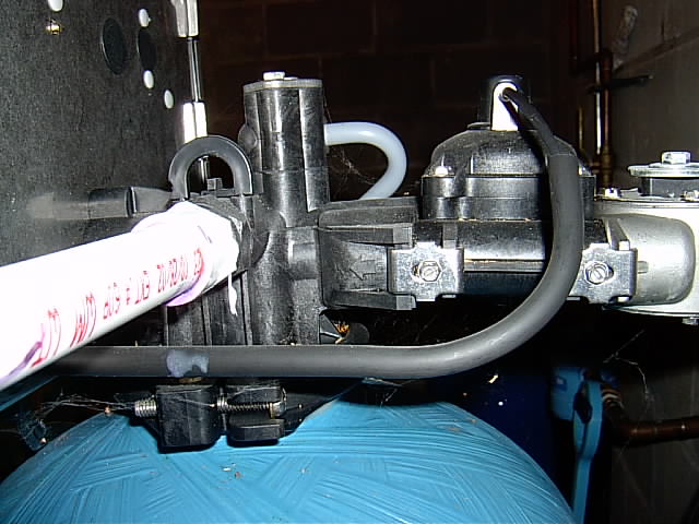

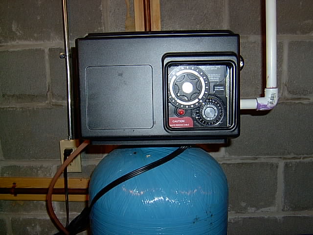

I was correct... It is a Fleck 2510. Now what do I do? :confused:
Here are some pictures of it...

   / Water Softener Repair? #9
Yes that's a mechanical metered softener version Fleck 2510 control valve with a SS bypass valve. It can be repaired or rebuilt. See the rust color in the brine line, that means the resin is probably loaded with rust. A dose of resin cleaner like a cup of Iron Out in a gallon or more warm water in a bucket poured into the brine tank (not throgh the salt, down the brine well) and a manual regeneration could help. Sticking the brine tank end of the brine line into the bucket while the control is on the brine draw/slow rinse position of a regeneration is best. Either way, it might not bring enough of the resin back to usable and you'd have to replace it. That isn't hard or expensive.
Somewhere on the side of the resin tank is a clear label with black type with a model number on it; like 1054. That is the diameter and height of the tank. With that I can tell you the volume of resin in the tank.
Well, I've apparently overlooked a simple fix. :eek:
After checking all of the obvious things such as power to the unit, the timer running, bypass valve, and blocked turbine, I didn't have the confidence to try anything further myself and I figured I was in over my head and called the repair guy.
I felt really stupid when he went right to the frozen drain line. In my defense, I've always had the drain line go to the outside of the house in 1/2 inch PVC and have never had a problem for 3 1/2 years. Why it's frozen now and not previous years is anyone's guess! The drain line is temporarily run to my septic system so I'll have decent water again, but I don't want to do that any longer than necessary.
Fortunately, it's a small sales and service company where the owner makes the service calls and wasn't very costly.
