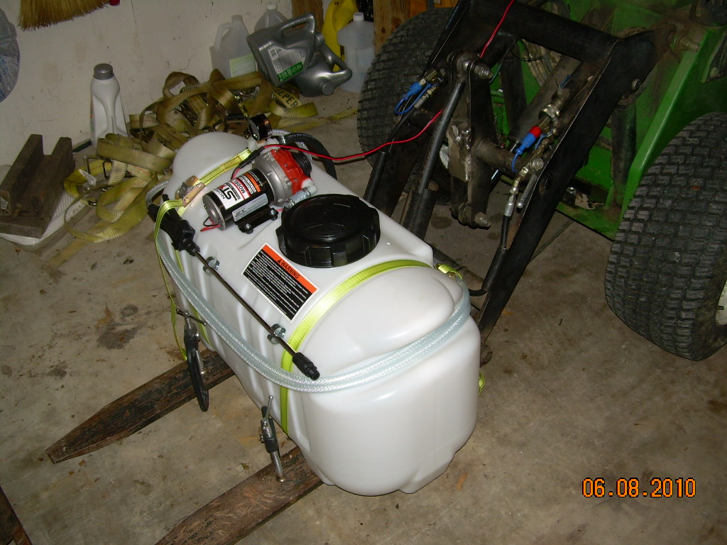

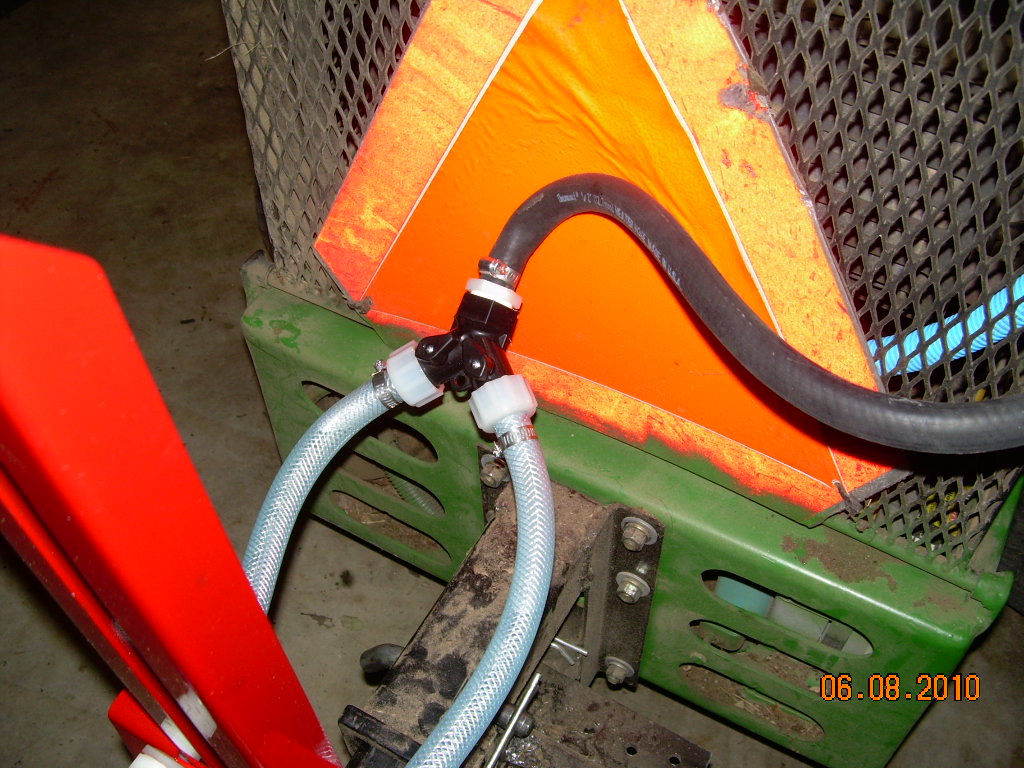

I have a tank with Pump from Northern. I use it to put down nematodes. It holds 26 gallons.
